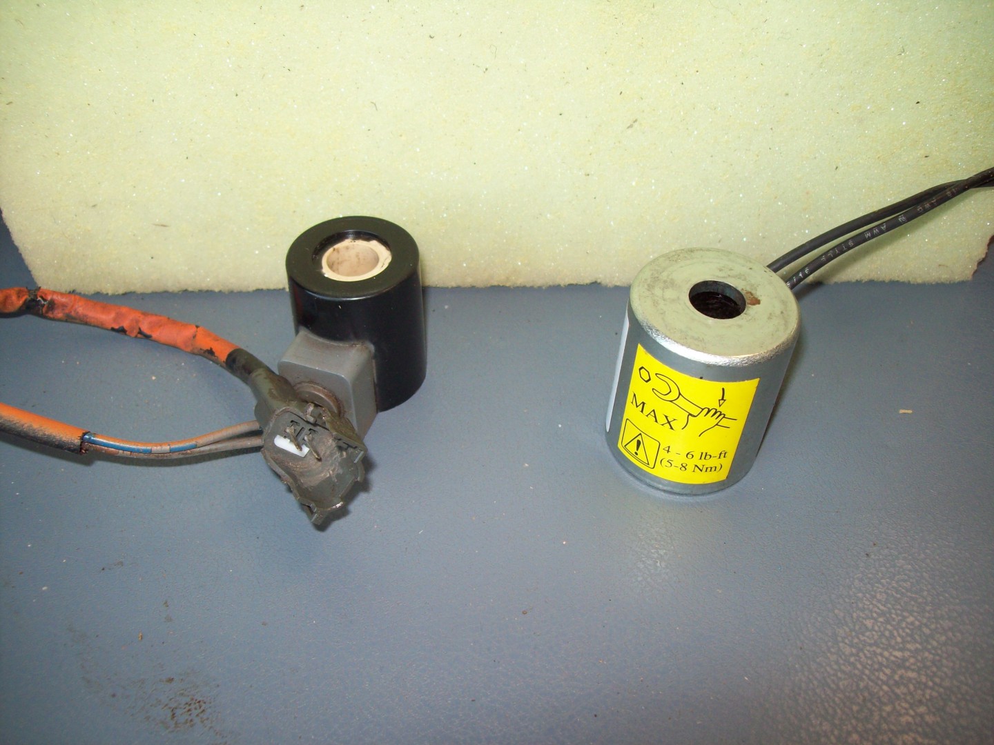

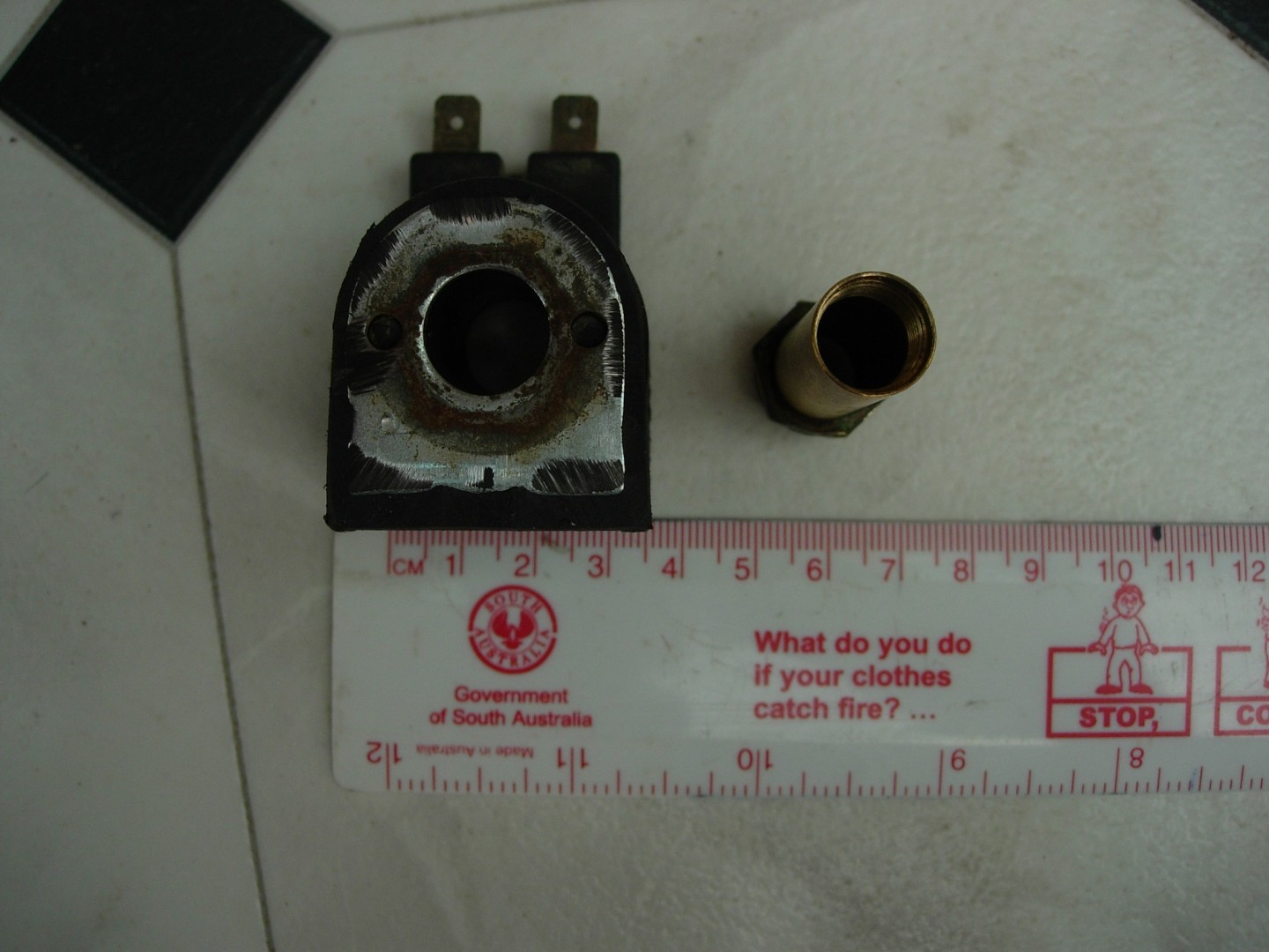

I have a Hitachi excavator that has a solenoid operated valve to make the digging equipment work when all safety switches are in the correct position.
It has a moving center pin that pushes on a spool that allows oil to flow to the controls..
The winding on the solenoid is burnt out and I need to replace it..
The OEM coil is $520 +GST + Freight..
Question 1. why do some coils make the armature pull in and others make it push out.
Question 2. what criteria would I need to know to use an after market coil apart from the inner bore of the coil.
The coil on the left in the photo is the faulty coil and the one on the right is one I have a loan of.
the new one pulls the armature in but I need one to push it out..
Any advice would be greatly appreciated..

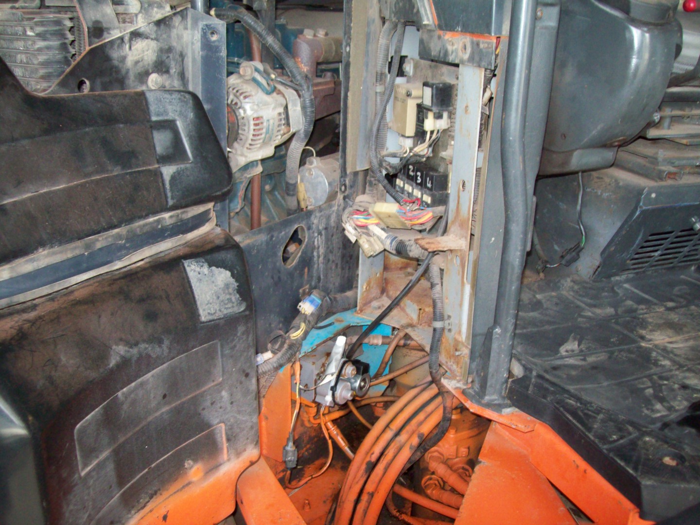

It has been a marathon job firstly finding the solenoid (buried in the guts of the machine) and then finding a way to bypass it while I try to find one to do the job..
I have put a longer pin (armature) in to hold the shuttle open permanently and all is good for me but I would like to reinstate the safety feature of it not working untill all safety switches are in their correct position..
You could try Reversing the polarity to the solenoid & see if it will push rather than pull. What are the dimensions of the hole in the solenoid & length?

The ID is 12mm the OD is 32mm and the length is 38mm..
I did try reversing the polarity without success....
I even tried turning it over but as the top ID is slightly smaller on the good coil it didn't really work very well....
I also have a feeling the new coil I have isn't strong enough but thats only a guess as it works the wrong way
-- Edited by oldbobsbus on Tuesday 3rd of June 2014 06:06:09 PM

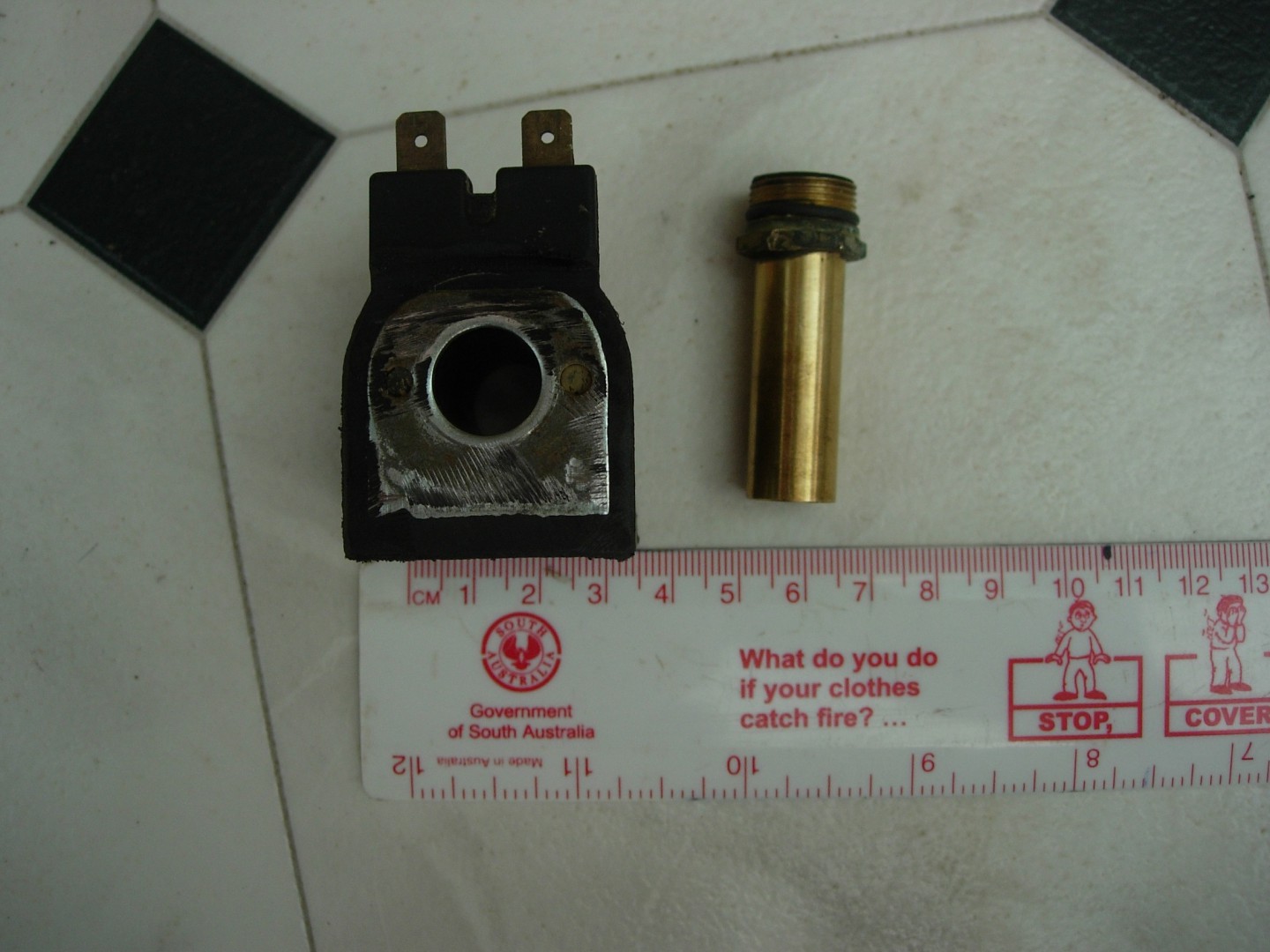

valiant81 said
07:40 PM Jun 3, 2014
Hi;
Have you tryed taking the coil wire assembly to a motor rewinder premisses. They could remove the old wire, check the wire size and replace the winding with new wire. It may cost a couple of $$, but would be a lot cheaper than a replacement. Most likely removing the old wire and winding on new wire would not be a problem, and would most likely done on a lathe.Some thing to think about.
-- Edited by valiant81 on Tuesday 3rd of June 2014 07:41:40 PM
oldbobsbus said
07:46 PM Jun 3, 2014
valiant81 wrote:
Hi;
We don't have a motor rewinder in Grafton we are only a country hick town but do have a MacDonalds and a KFC...lol
As you can see by the pic it is a fully sealed unit..

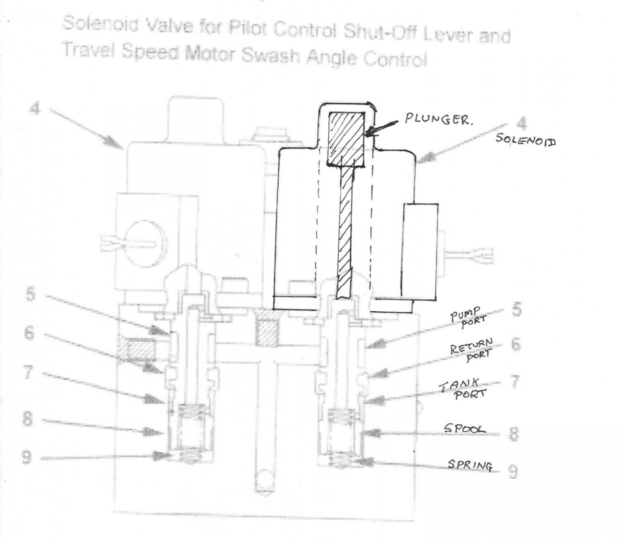

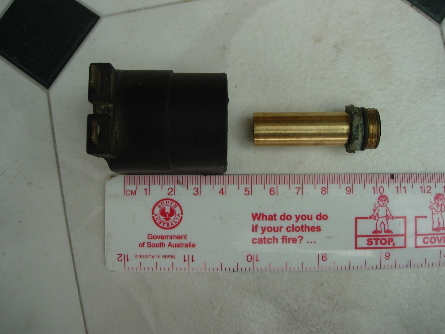

oldbobsbus said
07:39 AM Jun 4, 2014

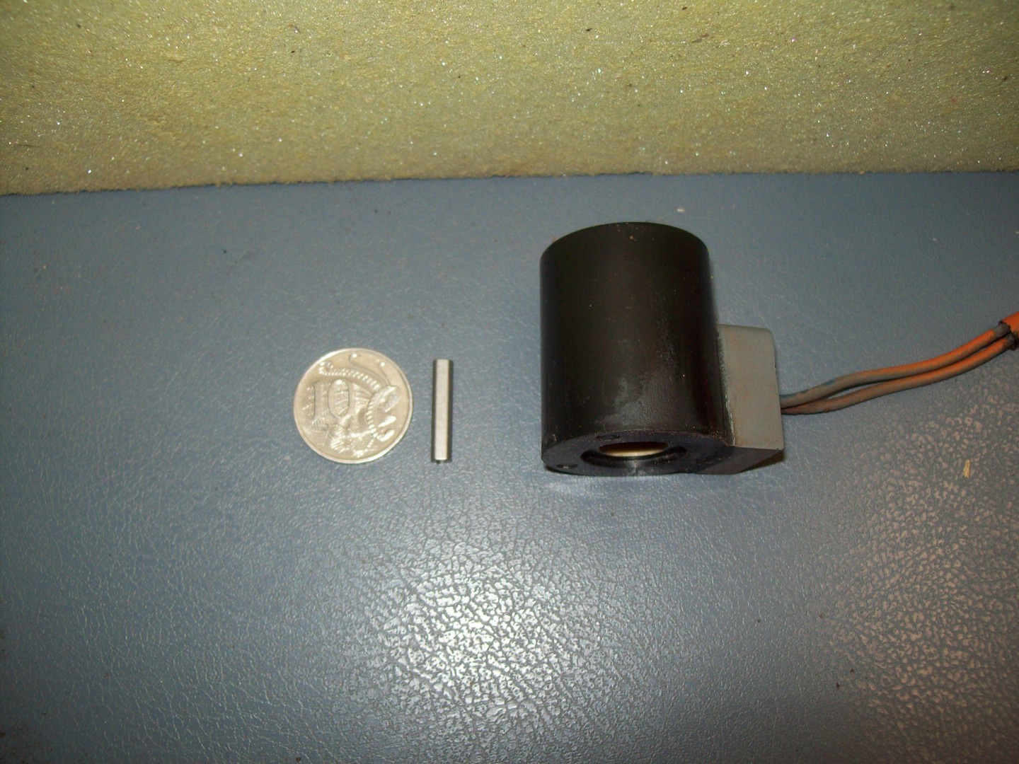

This is a page out of the service manual showing the solenoid and it's function...
Also a photo of the tiny pin that does the moving inside the tube (now back in place on the valve block with a longer pin in it) that the solenoid fits over..
This is only a guess Bob. For the solenoid to push a pin, the armature is probably similar as ive drawn it. If this is so then all you need to find is a solenoid of the same dimensions & it should work.
HI
Yes, DeBe
That illustrates a plunger that will pull DOWN into the coil & will not be polarity sensitive..
AS can be seen the actual plunger is above the windings & will just attempt to centralise itself within the COIL length
That is a special arrangement & most off the shelf solenoid will not be designed that way
Bob , from the pic you show, it seems the pin is much smaller thah the coil ID
, I think you will find the the actual plunger is still inside the coil .
AT the very top, would be it's normal open position
If you can get it out & it is the same clearance od with the new coil , it may work Ok
Actually any soft iron round steel could still work.[soften by heating to red hot, then slooooDwly cool]D
Depends on how much you want to experiment
PeterQ
Remembering that all selonoids work on the same principle, the plunger will be pulled into the centre of the coil, .that does not matter what polarity the source or if it is AC or DC
PeterQ
-- Edited by oldtrack123 on Wednesday 4th of June 2014 10:45:54 AM
-- Edited by oldtrack123 on Wednesday 4th of June 2014 11:03:39 AM
DeBe said
11:55 AM Jun 4, 2014
Also notice the borrowed coil is a closed frame, this will act differently to the original open coil.

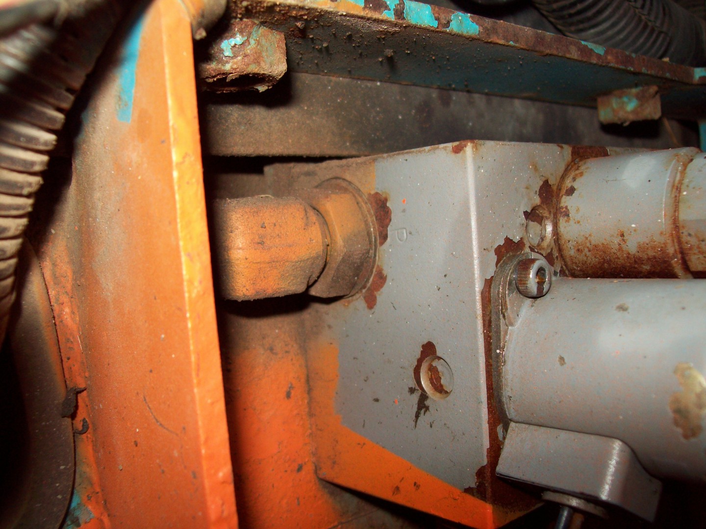

I now have a couple more pix if the valve block and where it is and have had a super close look but as far as I can see there are no identifying marks on it..
I have put the new solenoid over the tube that contains the actuating pin and it fits both ways so as soon as I can afford to stop the machine for a whole day (Fri or Sat) I will pull the temporary pin out of it and fit the original pin..
Here are the pix I took today..
I have send a request away to one of the companies in the links that Baz supplied and am still waiting for a reply..
-- Edited by oldbobsbus on Wednesday 4th of June 2014 05:22:11 PM
Bob, the mounting flange arrangement is rather unique.
I will see what I can find with that type of mounting.
Keep going with your enquiries as well and we will see what happens.
Peter K

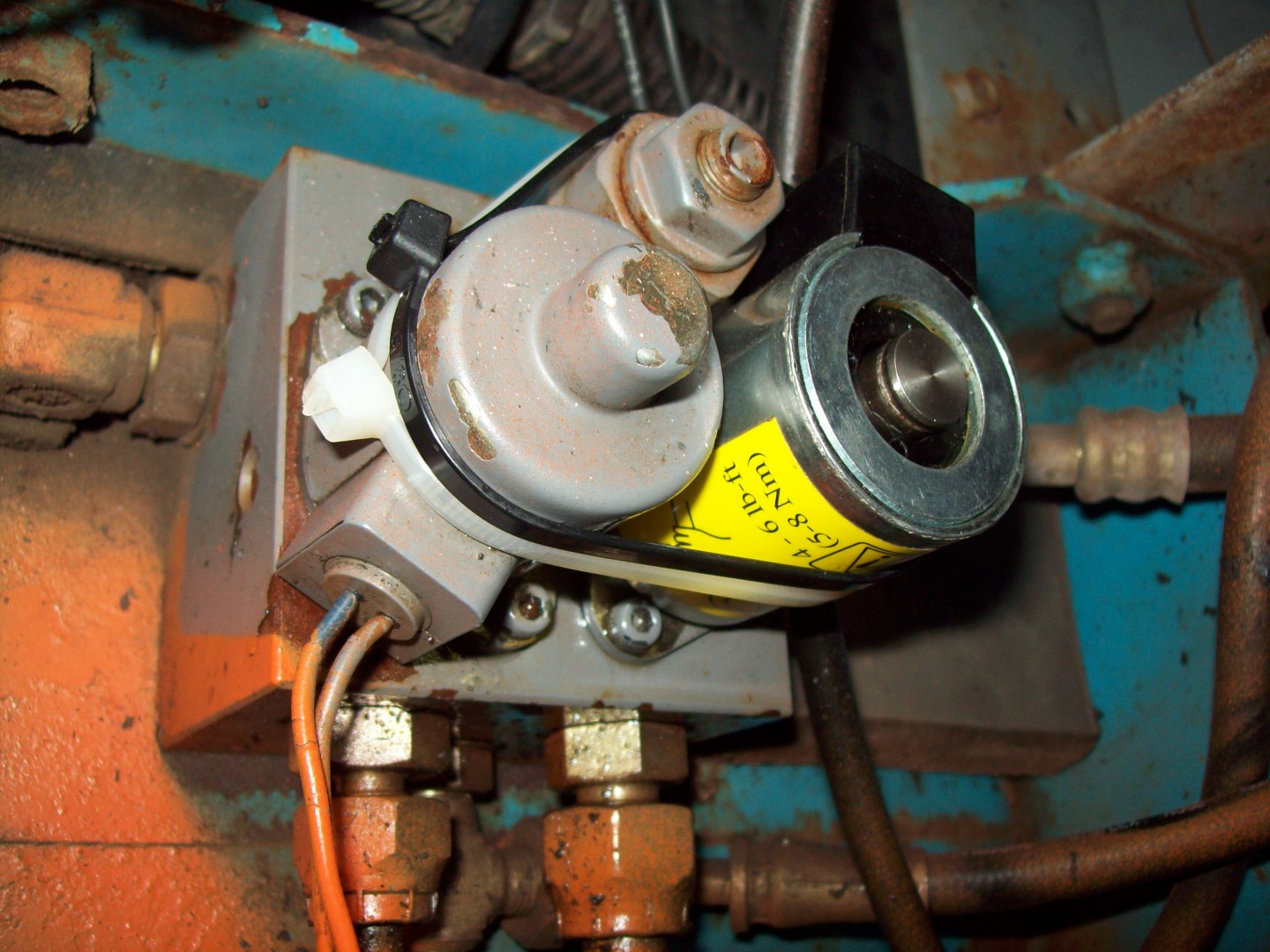

This is a long shot if you get desperate. Photo of a 12V , 12Watt Solenoid of a car LPG converter. Its 41mm long 35mm dia OD, 13.3mm hole in the middle. The brass sleeve could be machined to give 12mm inside diam. If you get desperate I could post it to you to try.

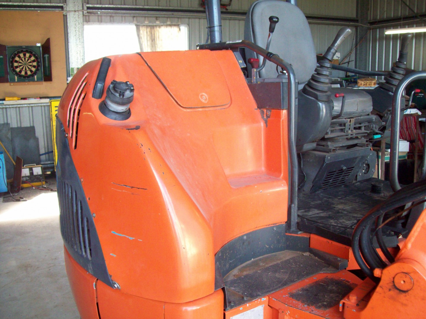

WoooooooHoooooooo, as it is a bit cold and overcast here today I decided to bring the machine into the workshop and have a go at fitting the new solenoid...
I put it on upside down and connected it up to the plug and WooooHoooo it worked perfectly first try so apart from giving it a days work to test the coils ability to stay stimulated for a prolonged time all is now good...
As you can see I have zip tied it in place and sealed the plug connection with silicone in such a manner as to be able to pull it apart later if need be without damaging the wires..

I will photocopy some of the pages out of the workshop manual that show the solenoid and it's function
and post them in the morning when I have access to a copier..
HI
Yes, DeBe
PeterQ
PeterQ
A couple of pix of the new unit in place and one showing where it is and also one with all the covers in place which is why it was sooo friggen hard to find in the first place..
Again a BIG THANK YOU to everyone that helped and as I said before if any of you are up here near Grafton feel free to drop in and have a yarn for a day or so as there is plenty of room here on the farm..
My phone number can be found on the Country Music website below if ya want to call and say G'Day anytime..
