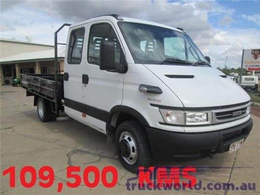

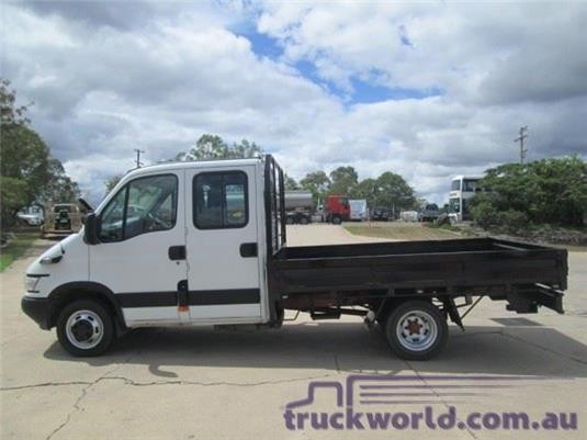

Ontos45 said
11:53 AM Jun 6, 2014
Matt and Mel wrote:
Thanks guys, still looking at my options. I've emailed T & L Engineering to see if they can make mod's to have a 4WD seat swivel out and down, i'm not a big fan of modifying away from the OEM spec's it usually introduces more problems... but anyway will wait & see what they come back with.
Regards,
Hi again Matt and Mel. Have attached a couple of pictures of light truck/van we were looking at. I believe it can be obtained in 4x4 too, configured as a ute, van, small bus. The height of door was our main reason for looking at something like this as Sue has had 2 knee replacements.
