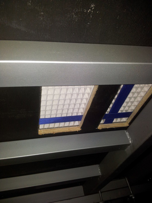

Air command have recently brought our an under bed model called a "Sandpiper". 2.2kw of cooling and 1.8 kw of heating.
It looks like someone has thrown a polystyrene esky under the bed. It has 3 outlets. An inside the van return air duct and undervan ducts as well.
It was the item the dealer "threw in" to seal the deal when we bought out 15ft poptop.
We've only done a couple of small trips but it seems to work very well. If I had a negative comment it would be that the lowest setting still pushes a lot of air, but I would rather have it over powered than struggling to do the job, and it's very quiet when you hit the off button
