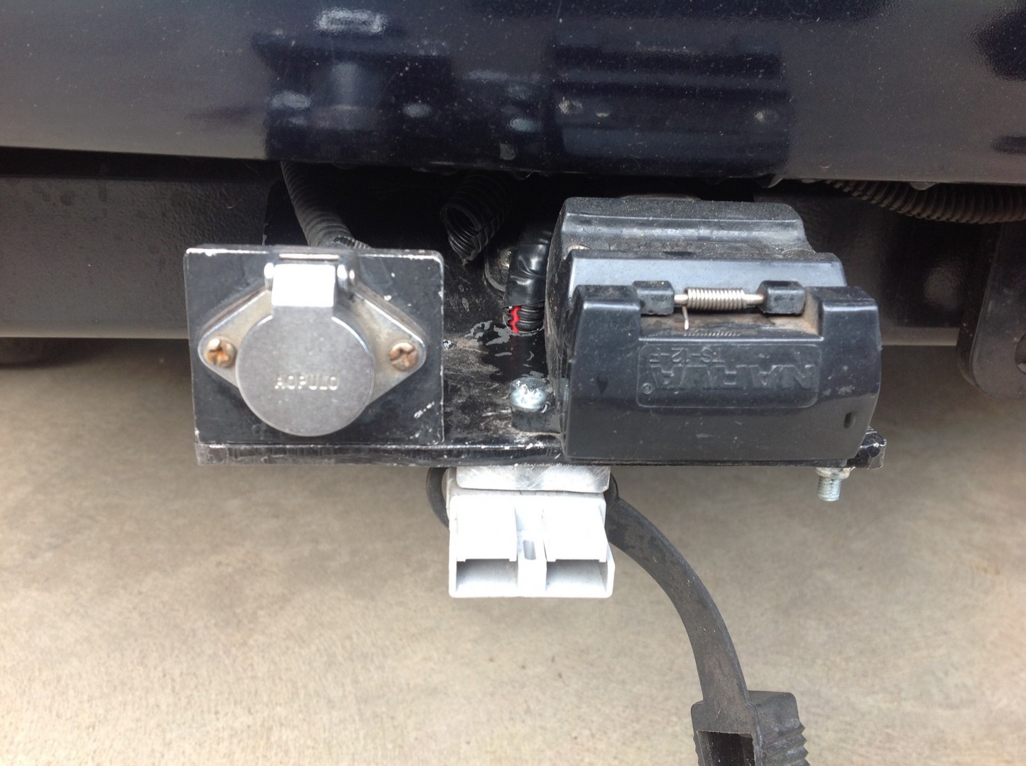

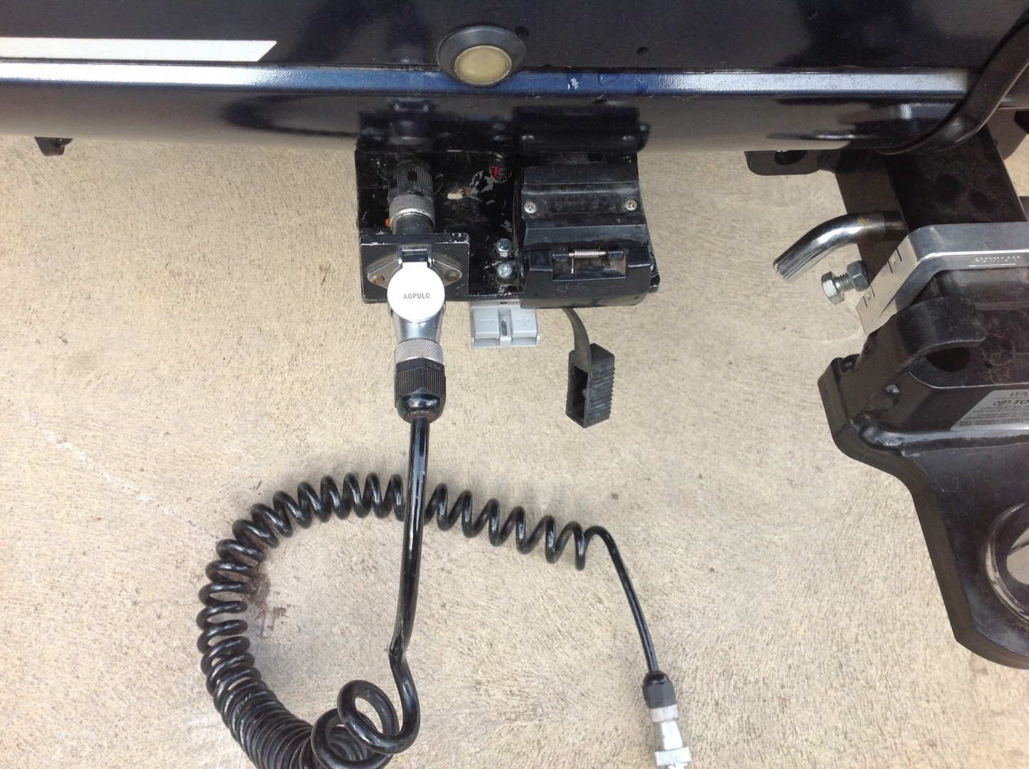

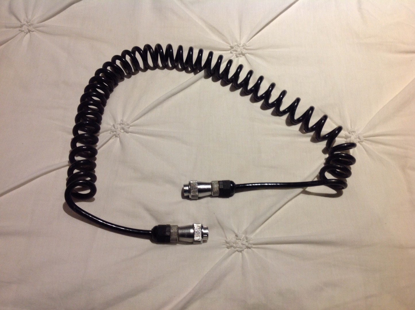

You can bye what they call a waza cable , it has bigger fittings than the standard camera lead,similar to a small trailer connector,check this pic out, you get two fittings that this cable connects to and your fittings fit into them as well.

any chance of a pic of the other bits? OR where can I see them online

Olley46 said
08:10 PM May 29, 2014
Hi Frank
I will take a pic tomorrow a bit dark here now.
Lance C

KFT said
02:24 PM May 30, 2014
Hi Lance,
many thanks for the pics, much appreciated
very neat looking install. think I will go that way too.
frank
Lance C
thanks
frank
Hi Frank
Lance C

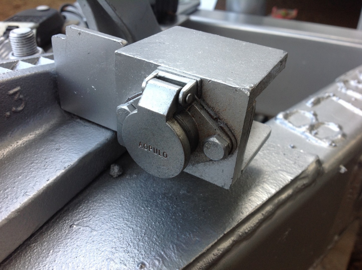

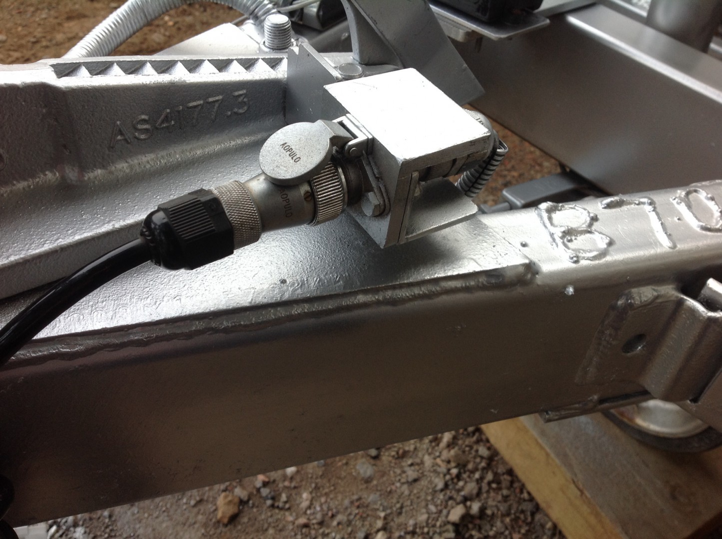

More picks Frank
The socket that the woza lead goes into has about one meter of lead,that is where your camera lead joins
Lance C
frank
