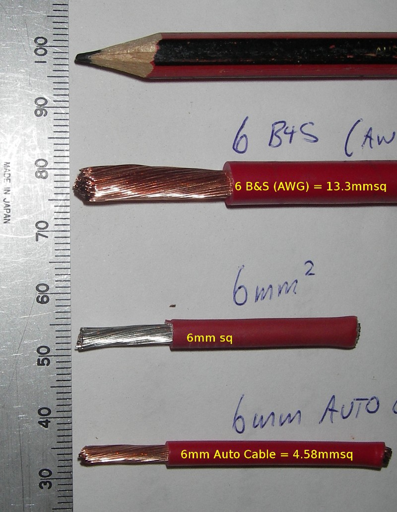

A 1500w inverter will draw about 130+amps at full load(12V), more at staring surge. Now that's a lot of current and needs proper wiring and placement for it to work correctly. Also needs a big battery bank that can supply a large current for some time, to run it. Otherwise you will not get a good outcome and it will be tripping out on the big loads.

HI Graham
Sadly, quoting cables in that manner means very little
Starter cable can be different sizes
6mm Auto cable means absolutely nothing, as it is in no way a guide to actual copper size
it is the outside dia[insulation included] not the copper core
The outside dia can /does vary from maker to maker.& even cable duty[due different insulation thickness]
And you can have cables that do not get hot but are inadequate for the job due to voltage drop.
PeterQ

04:46 PM May 26, 2014
HI Graham
PeterQ
6mm square is used in the elect industry.. It IS the actual size of the wire itself..

oldtrack123 said
08:15 PM May 26, 2014
Aus-Kiwi wrote:
HI Graham
PeterQ
-- Edited by Aus-Kiwi on Monday 26th of May 2014 04:48:35 PM
Hi
Well first off what size does it mean, Dia of copper, overall dia, or cross sectional area of the copper core???
BUt ,Yes, you are correct
The Ausralian Electrical industry[, Ie low voltage electric above 50V ac ] does use the ABBREVIATED term" 6mm," as you point out
BUT WE are referiing to a cable with a CROSS SECTIONAL AREA of 6 Sq millimeteres because we are talking in a common language
That is not the same as AUTO cables where the quoted "X" mm is the OVERALL DIAmeter, with no direct relationship to ACTUAL copper core dia, OR cross sectional area of copper !!!
One needs to understand this when looking at cables, or one could get a sad surprise when they find their 6mm AUTO cable overheats carrying 45A.
PeterQ
-- Edited by oldtrack123 on Monday 26th of May 2014 08:29:42 PM

Yes need to up spec on wiring rules.. I would say 240v is NOT automotive !!!

Aus-Kiwi wrote:
[1]6mm square is used in the elect industry.. It IS the actual size of the wire itself..
[2.. I would say 240v is NOT automotive !!![end quote]
Hi
t
[1] above indicates a very limited understanding of cable specs
&the fact that in the real electrical world 6mm is an understood abbreviation for 6 SQ MMcross sectional area
In the Auto motive world 6mm is the overal outside DIAMETER of the cable which does not have any indication to the actual COPPER cross sectional area
[2]
The voltage limits of electrical systems is clearly stated & is easy to understand
"Extra low voltage" is anything between 0V <120v ripple free DC & up to 50VAC, obviously that comes into the Automotive electrical field.
LOW voltage """"""above 120V ripple free DC up to 1500V ripple free DC or above 50VAC up to 1000V AC, covers the normal domestic, commercial ,& industrial fields
PeterQ
11:38 PM May 28, 2014
I said 6MM sq all along and you know what that means..
03_troopy said
07:48 AM May 31, 2014
6mm cable from an auto elec will most likely not be 6mmsq (maybe4.2mmsq, can't remember the actual equiv to 6mm auto wire off the top of my head). Even starter cable that looks like heavy duty (35mmsq) from the outside, can be a little misleading. We fitted a truck out this week that had compressor start cables already installed, with what at a first glance appeared to be 35mmsq cable, but on reading the specs written on the cable, it was only 25mm cable with a double layer of insulation. Similar to what we used to fit as welding leads on the smaller welders, in my previous job. And the dodgy buggers had used a hammer and a punch to crimp the lugs. This was how the compressor was supplied by the distributor too btw, so you can't even trust it to come brand new, done properly these days.

Na the trouble is there's so many different ways to measure wire size.. I work in the Electrical industry as a Lineworker, wiring up meters and consumer SMB boards..
Generally AWG is used in DC which stands for American Wire Gauge..
Our industry we use Nom CSA [cross section Area] in mmx2..
Theres also by the strand as in 6mm = 7/1,04 or 7/044 imperial..
We have to be on guard when joining overhead mains with compression crimps the wire is the appropriate size..
Its a minefield..

Sorry I have to..
Expected Life can be 10years.. I love it when dealers Quote stuff like this.... But leave out the most important thing of the Lot.. How many cycles and to what Depth of Discharge you take the batteries..
Not even Full River gives a yearly time frame of battery life.. They go for Cycle Life/DoD..
Plus an added Fact which was pointed out to me today.. Weight.

HI Graham

Hi
PeterQ
Its a minefield..
Firstly my apologies for going off topic on this thread. But as said, it was to illustrate the difference between the various methods of quoting cable sizes.
Just to give you an example:
