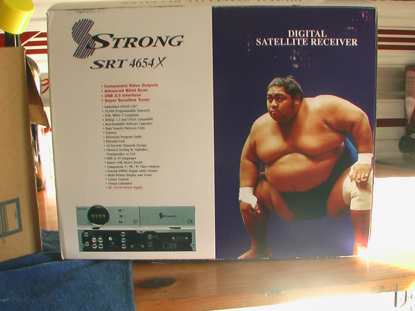

snap1946 said
01:20 PM May 17, 2014
hi wombat
yes it is on a tripod it has a strong box STR 4654X I don't think I can use it with digital free to air tv that is why I think I have to get a vast box and a new LNB
CHEERS SNAP
_wombat_ said
01:39 PM May 17, 2014
snap1946 wrote:
hi wombat yes it is on a tripod it has a strong box STR 4654X I don't think I can use it with digital free to air tv that is why I think I have to get a vast box and a new LNB CHEERS SNAP
How long have you had that unit?
have a look here and phone them before you buy anything, ask questions about your strong unit, they are great guys, I have done business with Philip in Vic, same company but nearer your home base.
There only 3 boxes approved for VAST reception and strong is not one of them.
Of the boxes currently approved the satking(aussie made) is proving to be popular
The Humax is a higher specification as it comes with a HDD and twin tuners but is more expensive.
I will second Wombats motion to have a look at Satplus, top people to deal with
frank

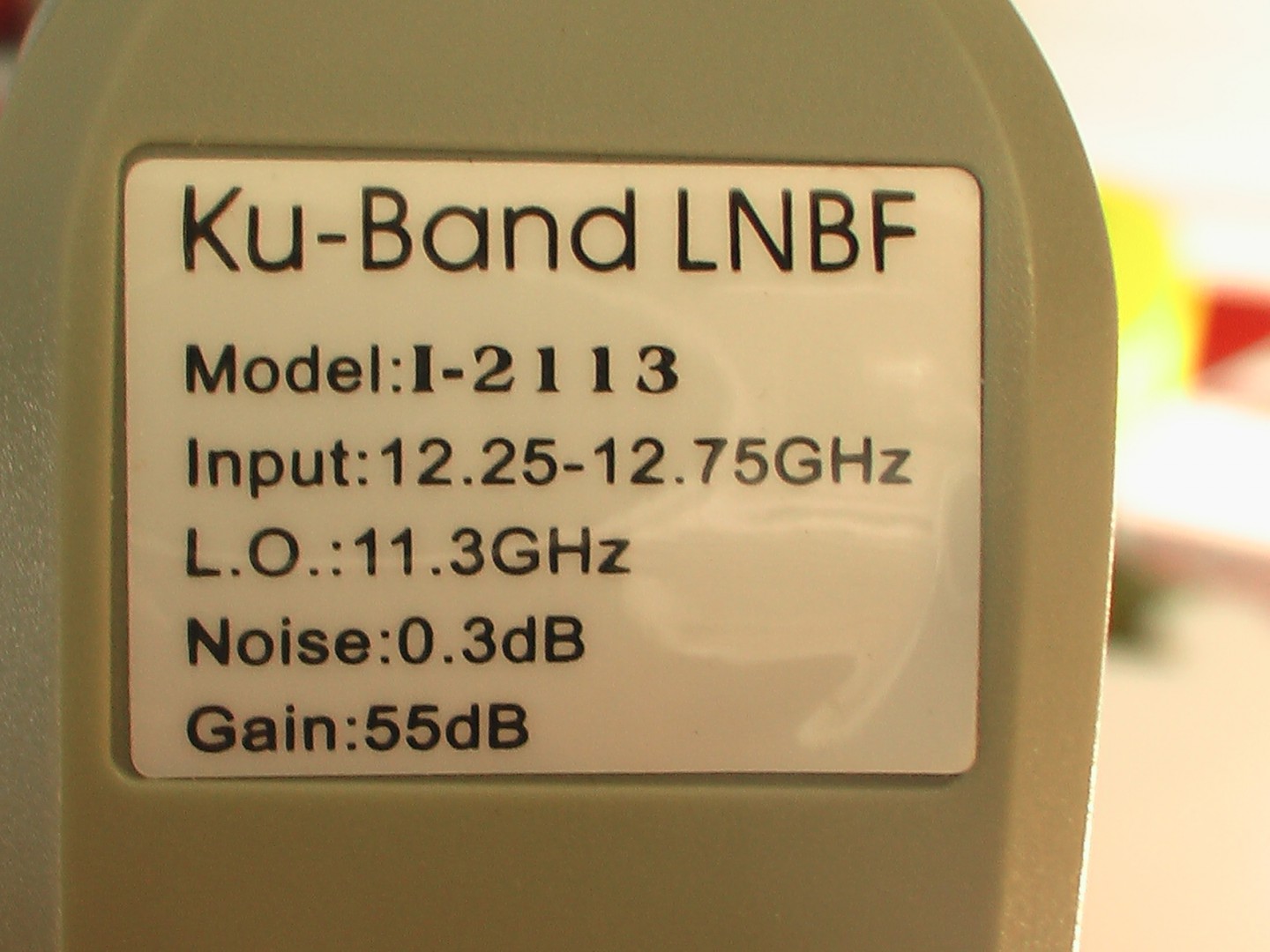

sorry mate but neither of those items will get you any free to air digital channels. BUT don't throw the box away you can still use it to search for channels on other satellites that can be received here in AUS. There is lots of entertainment out there if you want to go looking.
as wombat has said he uses a satlink finder. there are some good prices for the same meters here:sat-link.com.au/
you will definitely need a new LNB. one that is VAST certified and has an LO of 10700MHz.
hope that helps

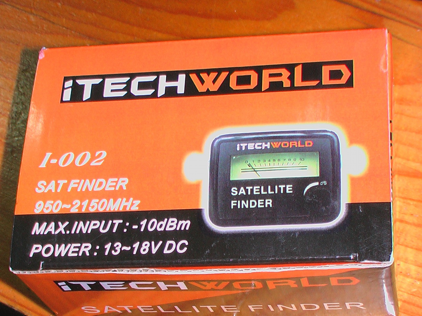

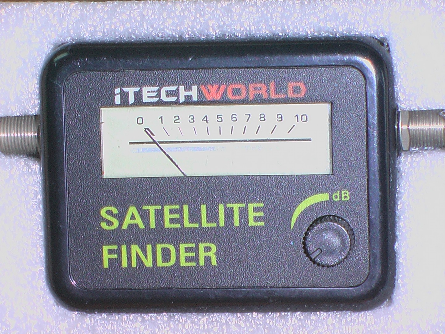

snap1946 said
07:07 PM May 17, 2014
hi frank
can I still use the disc it came with a compass sat finder leads 20 mt cable
KFT said
07:30 PM May 17, 2014
I would like to know what the satfinder you have actually is. there are generally 2 types and analogue that has a needle to indicate sig strength or a digital like the SF3239 on Satplus site.
the dish if it is 65cm will be ok for the east coast but if you want signal all over aus you will need a 85cm which is easier to aim and suffers less rain fade
the cables and compass should be fine.
The ws 6933 you see on the satlink site is the new model. some retailers are still selling stock of the old model. it is still a reasonably good meter.
frank
-- Edited by KFT on Saturday 17th of May 2014 07:32:16 PM

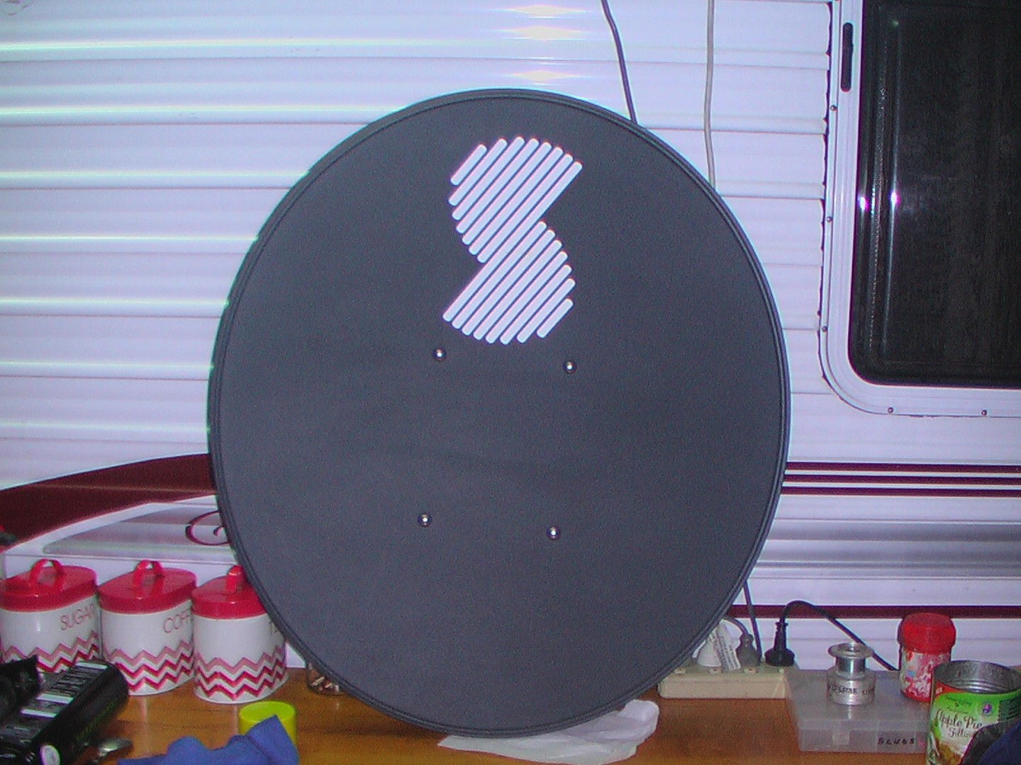

snap1946 said
07:56 PM May 17, 2014
hi frank this the sat finder and disc it is 760x680 mm
frank I only travel along the east coast now days tyring to keep it simple
snap
KFT said
08:36 PM May 17, 2014
G'day Snap
that dish will be fine but I would relegate that satfinder to "emergency spare" and get yourself a digital model that will only respond to the satellite you are looking for. Those old analogue units would indicate on any satellite so you would not know what you were aimed at.
