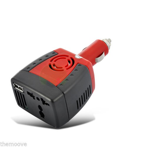

Barina, your device is in fact an inverter, but it would have a very low power rating compared to those that are being discussed by others. I suspect it would be suitable for powering a shaver or a battery charger, or maybe a laptop, but not much more.

oldtrack123 said
09:26 PM May 18, 2014
HI Judy
Iif that is the oneyou have ,it is probably around 70W output . O
& most likely a modified sine wave unit ,cheap & nasty.
It would be ok for Charging mobile phones ,laptops, cameras etc. but that is abo t all, using the supplied 240v chargers for charging purpose.

oldtrack123 said
11:39 AM May 19, 2014
Murrman wrote:. But please don't plug in the Microwave to it as the battery will be flat in 10 min.
Hi
If the pic that the OP posted is the one they have , there is no need to worry about the battery
The "Inverter" or the socket wiring will be smoking long before the battery is flatl
But I would expect the unit does have an internal 10A fuse
