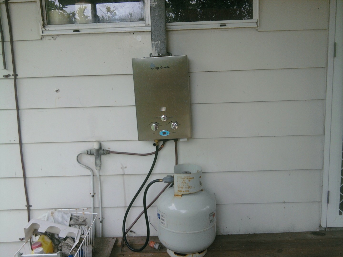

bill12 said
06:11 AM May 15, 2014
So you are saying that its legal to have the system outside and connected to a gas bottle? What's wrong with that.I have one , and its worked great for about 12 months. Bill

PeterQ, Without having the full info available or the specs of the unit or the unit to look at it would make it difficult for anyone without experience to understand the problem with it...
I think when making threads like this you need to have the full facts available and provide them to everyone so they can understand the reason for the appliance not meeting the standard. Otherwise it could be said you are scaremongering and worrying everyone with an instantaneous gas HWS. You and I know that most of this type of HWS DO comply with the standard..
Bill, are you sure your unit is one of this particular brand or just one similar that may well comply with all the requirements of the Aust Standard.
bill12 said
07:57 AM May 15, 2014
It looks the same.The one I have is a Rio Grand, and says it passes Aust Standards. Piezo Ignition,and Just attatch a gas bottle and water , andit turns on as you turn the tap, and you have hot water, which you can set the temp. No pilot light.I find it works well. Bill

native pepper said
12:06 PM May 15, 2014
G'day Bill, read this thread last night, so asked our local gas fitter about it and sent him a link to the thread, as our house hot water heater has this standard. After he had a good laugh at the misrepresentation of the standard (his words), he explained the difference this morning.
Simply put for all to understand, AS2658 2008 is designed to cover gas heating systems which don't have a dedicated flue and are classed as portable outdoor appliances, they are as safe as any gas heater used outside under the right conditions. Theoretically you could install one of these on the outside of any van or MH in a box you can open to the air when in use and stopped, according to the gas fitter.
Ours is outside the house in a metal box, open bottom and heavily vented top, the gas is connected directly to our LPG and methane storage tanks, using a standard regulator.
So if you have one of these inside with a flue, it's fine but flue less one must be outside, and are considered portable. We also carry one of those portable Companion gas hot water heaters in our bus for emergencies, yet to use it and doubt ever will. We use an electric 12/240v hot water heater, bus heat exchanger and solar bags on the road. Currently have a project going which if it can be refined, will give us solar hot water when travelling and folds away.

bill12 said
12:27 PM May 15, 2014
The water goes to the system and then to a mixer for the shower and sink.The flue goes up to the tin roof on the vetandah, Just add gas, and you have hot water on demand. Very simple, and safe.I think it cost $320 delivered. Bill
Bill I can only assume that you did this installation yourself.. Because I would hope that NO licenced LP Gasfitter would do such illegal work..
I just hope you never need to make an insurance claim because as you know insurance companies look for any excuse to reject a claim and if they saw that you would miss out sadly.
You would need to get a LPGasfitter to redo the job properly and issue a compliance certificate for it and attach a compliance plate to it..

bill12 said
01:12 PM May 15, 2014
I take it you are a licenced gas fitter as the same plumber fitted that and the stove,and bothe work well and have done since they were installed. I have the certificate.There seems to be a lot of "experts" around. Bill

I'm a licenced AND competent gas fitter and I'm going to break it to you gently. That installation is non compliant and the workmanship is about as shoddy as I've seen, and I've come across some doozies!

Bill, Yes I am a Licenced LPGasfitter and I don't for one minute doubt that your appliances work..
That HWS installation doesn't comply with the code on several points and as I said IF you had any need to make an insurance claim regardless of what the claim was over and the assessor saw that installation you could be introuble with your claim..
Honestly your installation doesn't matter to me one iota, I am only offering advice the matter..
HI Bill
For units that are approved as portable, THAT is the only way they SHALL be used
PeterQ
Own bottle & regulator, using the short supplied hose
