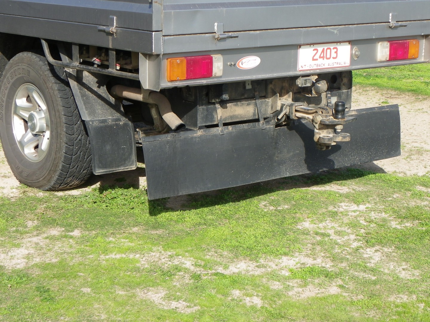

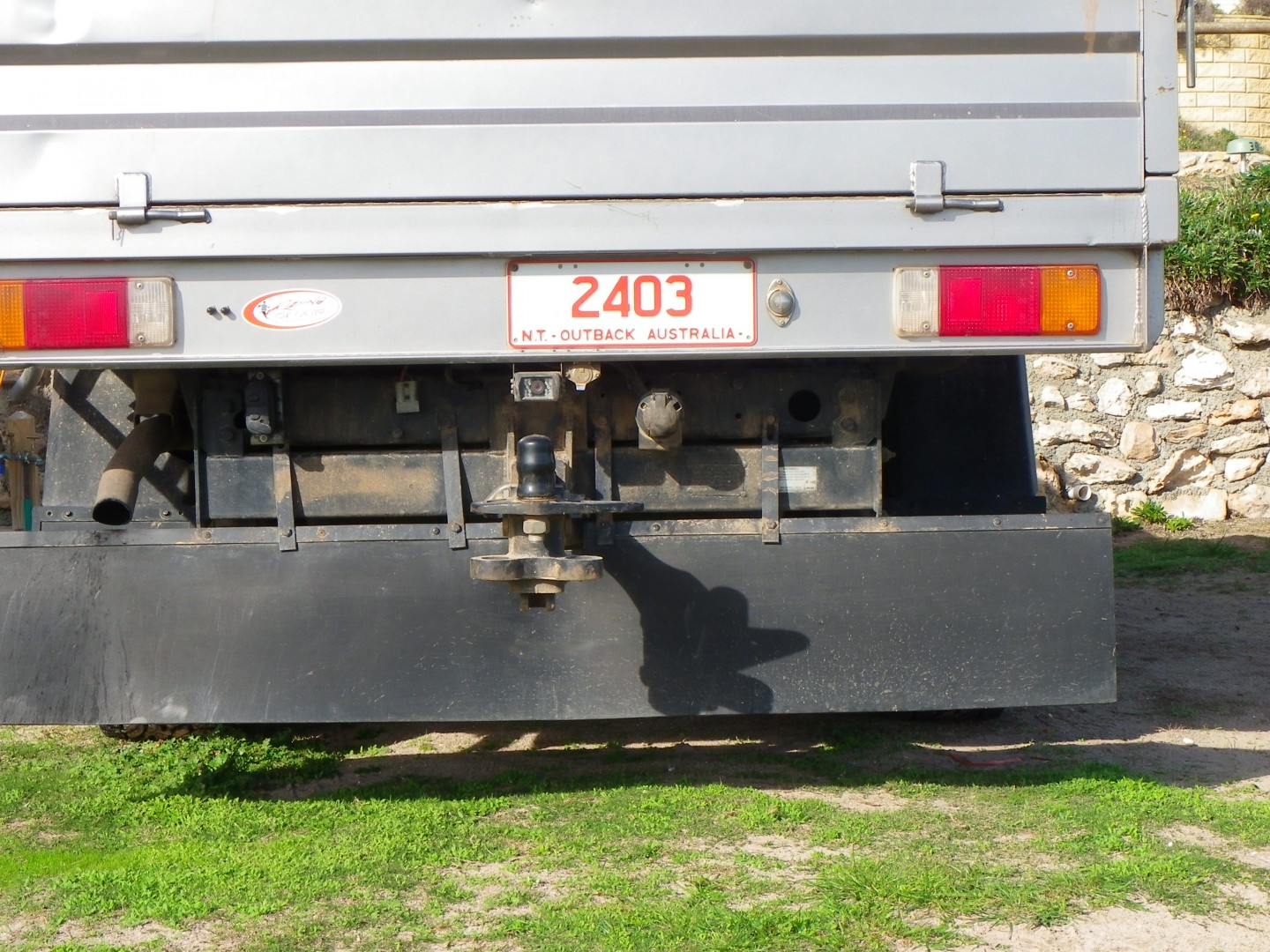

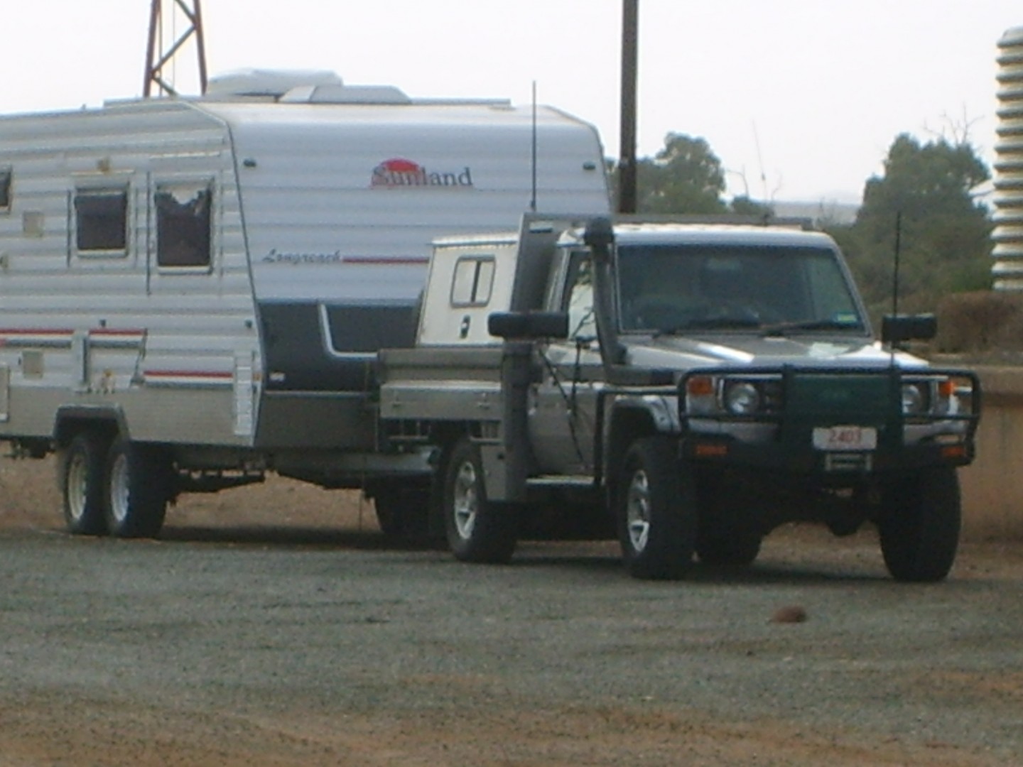

Baz421 said
07:51 PM May 14, 2014
Why pay about $500 + fitting when a simple mudflap right across the vehicle about 50mm from the ground works fine. Have had this system - cost about $50 for rubber and <$10 for mounting bar - for 7 years, heaps of off road work and no stone chips, or sandblasting of A frame due to dust.
I'll post a better photo ASAP, but one attached gives you an idea.
When putting mud flap type devices be aware that heat from the transmission and diff need to escape through the rear.
Not a problem,,, when moving the air moves through and out the sides of full width mudflaps.

Baz421 said
07:37 PM May 16, 2014
Here's the pics I promised. Use this method and save $450 or so $.
