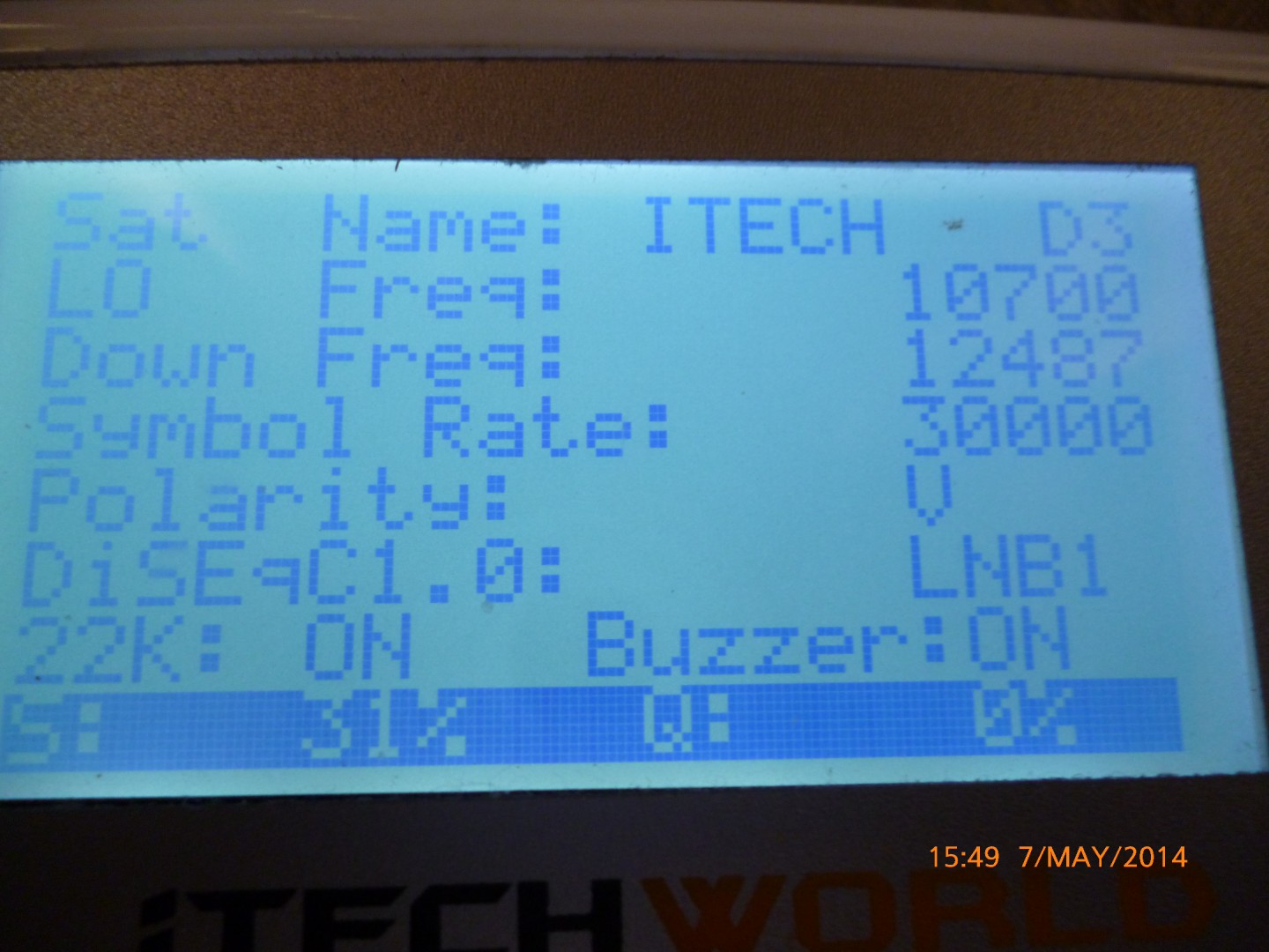

Ket,I had it on that c1 ku and had no luck on that,the infoi have put upis correct as it only toolme maybe 1 minute to find the sat.
The info I have put up wahat I was told by Itech in Wa, and I cant dispute what he told me as it worked, maybe your thinking in Optus c1 ku as on analog?
But if anyone has the Itech d3 this is the correct setting I put above.
Or if you think I am wrong ring Itech in Wa 08 9472 720
att pic is my settings, and yes the buzzer does work.

Chickenman settings are correct for your sat finder d3 i hv same ...if I was wiser in hindsight would never have dealt with itech.more than likely opted for Queensland company who I know from others have received better customer service.good luck with yours great to have one.roy

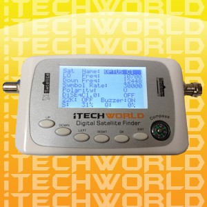

After having problems with my Itech did sat finder I rang Itech and somehow I changed the settings
If anyone else had problems ,this is how you get the right settings.

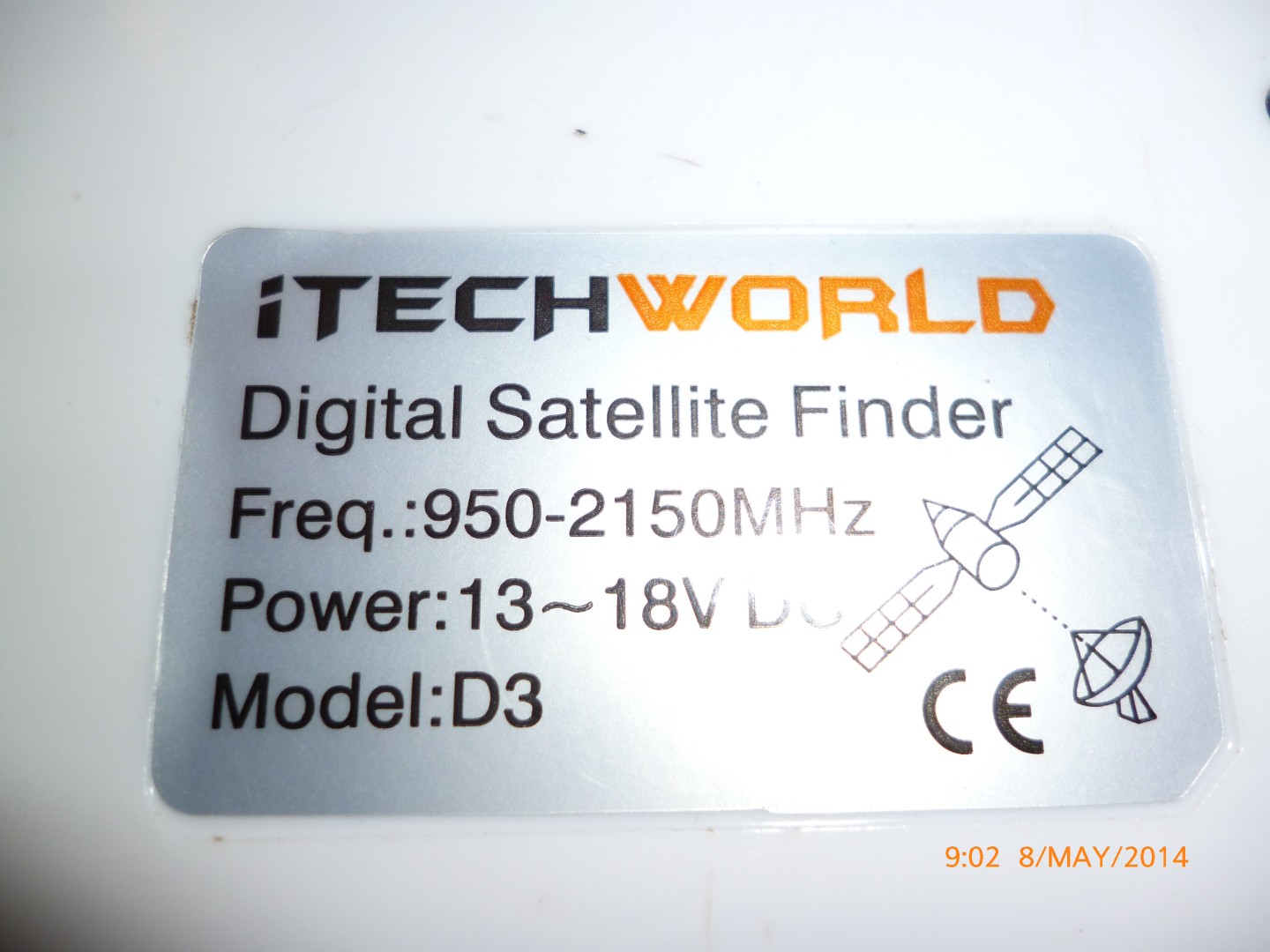

On the model on the back be model d3.
main menue
find satellite
sat name should be itech D3 (forget optus C1 on sat list)
lo freq 10700
down freq 12487
symbol rate 30000
polarity v
dise c1 .0 : lmb 1
22k on buzzer on
click exit then ok to save.
Hope this helps?

The download frequency was changed last year to 12567MHz.
The sat you look for is optus C1
you only need 22KHz on if you are using a "universal" LNB if your LNB is a normal 10700 you don't need the 22 KHz on
DiSEq should be OFF unless you have an auto seek dish.
frank
