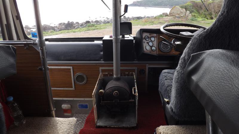

The heat given out by our little gas bottle wood heater, keeps the bus hot all night with no fumes and all the heat is used as the flue travels across the bus to the outside.
02:01 PM May 6, 2014
Any pics of that gas wood heater please NP?

native pepper said
02:49 PM May 6, 2014
It's just a wood heater, no gas. This is today near Devonport, temp outside is 12, inside 29 and wet
What a beauty Native Pepper!...a choofer heater. I'd love one of those in our Avan.

native pepper said
03:21 PM May 6, 2014
G'day Denis, pretty easy to make and you can use any size gas bottle you want. Just make sure it is fully empty and the best way to do that is leave it open to the air for a couple of months and tip it upside down every now and then. Take out the valve to get all the gas out. Then you cut of the valve end to make a door, take the base of and weld it to the side. Make up a hinge, handle and door locking devise so it doesn't open. I used a strip of thin metal to put a flange on the front so the door goes into it and a slide below for the air. Weld in lugs and use an open BBq grill for the fire base, so ash can drop to the bottom. I used 2.5inch exhaust pipe with handles and flares, so everything slides into each other and the handle allows me to pull it apart without getting burnt on the hot pipe. Even driven with it when we decided to move a couple of klms, pretty warm sitting under a hot pipe. Also put it in a cage (ex freezer basket) with a solid bottom and slightly raised for air circulation. The little bolts through the bottom act as spikes in the carpet so it doesn't move and the amount of wood it uses is minimal. Our first trip we carried 3 carrot bags of wood, only to come back with one and a half, now we carry a cordless chainsaw which does the job and people camped with us, don't even know it's being used.

Nifty wood burner, NP, but doesn't it use air from inside the bus? I'm thinking of something that draws air from outside through a pipe (heated by a gas flame which is also outside) and into the caravan/motorhome. I've also given consideration to using something like a gas pilot flame (like the one that heats the fridge) for minimal gas usage rather than a full-blown heater. The idea is to heat a metal pipe at one end (outside) which sucks in fresh cold air, heats it, and sends it into the van. That way, any fumes or CO would stay outside. I hope I'm explaining myself okay.

06:02 PM May 6, 2014
native pepper wrote:
Well I must admit that looks the bees knees.. I like it...
I'm not sure that I would build one but it certainly has merit and with very little effort you could pick it up and use it outside..
With the flue inplace it could also be run on LPG so long as there was ventilation to stop oxygen depletion.. or as Gary said draw the fuel oxygen from outside..

09:05 AM May 7, 2014
Thanks for the pic NP. Very nice indeedy. I noticed you put the pic up pretty quick after me asking so thanks for that.

native pepper said
09:34 AM May 7, 2014
Just grabbed a camera and took it to send, heading home today after Agfest, will go via the east coast and catch up to some friends on the way.
