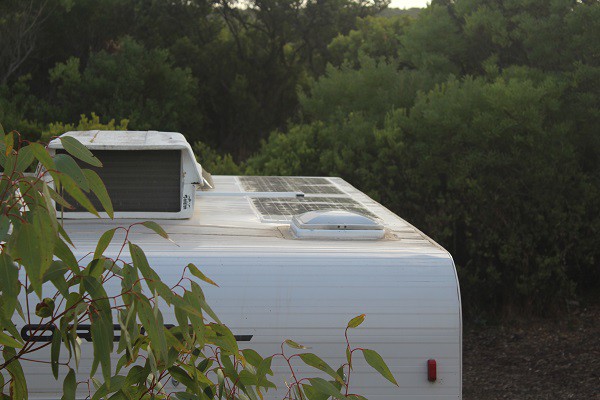

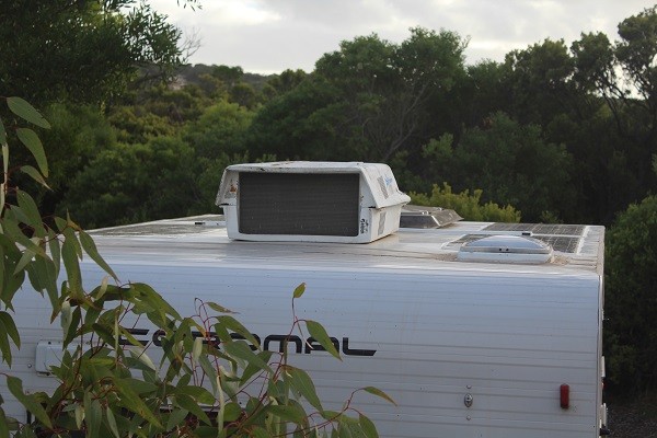

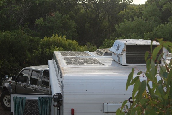

Brenda and Alan said
05:20 PM May 5, 2014
After talking to David (Plendo) about his research as well as the van manufacturer (Coramal) we decided to have the flexible panels bonded directly to the aluminium panel roof.The reasons for this are twofold. Firstly the weight involved in mounting rigid panels with the framing advised by the caravan maker. Secondly we do almost all our travelling during winter so heating of interior of van would not be a problem. Yes we do loose efficiency due to heating but have ample panels for our power consumption. To date three weeks after fitting have not needed any external power input travelling in Vic and southern SA.
Bit of a possible problem with shading from that A/C unit. I suppose angling the van helps somewhat, but pointing E-W would only give you 50% or less power due to the shading.
