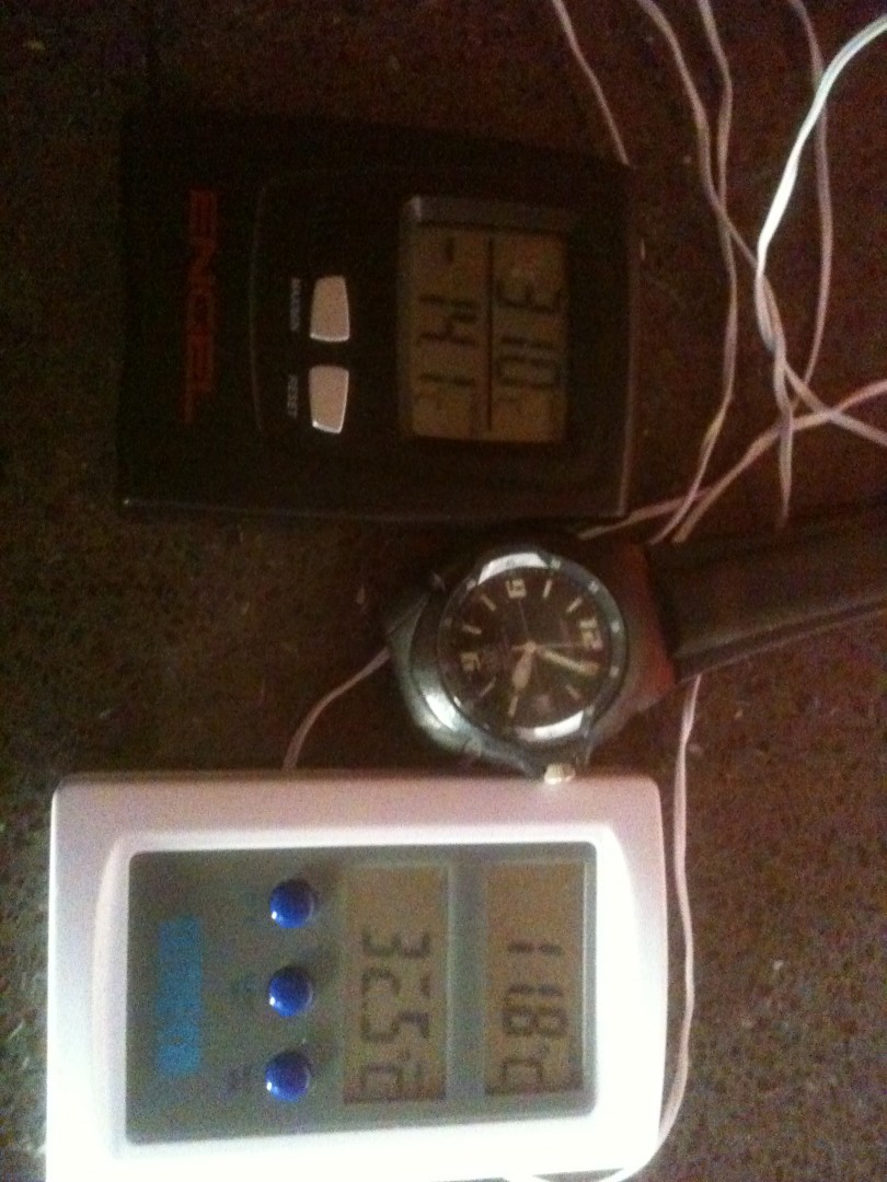

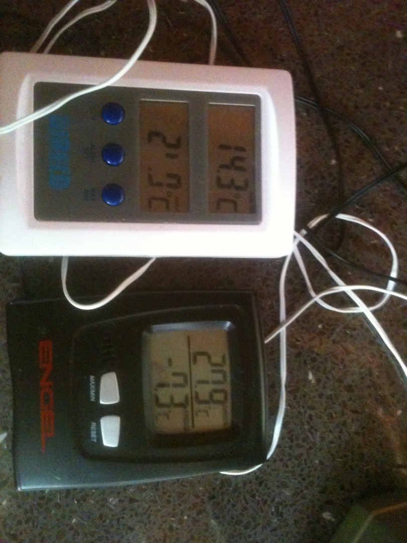

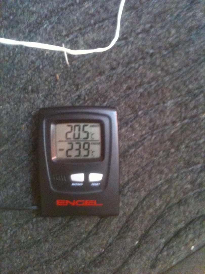

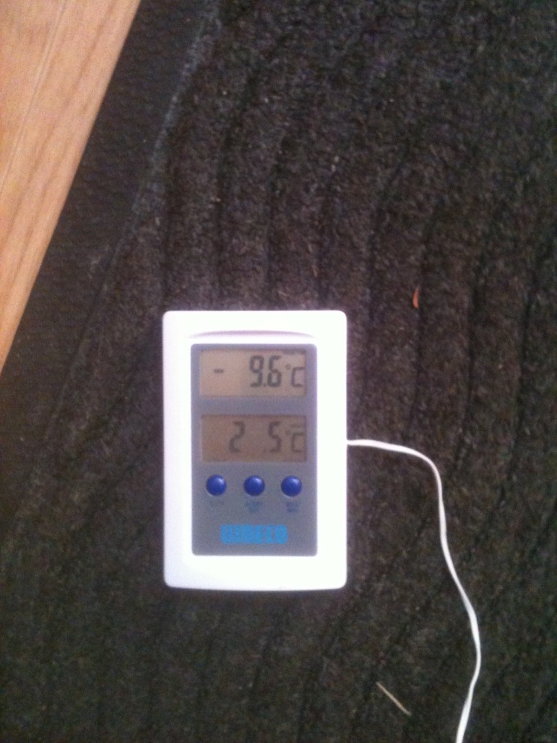

PHOTOS
The minus 23 freezer and minus 9 fridge were at the caravan repair place before I left
the minus 7 freezer and plus 14 fridge were after about 8 hours at home on 240
the minus 14 fridge and plus 11 fridge were the following day
Just hoping that some one had a fridge that had the same problems (no not really wouldn't wish this on any one) and had the solution.
If this new place can't fix it or find a fault I'm thinking wallet..:(
