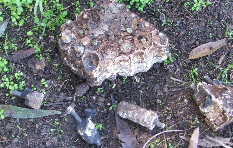

I have a bush block, (in an old fishing village) I am cleaning up. In among lots of broken beer bottles and fishing net I found these; see pic. Could be related to commercial fishing boats? Any ideas? Thanks

Remains of very old 45V battery pack for valve radio. Yes im old enough to have actualy seen them.

Could be a bit of internal ballast from an old fishing boat
Thats my first thought as well..
A battery pack of some sort..

Yep I will say a battery pack.
They were quite common at one time for running the radio.

arthur said
08:17 PM Apr 24, 2014
thanks everyone-it had me baffled

11:58 PM Apr 24, 2014
Definitely a radio "B" battery. The block is lying on its side. Common voltages for these batteries was 45 V (30 cells) or 67.5 V (45 cells.) The cylinder bits at the bottom are some of the cells 1.5 V carbon/zinc that have broken of from the main block. There would be 2 or 3 of these batteries in series to provide the plate voltage.
The battery that is picture in the reply by Mike & Ellie is the "A" battery that provided the heater current for the valves. Some sets also had a "C" battery of around 4.5 V for the grid bias on some of the audio valves.
We had a battery radio up until 1950 when we moved to a town with mains power. The A battery (sometimes called the accumulator) was charged each week. We had two batteries and took the one in use to town each Saturday on our shopping trip and swapped it over for the one left for recharging. The 3 x 45 V batteries would cost dad a weeks wages (teachers wages.) With careful use a set would last a year.
