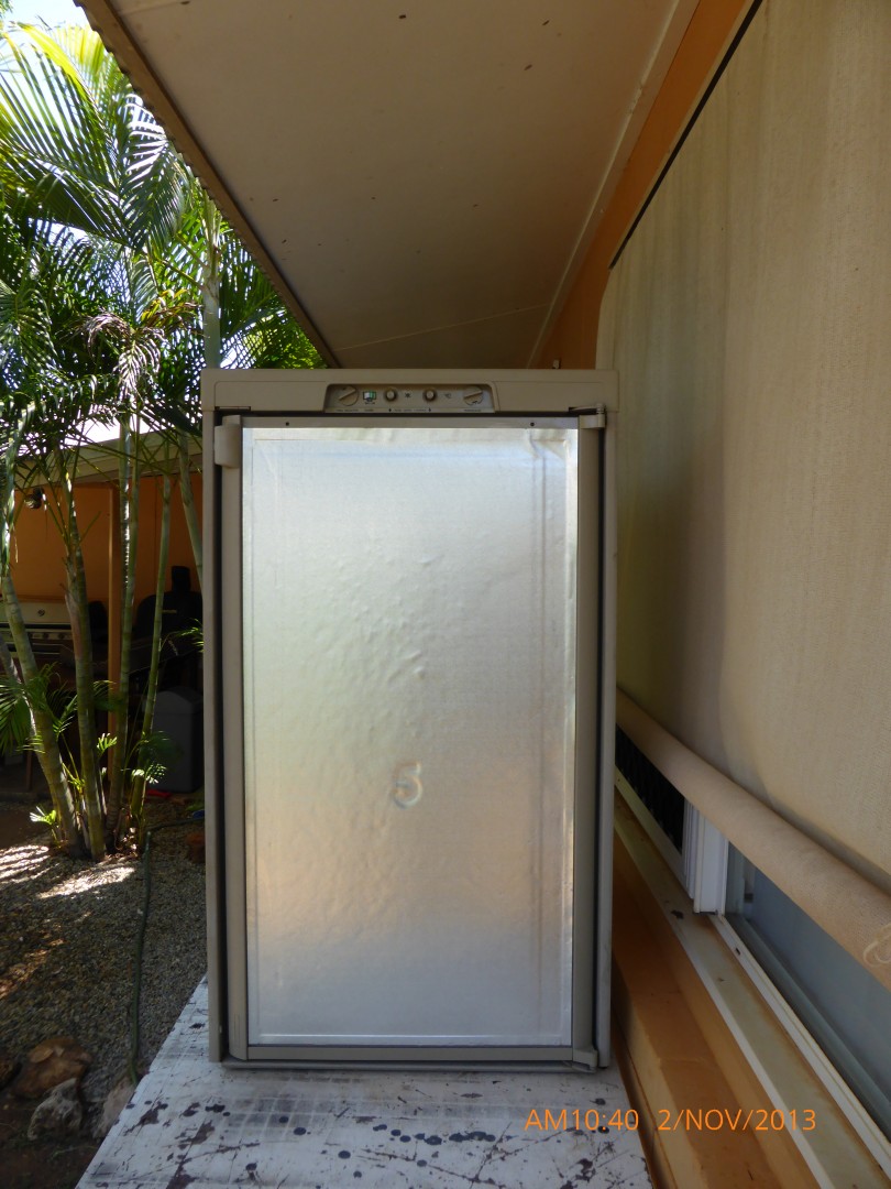

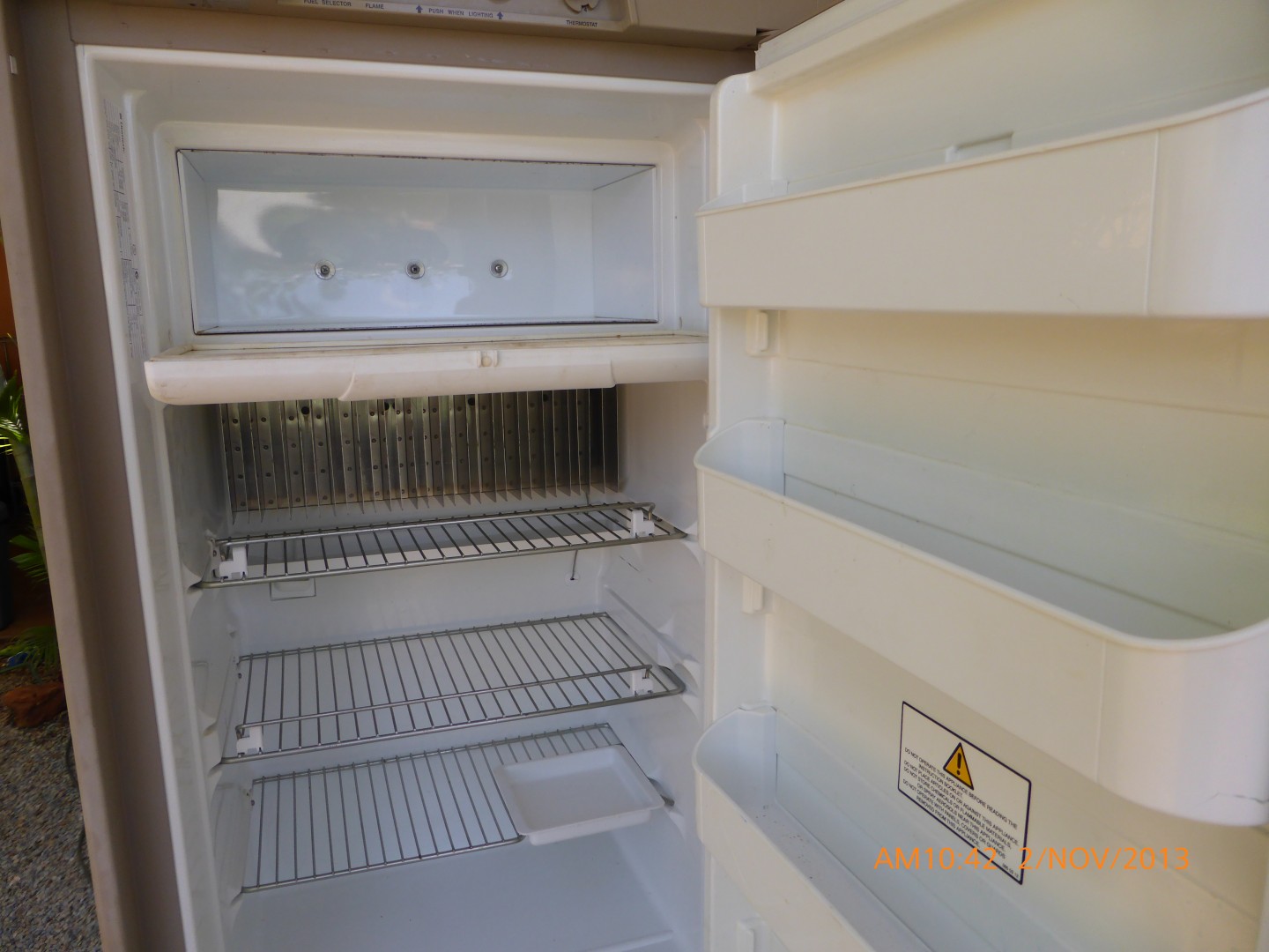

I have a 3 way Dometic 150 litre fridge in excellent condition for sale. It is in Katherine NT. You can have it for $700.00
