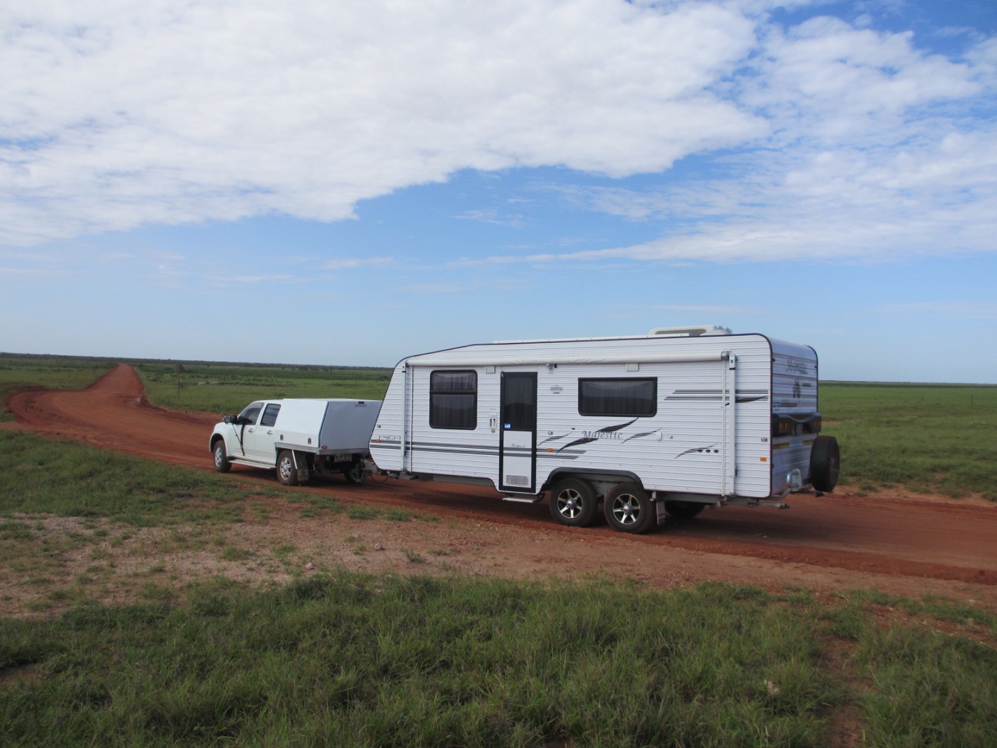

Got one.....love it! Towing 22', 2.5t caravan. Once around, and going again. I don't have an auto cooler, just manually shift down and take it easy going up big hills. I would buy another D-Max if I was looking. Ranger & BT-50 the two next choices. Forget the over priced show offs, get a reliable, tough, real truck. Got my helmet on and in my trench! Have a great day.

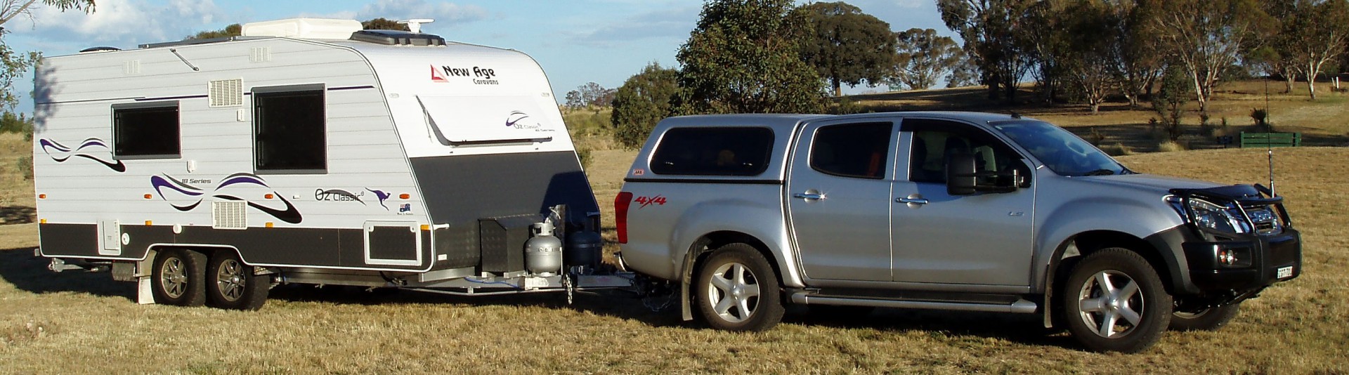

Jonathan said
05:47 AM May 2, 2014
.. I purchased my new combination in Nov/Dec last year. Also test drove the Ranger and Colorado with a small van attached but found my comfort zone was the Dmax ..
Van is a NewAge Classic 18 Series .. (18 ft inside) .. all still new of course but happy with my decision too ..
I have the 2012 model with bonnet scoop (model before current shape) & 4 speed auto.
I bought new and had upgraded rear springs (7 leaf), fitted.
Removed the tub and had tray and gull wing body fitted (Ute Store Brisbane).
When we were in Darwin I fitted air bag helper bellows. They made a big difference.

leevin said
10:52 PM May 4, 2014
The tray is 1600mm x 1600mm x 900mm (H).
The ground to top of body is 1900.
Scares the patooties out of the Princess when you enter an underground car park.
I had the extra springs added as an extra when we bought it.
I got a good deal on the air bags in Darwin, as my son is a diesel fitter.
He sourced & fitted them for me.
They do make a big difference.
Run at 25psi sans caravan & 35psi with caravan.
