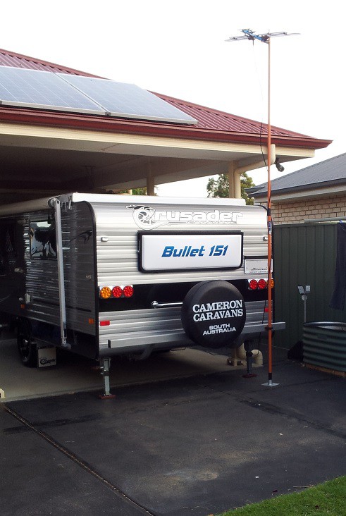

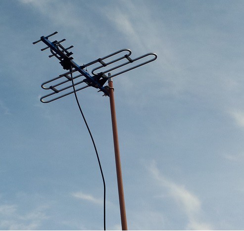

After a lot of looking around at what's available in antenna's and getting totally confused as to what to buy and amazed at the cost of some of them. I have just put together the same sort of setup as described above.
First let me say "If your aerial works for you then great". However many years ago I use to be into Amateur Radio and learned a little about how antenna's work. After investigating many available in the market and feeling a little rusty with what I could remember, I went and talked to an "expert" at a local communications shop. He tried to sell me the best thing he had ever come across for a caravan. What was it? well for those in the know it was a simple "dipole" antenna. For those not in the know, it was basically a set of "Rabbit ears on a pole". the fact that this guy had a shop full of "Yagi" antenna's (you know the ones with lots of elements like the real ones on your roof at home) and a display of expensively priced "caravan antennas" that he obviously was trying to get rid of. I walked out of there totally pee'd off.
Well I took the plunge and put together many of the little hints and tips I had read in many forums I had read recently.
The following is what I came up with -
7 element Digimatch Aerial from Jaycar $70
Coax, fittings and pole clamp from Jaycar about $20
Extendable painters pole from Bunnings $30

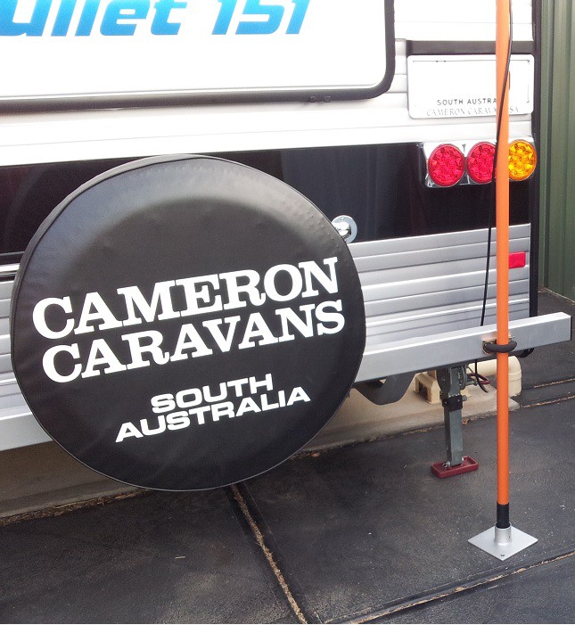

I used the base from my new sidewinder trailermate jack as a base (and drilled a couple of holes to whack in a tent peg or two for stability)
I drilled a couple of holes in the rear bumper of the van and attached the pole clamp. Assembled all the above, point in the right direction and all worked a treat.
NOTE: Internally the van was already setup for TV and just needed the external stuff.
We had our first trip with the van last weekend and this setup worked very well.
It may not be the flashest setup out there but for $120 I'm sure it's a damn site better than the $250 "Rabbit ears on a pole" that that expert tried to sell me.
For another $50 (from Jaycar) I am going to fit a masthead amplifier to the setup and then I should be able to pickup any signal available out there, and I've still got change from the rabbit ears!
Again, I'm not criticising what works for you. If your rabbit ears on a pole works, thats great :)
