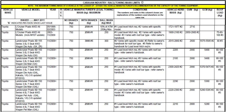

Many folk know that the Prado is rated to tow 2.5ton. I also know that in UK, it's rated at 3 ton.
So tonight I'm invited to a happy hour and one guy insisted that I could talk to Toyota and get that rating lifted to 3 ton. Now, that would be loverleeeee. But why would they? It is a newer model Prado. But.
Has anyone heard of this?

Mary Jane a quick way to check the maximum weight you can tow is 1.5 time the tare weight of the tow vehicle which should be on the rego papers. Vehicle maker may specify a lower weight and tow bar fitted may limit weight also but you cant exceed the 1.5 times limit.

The 1.5 time the TARE of the tow vehicle only applies where the vehicle manufacturer hasn't specified a maximum tow weight. Cheers Ozjohn.
Australian National Towing Regulations
TOW WEIGHT
In December, 1998, agreement was reached by all States Ministers of Transport to implement national towing regulations. In essence, the national rules state that A motor vehicle with a Gross Vehicle Mass (G.M.V.) not exceeding 4.5 tonnes must not, without the approval of an authority, tow a trailer with a mass (including any load) exceeding;
The capacity of the towing apparatus fitted to the vehicle.
The maximum trailer mass specified by the vehicle manufacturer.
Plus the requirement of VSB1
The specified ATM of the trailer.
Put simply, the most you can tow is the amount specified by the vehicle manufacturer, the capacity of the towbar or the ATM of the Trailer. - WHICH EVER IS LEAST.

I don't know which model/year Prado you have ... perhaps this may help?
You can get an upgrade kit for a 200 series Landcruiser which allows the GVM to be increased. Possibly for a Prado also. At the end of the day, you might as well get a 200 series Landcruiser and know you have plenty in reserve. Towing capacity on a 200 series is 3500 kgs.

I did tow a van @ 2.8t with the prado and tho it did tow it on the flat it struggled with any head wind or hills
I would not suggest getting another towbar to tow heavier weight even if it could be done as the engine is just not up to it
how the 3 door can tow 3 tonne is beyond me

You have to take into account that all the models sold both here and Europe have different tow ratings. The tow ratings in Oz are based on a 10% ball loading. The European ratings are based on a lower ball weight percentage than the Oz. The actual ball loading in absolute terms is the same weight for both models.
This was demonstrated in the change of ratings for the Pajero. When Mitsubishi changed the rating from 2500 kg to 3,000 kg they did not raise the ball loading, that is still 250 kg. If Toyota raise the towing capacity then they would in all likelihood retain the same ball weight. To tow an Oz style van you need at least 10% ball weight for safe towing. In essence the fact that Mitsubishi raised their tow figure is of no use to those who tow Oz style vans, it is only of use for those wanting to tow something designed to have a tow ball weight of less than 10%.
In the case of the 3 door Prado, compare the much shorter overhang distance of the tow ball from the axle. The shorter it is the higher the ball weight the vehicle can handle.
