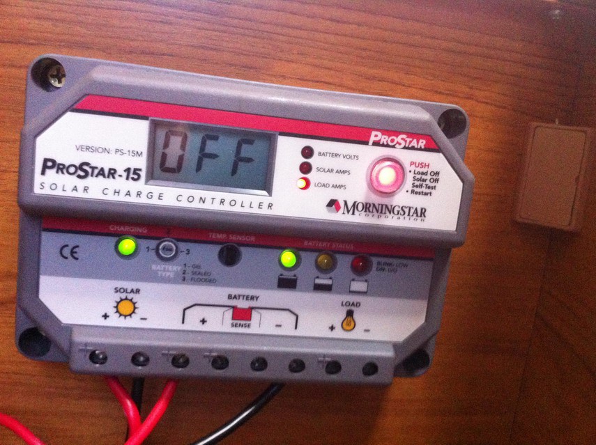

When we bought our van we relied on the salesman to recommend size of solar panel. I now know we have a 100 A/H deep cycle battery and a 120 watt panel with a "regulator" of some sort.
Wondering how that compares to what you the forum members are using?
Hi Paul, I have a 100ah deep cycle AGM battery with a 140w solar panel, ATM, so far so good.
I am thinking when I go on the road full time to up grade to 2X 100ah batteries and add another 160w panel ( to make a total of 300w) So charging should not be a problem. My regulator is a CTEC D250s Dual. Cheers,

Hi Paul
we have two 120 ah batteries and two 95 watt solar panels with a 30 amp regulator we also have a 2500 watt inverter
we can just manage with this amount free camping we also carry a 4.4 kva generator
