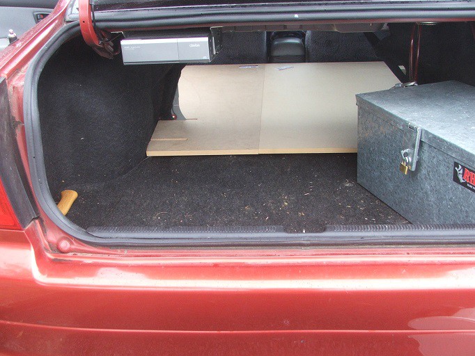

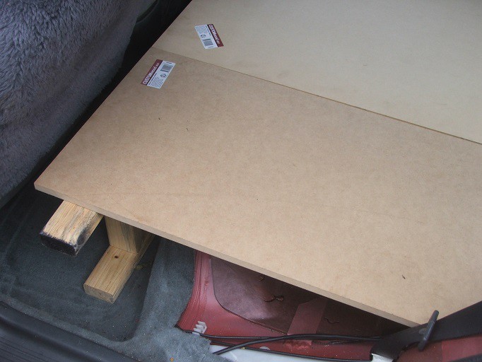

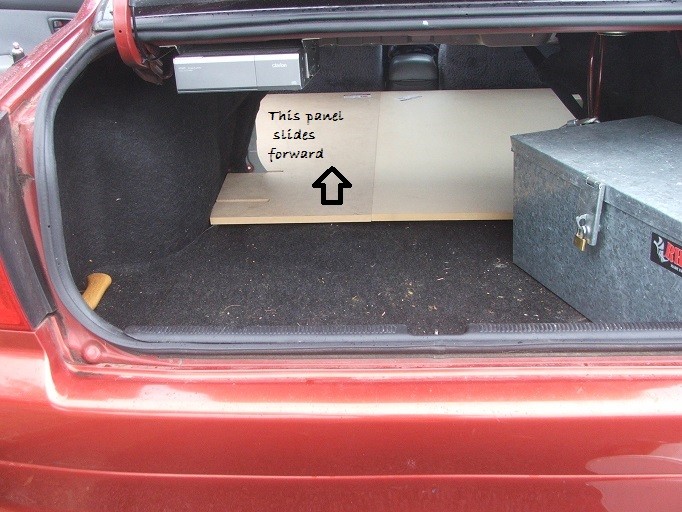

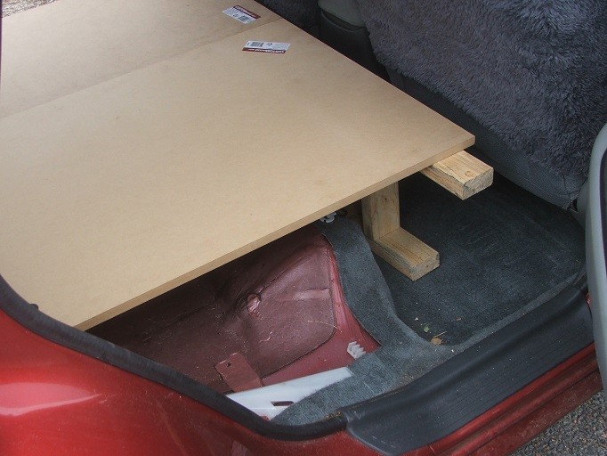

I have a nice sedan which I have owned since new for 12 years. Its a V6 3.5 litre Magna. As it has only 139k on the clock and no rust, I don't want to get rid of it. Even though it is not really a travellers' or trade car.
I pulled out the back seat and added a deck. I can still carry a passenger in the front and have 200CM of length space from the boot to the back of the front seats. If I want to sleep in it I can slide one panel forward (with the front seat forward) behind the passenger side which then gives me 240CM. It's only for the odd one or two nights or carrying tools. Its 16mm craftwood and seems OK to carry my weight (100kg) without extra support. I have cut it in neat so no permanent fixing was required. The frame behind the seats is nailed together, but just sits in position. I would sleep with my head behind the passenger seat and my legs going into the boot. I won't be rolling over during the night, but it allows me to stretch out flat. I will only use a thin mattress or similiar. Also removing the back seat allows the front seats to recline almost horizontal, when the frame is removed.

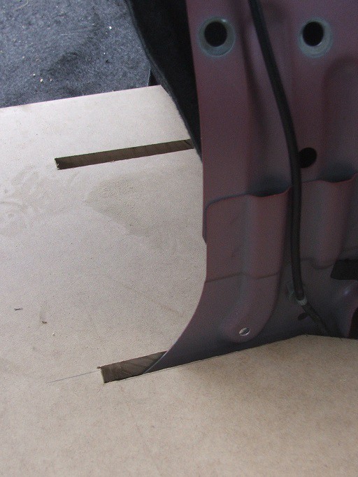

So in the spirit of this link;
http://books.google.com.au/books?id=jiQDAAAAMBAJ&pg=PA142&lpg=PA142&dq=sedan+car++bed+conversion&source=bl&ots=7wmu8Gd0ne&sig=WaXqY-jjOjY9gz8fZRMDKAnWYto&hl=en&sa=X&ei=wWpvUZmyDemOigfGqoGgDQ&ved=0CGQQ6AEwBQ#v=onepage&q=sedan%20car%20%20bed%20conversion&f=false
(I don't know how to add a proper link)
-- Edited by arthur on Thursday 27th of March 2014 04:20:20 PM
-- Edited by arthur on Thursday 27th of March 2014 04:24:55 PM
-- Edited by arthur on Thursday 27th of March 2014 04:29:13 PM
