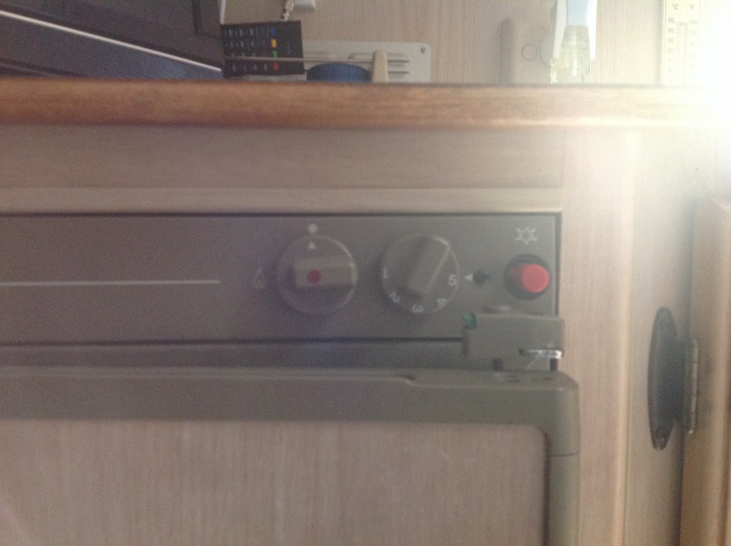

Can anybody tell me how to get this fridge going on gas Looking fro front of fridge it has 1x red switch 1x green switch A knob with 1to 7 on left side front
It has 1 x gas elect switch 1 to 5 knob 1x orange switch on right front How do I set these to get it going on gas Regards Greg

If you can advise the Model # of the fridge, should be on a data sticker in the cabinet and also a photo of the front controls would be useful.

Hi aspro. Is your fridge the same as this one? If it is this is how you light it,turn the left hand knob to the picture of the flame, the middle knob to no 5,push and hold the left knob in ,and push in the far right hand knob which will click ,keep clicking until the fridge lights,to tell if fridge is alight open the door of your fridge look down the bottom left corner inside the fridge and you will see a round hole look in there while you are clicking you will see the pilot light flash keep clicking until the flame stays on.

Yep...... that is exactly how mine works.......make sure gas is turned on at the bottle and that it has gas in it.......
1x red switch
1x green switch
It has
1 to 5 knob
Regards Greg

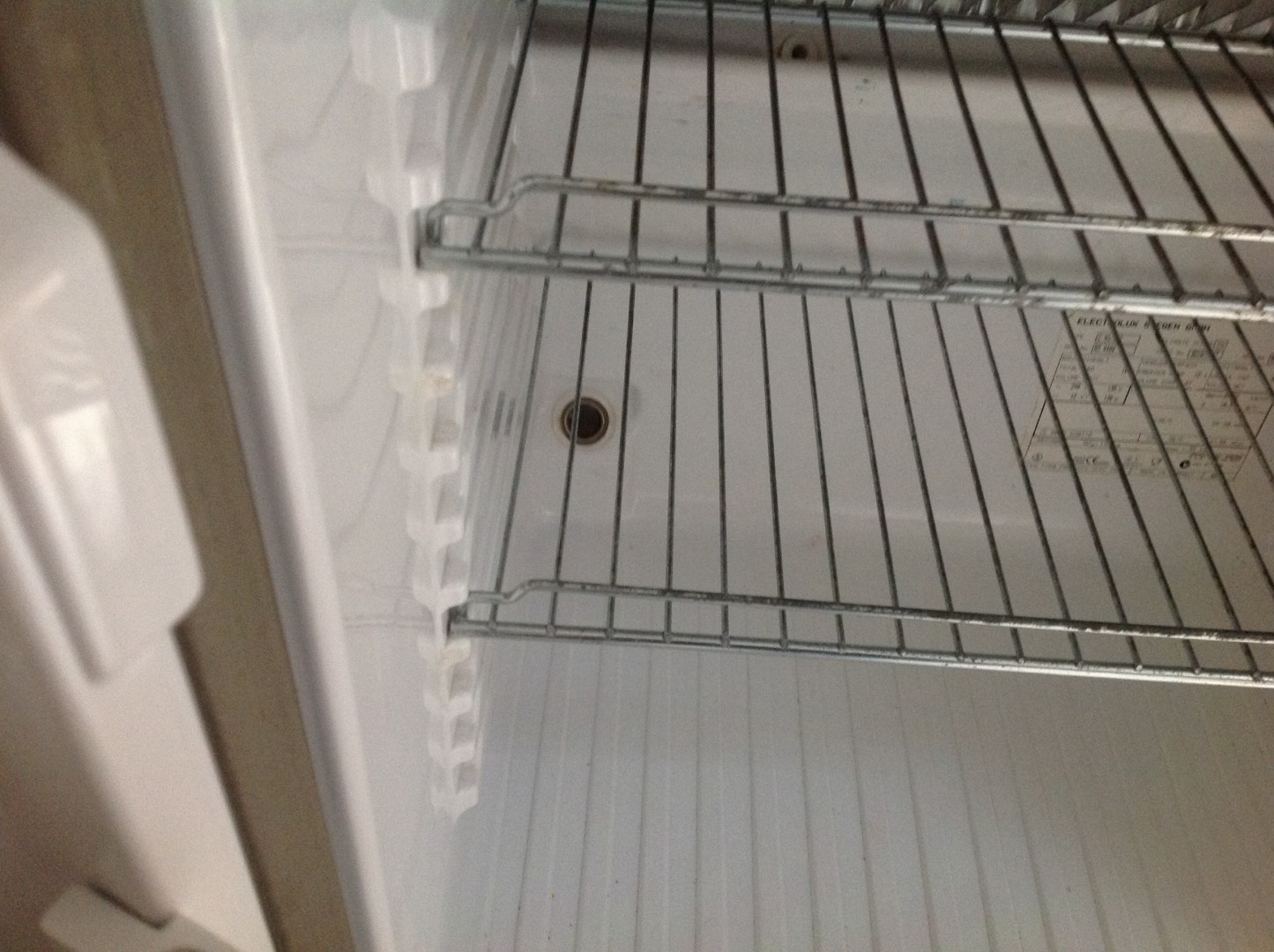

I have sent a photo can not find modal
