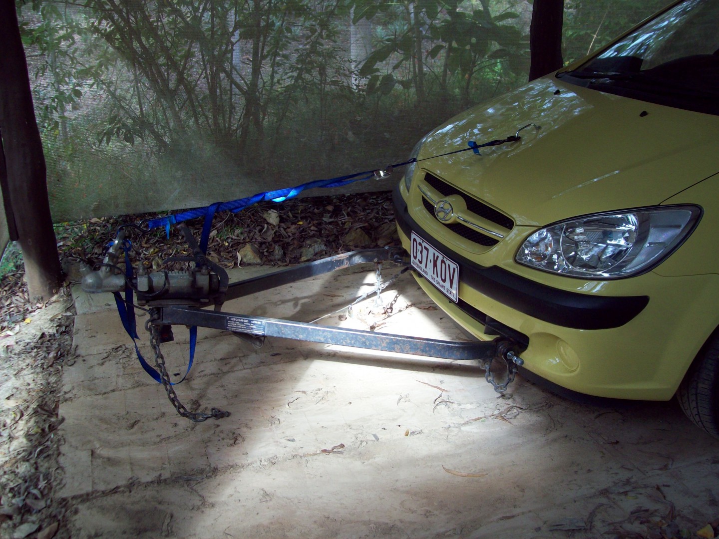

My sister tows a Getz behind her Sunliner Motorhome Milo. Says the A Frame is very easy to use.
The A Frame does come off when you're using the car on it's own.

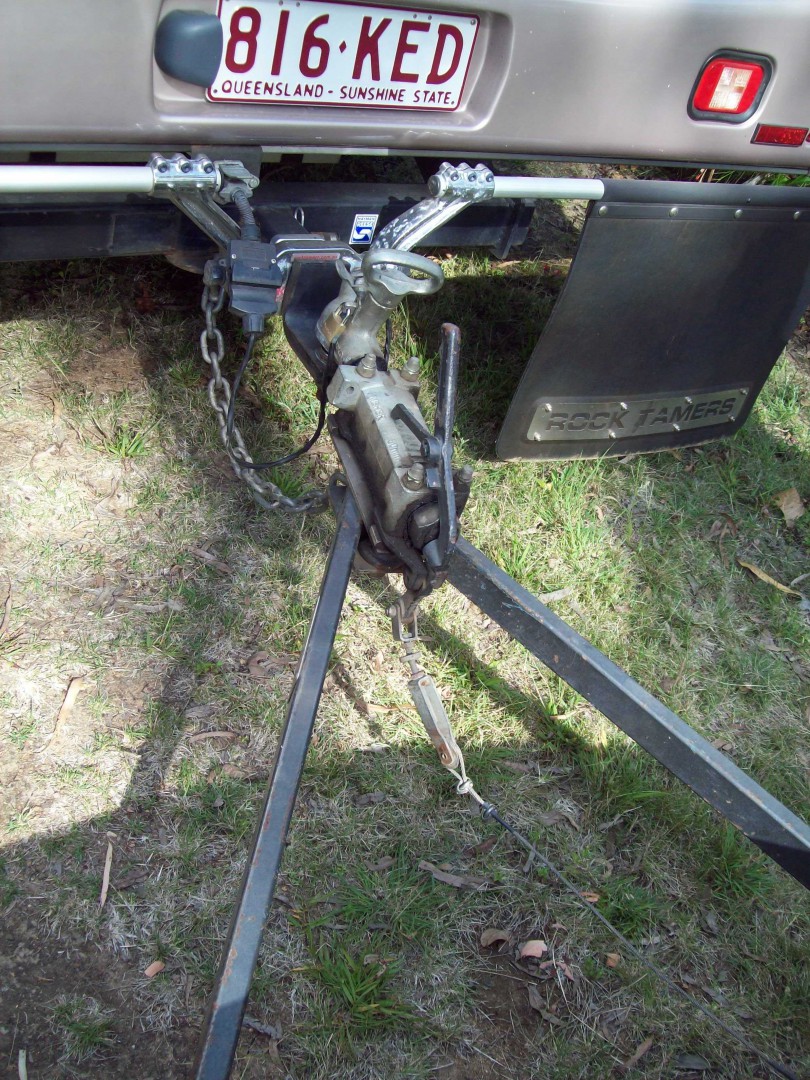

We tow a Suzuki 3 door with a falcon 2 A frame.
all easily removes from the car and folds up against the rear of the motor home.
All too easy and you can hardly tell its riding behind you.
milo said
09:29 AM Mar 22, 2014
thanks Sheba, only reason I'm of gypsy trailer is my car is an auto ,have been told a frames not the best with autos
but could be wrong about that. do you need that thing on the hood?? dont know if I'd like that..

08:11 PM Mar 22, 2014
That is not on when you're driving around in the Vehicle Milo. She just hadn't taken it off, as she didn't drive it while she was at my place. It was easier just to leave it like that, so it would be quicker to hook up again behind the Motorhome when she left.
I posted that Pic. so you could see how the "A" Frame attatched to the Vehicle being towed.
