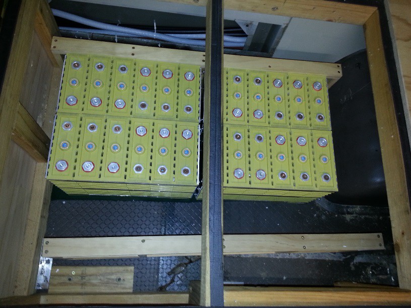

--> Look at maybe updating your Batteries to LiFeP04's if you can afford them.. [ If you want more information about LiFePo4's ] Pm the one's that have them..

You'll appreciate your lifepo4 batteries, they are an extraordinary jump up form LA.

- the initial cost is more expensive.. but I'm hearing that if treated well they will FAR outlast any LA setup, and be FAR cheaper over their life time..
That is one of the main issues that Li's have over any AGM setup..
-- You need to Look at the Coast of an equivalent Usable Ah system.. Noting that Li have a 80%DoD[5000cycles] while LA's have a 50%DoD...[1000-1500 cycles depending on make]
To even match the Li's you need between 3.3 - 5 set's of AGM's..
What's your battery capacity Native Pepper, and how much solar do you have to top it back up? From what I've read online you'd be pushing pretty hard to use it regularly, with a fridge as well, with 300AH with 350W of solar.

We have 200Ah lifepo4 and 710w solar, plus 24v x 60amp engine charged transfer battery (AGM soon to be 100Ah lifepo4) attached to a 60amp 24v-12v charger. The transfer battery runs through a redarc from the start batteries, which will also become lifepo4 when they die. Our panels consists of 460w 12v and 250w 24v, the 24v is switchable from start to house, or transfer. Been almost a year with lifepo4 and not once have they gone below 12.6v, our low voltage cut off is 12.4v and it works beautifully.

On the issue of the Generator..
This plus the Solar to recharge them will be all that I will use..
do your sum's..
Juergen
