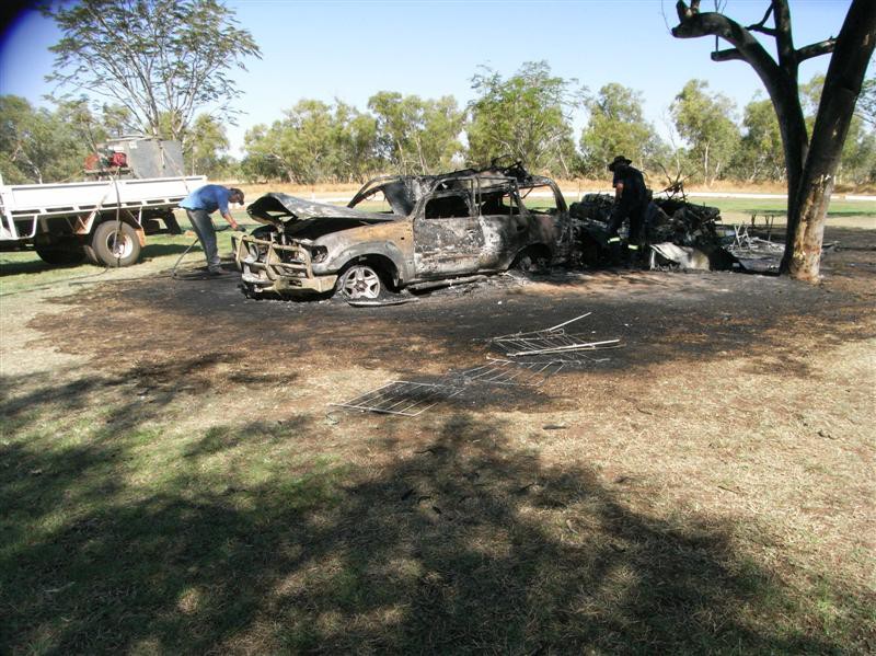

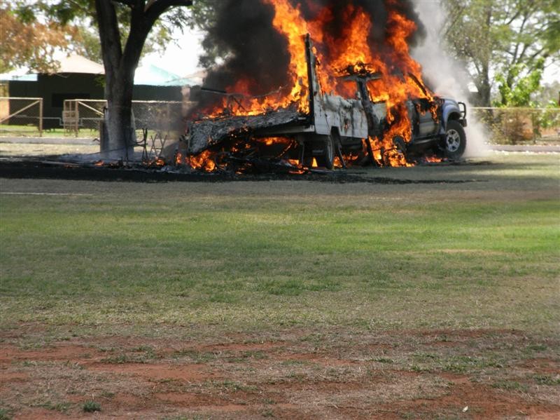

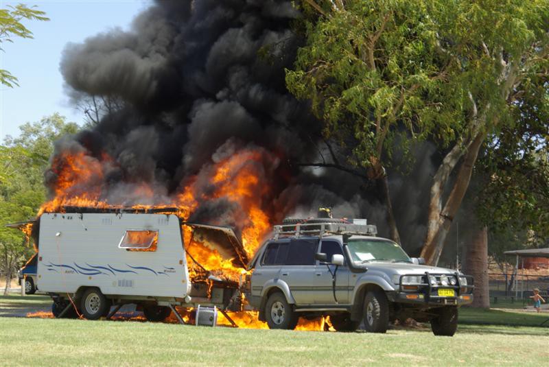

Nothing like carrying a bomb in you vehicle, especially a petrol one. All you need is short circuit somewhere and you're history with just a small amount of fumes. Doubt you'll find anything to stop the fumes, there are to many places fuel can seep from. Then you add changing temperatures in side the car, normally getting hotter the petrol will expand, pressurise, evaporate and find a way out. Pure insanity to carry petrol in the interior of your car, plus the fumes will effect you're health as well. Every time you open your door, the interior light comes on, touch your brakes, small short circuit and boom bye bye and all for a stupid noisy smelly polluting generator. But each to their own approach to life and death.

Make all the technical apologetics you like, but the facts are, it happens and those spending lots of time on the road, see the remains and local news reports that are out there. Below is a quote from DMP dangerous goods director Philip Hine,
You can't seal a generator fuel tank, they need to breathe when the fuel expands and evaporates. Wonder how many read their insurance polices, they may find most policies require you to inform your insurer if you are carrying flammable dangerous goods in your vehicle and or vans. Gas bottles may be included in the policy, but not generator fuel tanks, or other containers in cars and vans. Petrol is covered in the 3 most volatile dangerous goods hazard classes, 1-3, explosive, gaseous and flammable.
It's much better to be safe than sorry and having carted fuels, chemicals and explosives for many years in the bush, had to undergo a hazardous goods course, including theory, case studies and practical demonstrations and really gives you the facts. Personally I don't care what others do, but factual experienced information is much more precious and useful, than all the empty hope and denial of reality you find in most. You carry petrol in your van or car interior and you're a mobile bomb just waiting for detonation.

My attitude is derived from being a full time traveller for more than 50 years and still spend at least 9 months on the road, it's called hands on experience and a life time of living knowledge, working and driving in the bush. Then you can align that with being a road train driver since the age of 20 and still doing it a couple of times a year so people can take holidays.
The information I'm giving is factual and from experience, couldn't care less if anyone takes any notice, but if one does and saves them a problem, then my posts are worthwhile and really only for those interested in their safety and information.
Seen thousands of wrecked vans during our time, roll overs are very common, as are explosions and as more get on the road, so we see more when we come near civilisation.
As for polluting my air, no chance, where we travel and camp, only run into real travellers, the majority we have known for many many years. We stay well away from the tourist conga line, holidaying urban travellers stick to. To us the peace and tranquility of the bush is what we seek, not noisy smelly polluting urban living. There are plenty of van parks and tourist camping places for those desiring urban conditions and never ending noise.
We know of a few people who use medical equipment and don't have generators, but really good solar setups. If they need extra power, they would stay in van parks and powered camps. With the technology of today, you can run just about anything on solar if you have the proper input, storage and output.

Been on the road 40+ years virtually full time, trucking and travelling. Have come across many episodes of fools carrying petrol in vans and vehicles, as they blazed away on the side of the road, or camp area. We used to carry a petrol chainsaw and never bought fuel until we knew we would need it, then get rid of what was left. Now we use a makita 36v chainsaw, which does an excellent job for our little wood heater and has also cleared a few downed trees we've encountered at times, blocking our way.
It only needs a slight accident carrying petrol and the always associated fumes, a small spark or heat source and bingo up you go. Plus you need to understand if your rig is insured and petrol you are carrying causes a lose, you may not be insured. It's against the law to carry hazardous materials with out proper storage, a permit or proper signage and that certainly includes petrol. As some people we ran across a year or so ago found out when their van and car burnt out after a small collision in W NSW and fumes from petrol they were carrying exploded. Luckily they had go out to inspect the damage when it blew up. We met them at a small town they were staying at and trying to decide what they would do, their insurance would only cover the car, not the van which had the petrol in it.
The number of people trying to get on the Tas ferries that get picked up with petrol is amazing, mobile bombs as one inspector told us. They have to either put it in the vehicles or leave it behind, many end up dumping it and the same with diesel.
Yes everyone has different idea's and that's fine, it makes for an interesting world. But not into mobile bombs, it's suicide and I like living safely.
It also amazes me the number of people travelling who don't carry any fire extinguishers they can get to, or other safety gear. The post above seems to suggest there was no ability to fight the fire, which is very common. Having extinguishers in the van when it catches fire is not very good thinking. In our bus we have then inside and also underneath where they can be got at easily if needed. One sits above he stove, another by the door, one in the back bedroom and underneath there is one at each end of the bus.
-- Edited by native pepper on Tuesday 4th of March 2014 01:49:09 PM
"It wasn't too long ago that a driver was badly burnt after lighting a cigarette in a vehicle where petrol fumes had accumulated after venting from a jerry can." http://au.news.yahoo.com/qld/a/15198391/dangerous-goods-on-dmp-radar/
