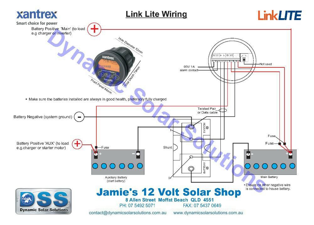

brian said
04:28 PM Feb 28, 2014
Mr B2 wrote:
Also, Would this controller do away with me installing the Xantrex Pro Link battery monitor,
Or would I still need that one as well,
There is very little information to be gained from that website which in itself is a pretty poor example of a trader's website.
I'm sure you could find better dealers around who at least provide a reasonable website to peruse.
On a scale of 1 to 10, and going by price alone as no other details are readily available, I would have to give it about 3, but it should handle 400w OK provided you don't let the batteries get down below about 60% Soc..
The Xantrex monitor is a far more reliable bit of gear and will give you more info, with more accuracy, than you can ever expect from that cheap controller.

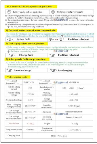

I will try again with the Specs of this Controller, Hopefully they will be clear to read,
This Particular controller is now available from a shop in Melbourne, So I dont think it is the Crap some people think it is, Just because it happens to be Chinese,
The shop in Melbourne wants about $20-00 more than the one direct from China, Its the exact same controller from the same manufacturer,
Its obviously not big enough for my future use, with the bigger Wattage of the panels I want, At least 400 Watts, but prefer 500 Watts of Solar,, Space on my roof is extremely limited,
It is also effected by shade on one side during the day, The other side gets full sun, Depending on direction, Both Panels get full sun, The sails block out one side from time to time,
Have a perusal of the specs, Tell me what you think of the Gizmo's inside it, And what they do, Its both an PWP and an MPPT, According to the specs,
But Like I said, Its over my head, This is a Sparkys realm,

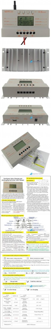

Hi all,
This is a newly released 12 Volt MPPT Solar Controller, I am considering buying it,
Not being an electrical whizz, To be Blunt, Its beyond my Capabilitys,
I would like very much for the Electrical Guru's on here to have a Squizz at the technical side of it and see if it is any good,
My other 30 Amp Controller works magic with no problems, Same company, But doesnt have the read out this one does,
I do like the read out option this one has,
It also states it goes to 700 Watts approx, So I can update my solar panels at a later date, I eventually want 500 Watts of Solar panels,
Thanks for all advice given,
-- Edited by Mr B2 on Friday 28th of February 2014 02:51:03 PM

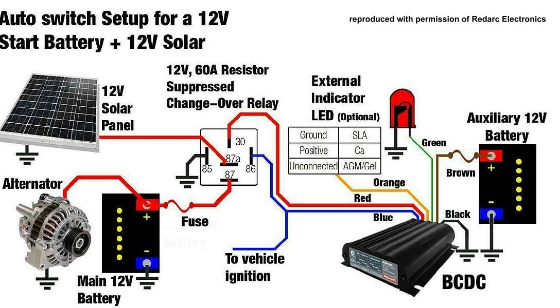

Some of the diagrams I have used on my Boat and Coach,
The boat also has a Wind Genny,
I dont have shore power or Generator,
Both are fully self sufficient for power,
TV, DVD, water maker, Pumps, Micro wave, Radio, VHF, Auto pilot, GPS, Radar, Self steering, Invertors, Drills, sanders, Electric tools, Etc Etc, I run a full workshop on both,
Thank you for your assistance,
