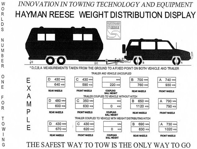

If you don't fit WDH then the weight imposed on your rear axle will be 40 - 60% more than the ball weight or your van alone. You will have to make allowance for that or you will possibly overload your rear axle. The following demo of the effects of coupling your van with and without WDH shows the effect.
Alko ESC has absolutely nothing to do with a WDH. The ESC controls sway or over sway by applying a brake, left or right depending on the swing to control the van. WDH spreads the load of the vehicle off the tow ball to all over the tug thus getting the van to ride level.
Amazing the number of vans you see that are nose down, ass up and the tug with the back nearly touching the ground.

Some camper owners fit a Weight Distribution Hitch between the tow car and the camper. A number of other campers have suggested to me that it may be advisable to fit a WDH to my tow car / camper setup, a KIA Cerato towing an Avan Aliner. Accordingly, I contacted KIA Australia to confirm if this was approved - here is their reply :
