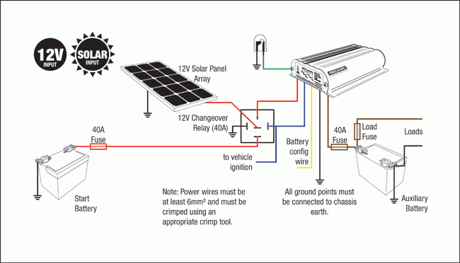

we ran a 60L Engel in our camper trailer powered by a 135AH VRLA battery which was charged from the alternator of my troopy via Redarc BCDC1225 battery charger which was located in the trailer, beside the battery. We also had a 120W folding solar panel which connects directly to the BCDC (not through the regulator on the panels) and used a relay energised by an ignition feed to select between the two, as per this diagram from the redarc website. The BCDC can be configured to charge different types of batteries as well eg. GEL/AGM - Lead Acid - Calcium.
We used this setup over a 20 odd day period mainly for overnight stays, with a few 2 and 3 day stays, without external power up through the centre of Aus (so plenty of sunshine at the time). We never ran out of enough battery power to run the fridge and 4 led light strips, with a bit of use on a laptop thrown in as well. The fridge was set at around 1deg to 2deg for this time.
Although I had no way to monitor battery state of charge, and considering the ambient temp overnight was around the 2deg to 4deg, I reckon we could have got at least another day without power or charging from the alternator as it usually took only 4 to 5 hours of sunlight to bring the BCDC up to float charge stage.
