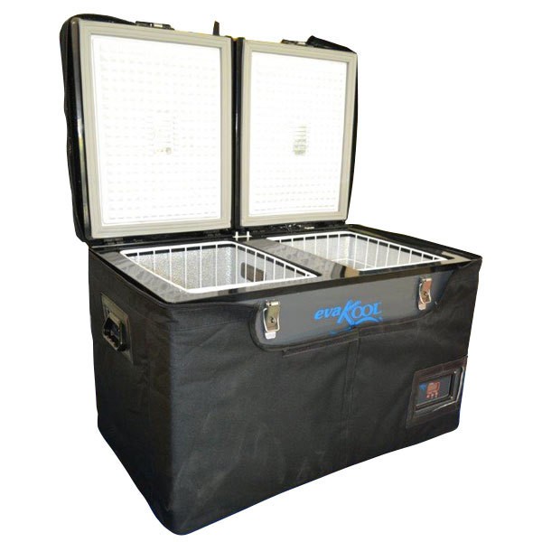

got one like this 70 ltr all up ,and happy as larry with it
