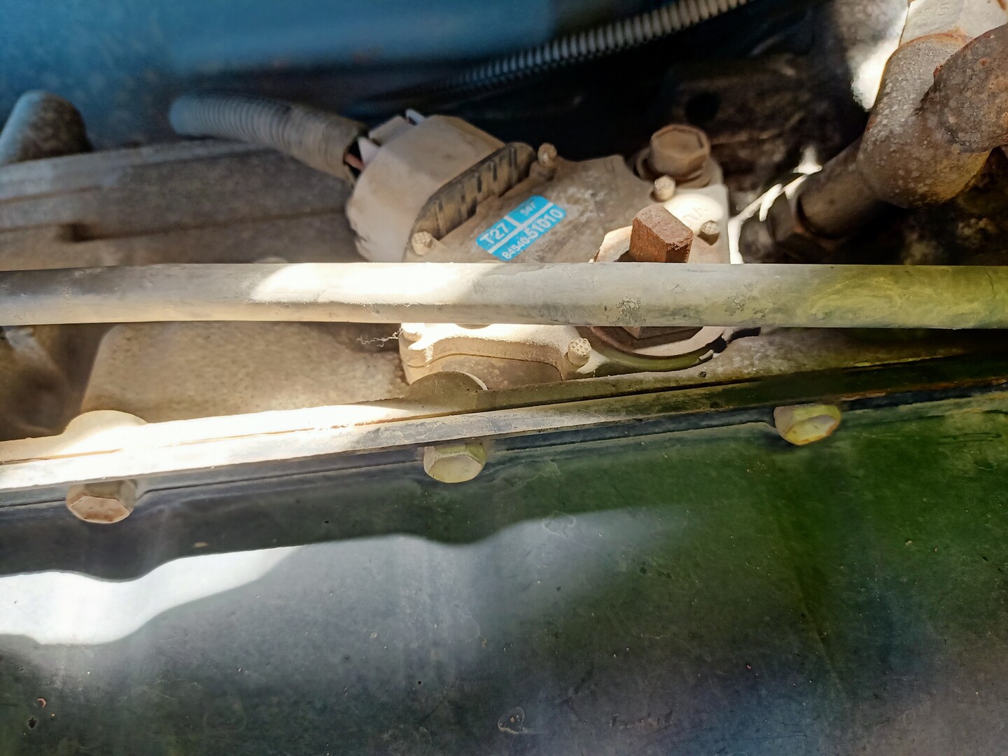

after working for toyota for 23 years i suggest you get the neutral start switch on the auto trans checked
it is a common problem on older toyota's
it is located on the bottom of the shift level (it also controls the reverse lights)
it is designed to stop the vehicle being started in gear (only allowing to start in park or neutral)
the neutral start switch wears after time and can go either way.....allowing you to start in gear or not start at all
your description of wiggling the shifter makes me think that may be the issue

G'Day Doug, as Yuglamron says, all automatics have a inhibiter switch in the gear selector mechanism to only allow starting in P or N....they sometimes fail or get out of adjustment. When you go to start normally there will be 2 clicks - one from the starter relay that powers the starter solenoid and a 2nd click from the starter solenoid as it energises and powers the starter motor.
So if the inibiter is not not working correctly, you may still hear a click from the starter relay although it will not be as loud as the starter solenoid.

I have now gone back to thinking it maybe the Gear selctor Switch/Neutral start switch/inhibiter switch, whatever it is called ?
It seems to happen every time I go to start the car now and as soon as I move the selector arm it starts.
Any ideas as to how hard it is to fix, is it a DIY job or Auto Ele or Auto Trans expert???

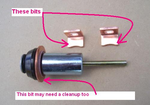

03_troopy said
06:52 PM Mar 1, 2014
Might be worth checking the starter motor contacts rather than wait till it fails again. Not a big job once you have the starter out of the car.

03_troopy said
07:49 PM Mar 3, 2014
Come on Dougwe... we're insuspenders here.... I'll put a carton on the starter contacts...
One will be eroded/burnt more than the other, the plunger (because it rotates) usually isn't too bad, but may need a cleanup.
Edit: Hmm which a lot of times means the repairer will say you need a new starter motor, so check them yourself... I'll see if I can find a pic

Can you please tell where and how to access the neutral safety switch please?
I have a Prodo 120
Thank you
Good news I have found it, tucked up on the drivers side of the gear box
-- Edited by Rabs on Monday 23rd of December 2024 06:32:42 PM
