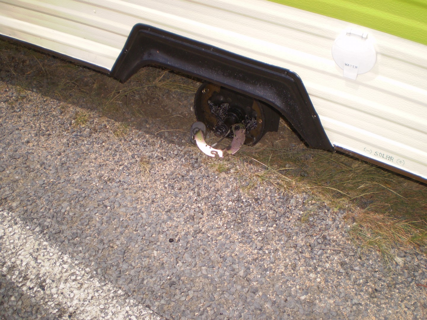

Monday I turned my nose for home and got as far as Stanthorpe when........BAAAAANNGGG I threw a shoe........NO !!! I threw the whole bloody foot with it as well... BUGGER!!!!!!!!.

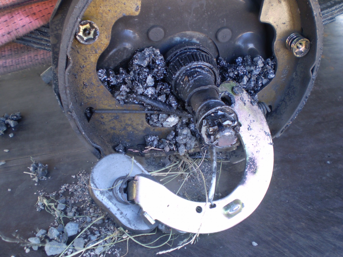

Well 4 hours later and a tilt truck tow back 16 klms into town to the repairers....The outer bearing was maybe a little tight or just faulty and KABOOM, it let go and the whole wheel flew off but not until it went up under the wheel arch and took out some of the floor and rear corner of the van.
I was lucky as I did find the wheel and it could of been worse. I an now lounging about in a motel room for a couple of days until a new axle and brake setup can be sent down from Brissie. Hopefully back on the road sometime tomorrow (Wed.) Then I will go to Beardy creek again.

looks to me like a repair job, not a new axle. New brake assemble, new set of bearings, a clean up of the axle. Parts cost of about $120- $150 plus at most a couple of hours labour. Hate replacement repairers, what ever happened to quality repair people. That's a job that can be done on the road side. all that aside I hope all goes well and you get the desired outcome

Thankfully our squeaky wheel was fixed by repacking the bearings plus adjusted the brakes... seeing your photos certainly gave us a warning ! Hope you are back on the road again quickly Sarg.

Boy did it come down with a Bang. I thought at first that I had a flat but as I touched the brakes and looked in the mirrorBloody Hell, there was bitumen and stones and sparks flying all over.
I didnt see which way the wheel went, but didnt take long to find it.
A couple of locals stopped to give assistance which was good.
Luckily my sister was following behind in her car with a friend so within 20 mins she was with me. I think she had more of a shock of what happened than me. Ha ha ha ha. When she was sure that I was OK and had things organised they left me(sniff sniff)
I got a tilt truck (RACQ) to pick up the van and took it to the local wreckers. They were great as they had a lot of the parts needed, but had to order a new axle, bearings and brake set up from Brissie. That took 2 days to arrive, so I had a relaxing time in a motel room and had a drive around the area as well, then they fitted it all very quickly and later I was on the road again.

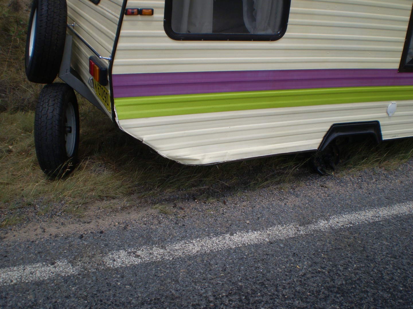

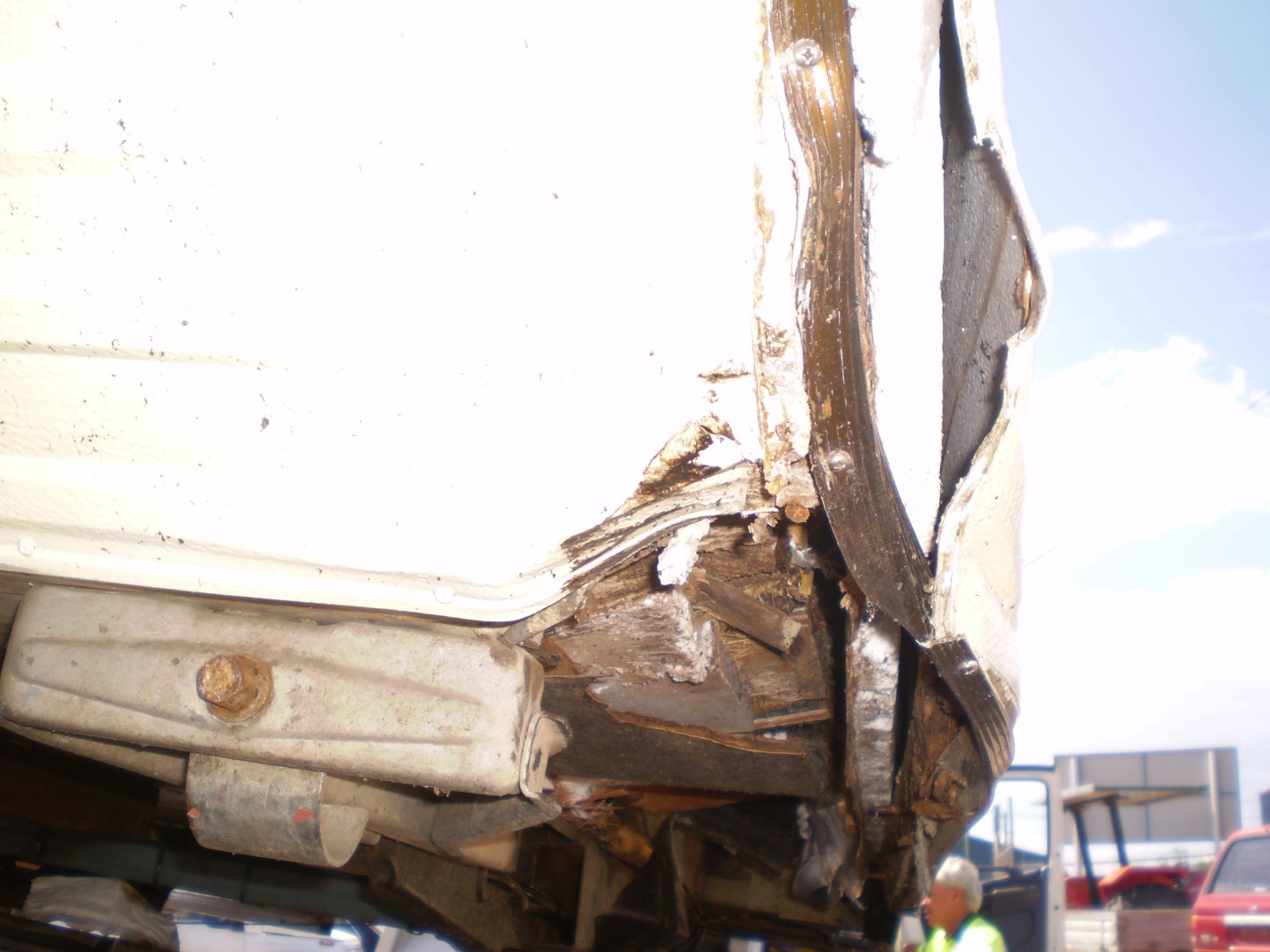

There is a good size hole in the floor just behind the wheel well and under the bed and as you saw from the pics
the panels at the rear corner have separated as well.. So I will have a job to do when I get home, as the insurance would probably write it off.
But Im not ready to part with it yet (unless it was a complete wreck)....It is my little project and I love it.

Not a pretty site,A bit of tlc and the panels should come back resonably well.
I always check every 20 kms after a wheel bearing check up,it is so easy to tighten it up 1 castellation too much or too little.
The good part was you found the wheel.
