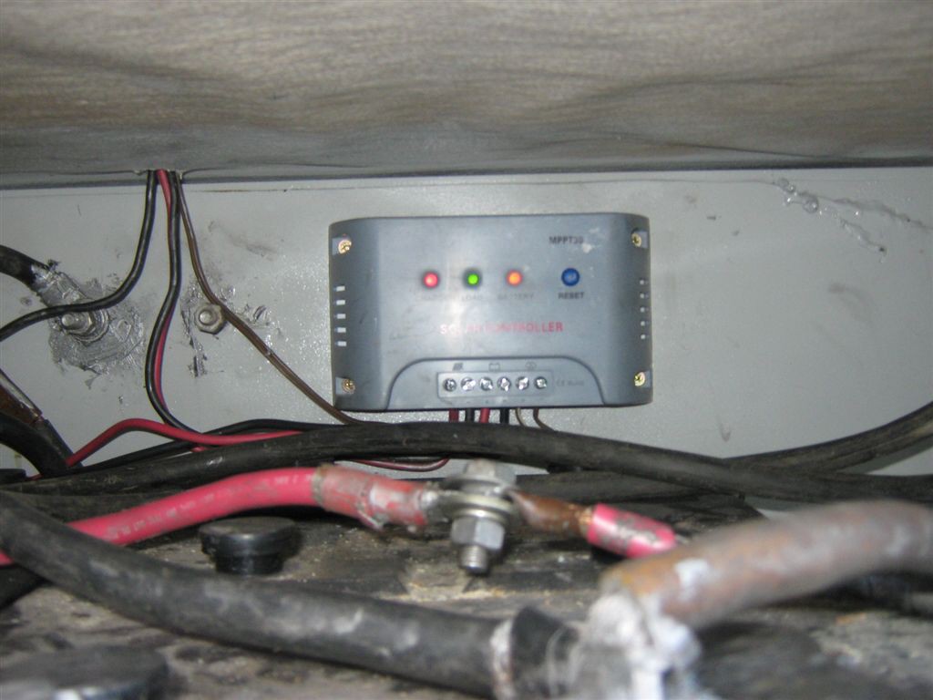

what does the reset button on the MPPT controller actually do,
Will it reset the controller to charge the battery more, or alter the charge in any way,

5. You don't say what wattage your solar array is, or the type of MPPT controller, so it's not possible to offer any thoughts on those questions.

The solar panels are 270 Watts, They are all working, I have tested them,
The Controller is a Wellsea 30 amp MPPT, Its Chinese,
It replaced my 10 Amp Morningstar one that got drowned,
All power has been turned off in the Coach, So it isnt drawing any power out of the batterys,

From memory the Wellsee 12v charger has a maximum charge voltage of 13.7v which is a bit lower than most and may not be high enough to set the upper bar on your meter.
This doesn't necessarily mean that the battery is not fully charging but it will take longer than it would if you were getting a higher input voltage.
If you get the 4 bars on the dash monitor, does it stay at 4 bars after you stop charging, and if so, for how long, and at what voltage does it extinguish?
Have you checked the rested voltage of the battery when you are only getting 3 bars on the meter?
Do you have specs for the meter?
I have no idea what the reset button does, it may be to reset the Ah info, or the overvoltage or undervoltage cutouts, or something entirely different.

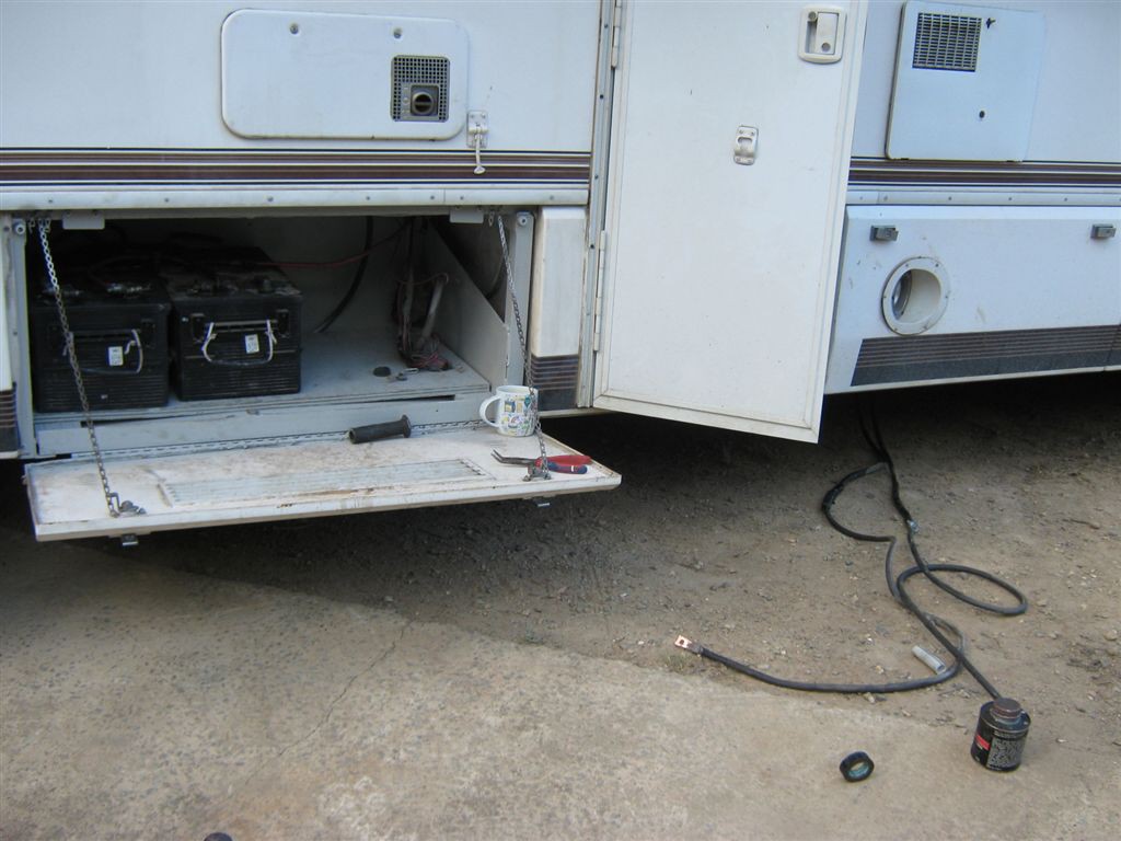

My B do you self a favor make sure that you clean up every exposed surface that is used for a connection..
- Any form of corrosion will act as a source of resistance..
Better to reduce the resistance to 0 than have it affect the current flow..

My B do you self a favor make sure that you clean up every exposed surface that is used for a connection.. - Any form of corrosion will act as a source of resistance..
Juergen
They are all spotless my connections, I use a bit of grease to allow the two surfaces to squeeze together giving full contact, Then cover them over with grease, Air tite,
This way I get years of trouble free use out of them, Thats the battery terminals Etc, all other electrical joins are soldered and taped,
Juergen
I hope the grease that you're using is highly electrically conductive, many are very good insulators and so will cause issues if you put it between the joints.
08:11 PM Feb 17, 2014
Mr B2 wrote: They are all spotless my connections, I use a bit of grease to allow the two surfaces to squeeze together giving full contact, Then cover them over with grease, Air tite,
Grease = grime, or in other words not the best in the way of cleanliness. Clean your connections before assembly. Connect up and tighten all joints. Then apply any protective coatings.

The grease is not conductive, I know that, The pressure thats applied squeezes all the grease out and gives a perfect connection,
The grease allows the two surfaces to slide together making one surface with out gaps,
Its worked for me with no problems for over forty five years, The only time I touch battery terminals or cables is when the Batterys are dead from old age,
Do it once, Do it right, Forget it,
Thats one of my connections laying on the ground,
I forgot to add, when I pull my connections apart after years of service, They are still shiny and clean,
My time is very valuable, I dont get paid if my equiptment breaks down, So I make sure it is totally reliable to start with,

Its now 3 weeks its been sitting there, Its still on the 3 Bars, I dont think it will increase to four bars,
It took 3 days to get the battery up to full with the charger, But that dont have a cutout on it, So I disconnected it before it was fully full, as soon as the four bars came up, shut it off, My charger will cook the battery,
As long as it charges more than I use, I am happy with it, Or bigger panels if it dont,

This is the only user manual I can find for the Wellsee MPPT30 - It may help in some way although it's in Chinglish!
