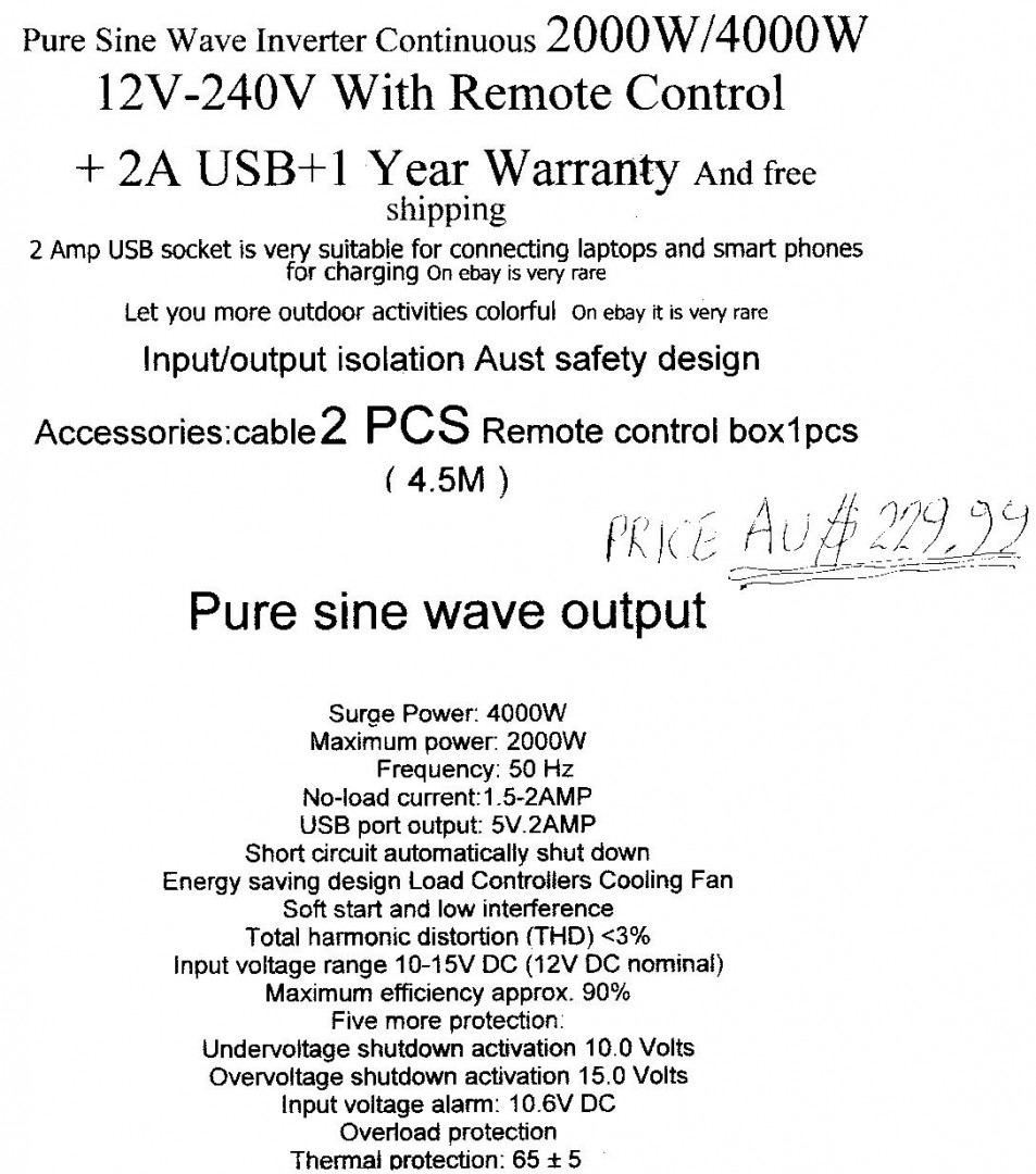

Hello to all you electrical wizards, i need some advise. I am in the process of attempting to setup a 12volt system that wiil free me from the grabbing hands of some of the sharks out there that have gained control of the caravan park industry. I know that description does not apply to all but theres enough of them to cause me to stop using caravan parks if at all possible. My immediate problem is i need to install a 2000W inverter. After a great deal of searching i have found one i can afford, but can i be sure its safe. The ad says that it is built to australian standards. Attached is the specs for it. My question is "would you buy it". Your comments please.
The quiescent current is a little on the high side, but many of the cheapies are around that figure.
They say Aust safety design, which may not necessarily be certification, they also claim source/load isolation, and the price is certainly OK.
They don't mention what the stabilised output voltage is, and some of these that claim 240v actually have no load V closer to 220v which can depress considerably under load.
Whilst the no load volts can often be tweaked, there is no remedy for heavy depression under load.
Send them an Email and see if you can find out a bit more about it.
Try to get no load and full load voltage info and see if they will send you a screen shot of the output waveform.

It helps if your warranty is covered in Australia like the one listed below is (from a quick search). Also a 100% feedback score. Electrical information - I doubt you'll get much from the seller as they are just middlemen.

Also ask them for the AUSTRALIAN APPROVAL NUMBER. & AUS Standard# it's made to!

You can be pretty sure that almost any inverter that you purchase for a cheapish price will be of Chinese manufacture.
The fact that you might purchase it from an Australian outlet, and that it may carry an Australian warranty in no way guarantees that it will be safer than its Chinese equivalent with just a different label on it.
I contacted an Ebay seller of a Chinese brand inverter called Powerjack some time back with a request for further electrical info Including waveform pics, and received everything by return email 2 days later, so some will cooperate if approached.
