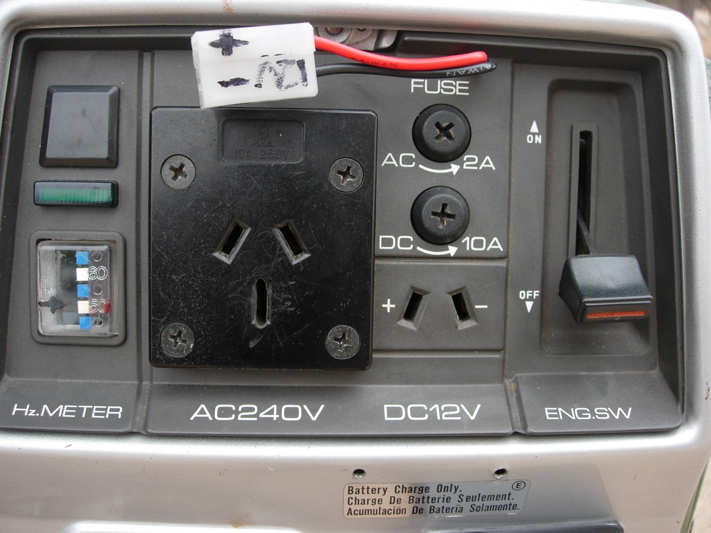

Bet its got the same 12V DC lead as this 1983 Honda EM500U generator which I still use. Hondas great offer many years later of $150 trade in on a new over priced generator wasn't taken up by me ( the tradein had to be working) Wonder what happened to the tradeins??
