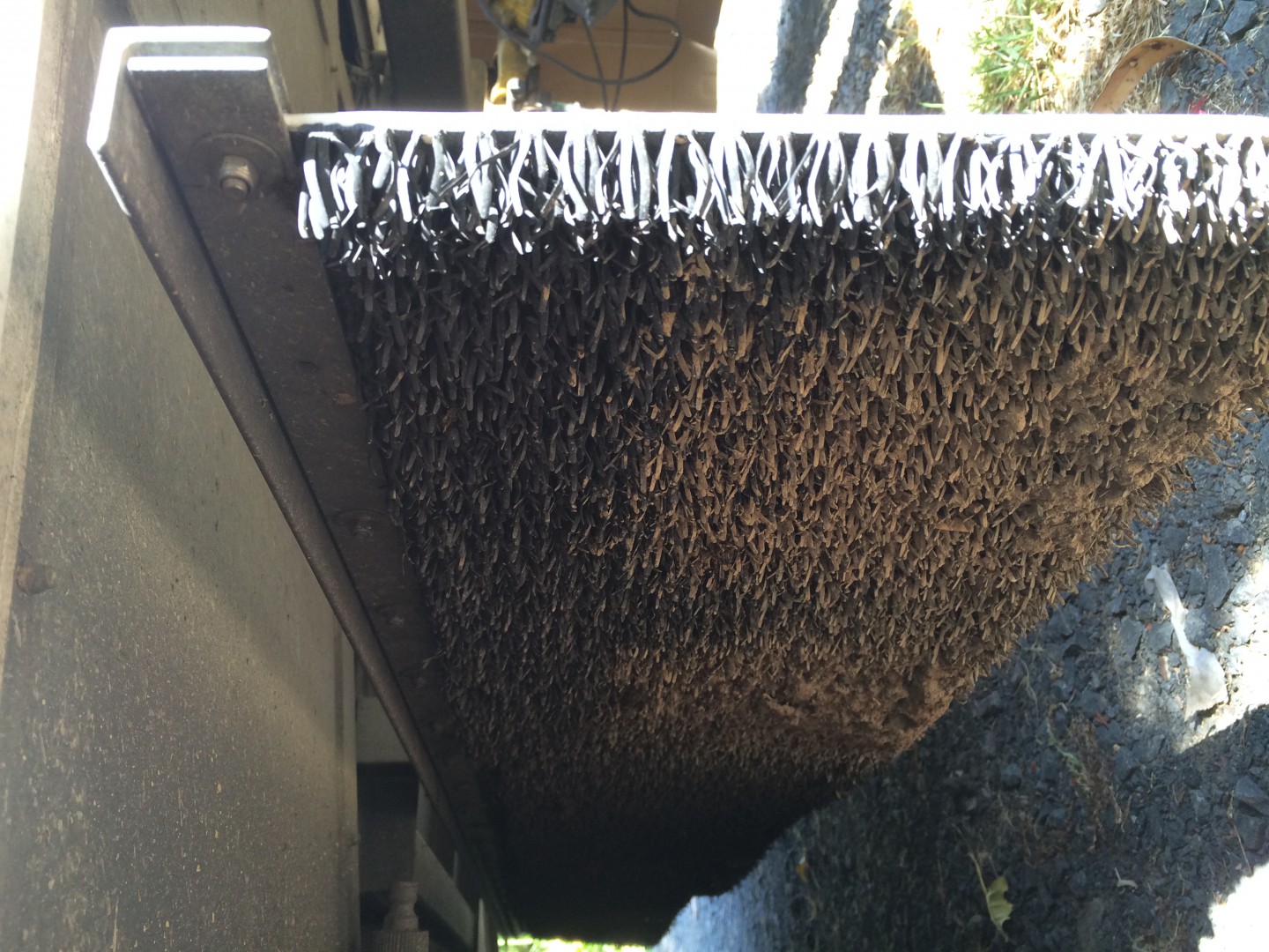

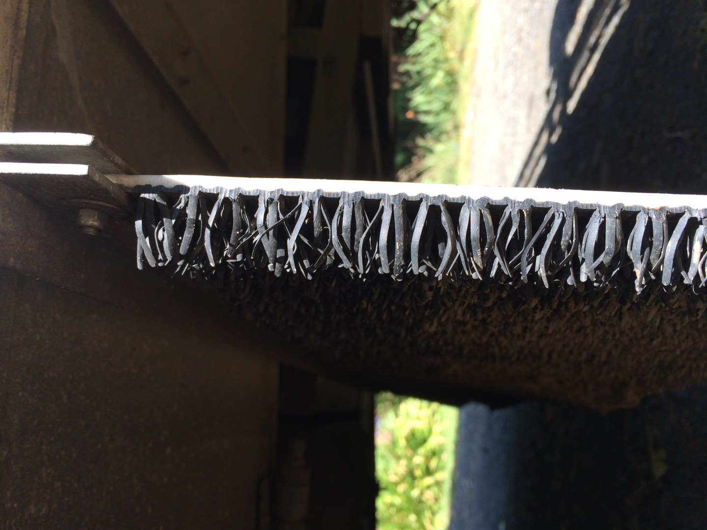

I also tow a Suzy behind a motorhome after towing camper trailers previously which were sand blasted using conventional stone protectors. While they are a lot more expensive than the homemade variety the Stone Stompers are the bees knees.
