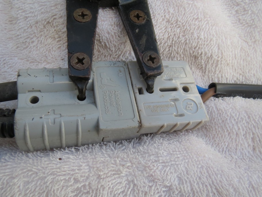

I'm probably the only one, but I find trying to pull Anderson plugs apart sometimes difficult especially if they are damp from overnight dew or slippery from the lanolin spray I use on them.

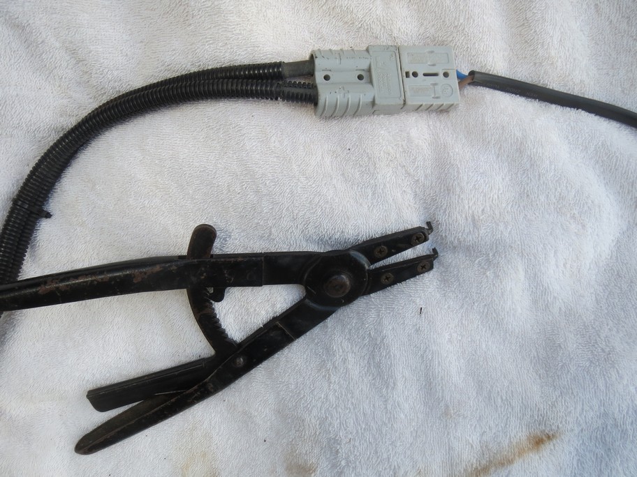

I tried those "T" clips but they felt wrong, so at the Toowoomba Swap Meet I found a pair of ratcheting circlip pliers which I figured would do the job, and they do.
Wouldn't have to be ratcheting type (which I've never seen before) - as long as they open wide enough.

Tried them and found they were too small to grip properly especially when you're bending over the drawbar plus if you lubricate the plugs with with vaseline they tend to get slippery. I suppose the positive of the T handles is that you cannot lose them.

The circlip pliers are certainly a good idea - except a jar of Vaseline is much cheaper.
Pics tell it all.
Good Luck
