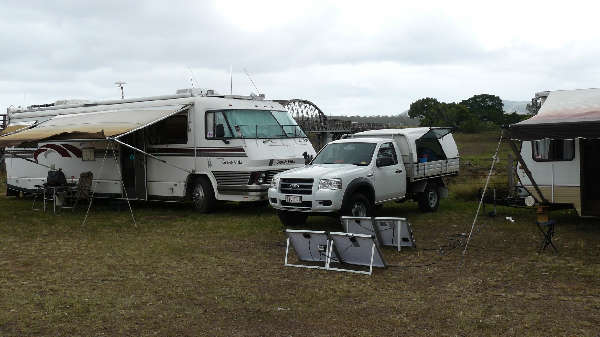

Do you know how low you were discharging your battery?
Do you have the space for more solar panels or batteries?
Is your existing panel fixed or portable?
What sort of solar controller do you have?
What electrical load do you have apart from the fridge?
Cruising Cruze said
01:04 PM Feb 2, 2014
Thanks Brian
portable panels both 80 & 120( By passed on board regulators ) running over 30 amp regulator
had an bit of sun he day before regulator told me fully charged
normal charging 2 phones and 2 android tablets and maybe an hr of news on the tv and a few Led lights ( less than 10 watt)
no idea how low battery gets I presume say from 1700 hr till 0800 when the sun is down times 4 amps or so 15 x 4 = 60 amp
Cheers John

Hi John , Ive got 2x 140w panels and 2x 105Ah batteries supplying fridge , freezer , led lights , tv etc simular to yours and I hope it is enough, depends where you are as heat effects the output of a panel by up to 30% so I installed an extra one to be safe.
As far as Generators are concerned , I bought a 4.4Kw Full Sinewave genny of fleebay for $520 and seems pretty good, runs all the gear, even the A/C .

John, you need sun for the solar panels to charge the batteries, but with no sun, even though overcast, light will still charge the batteries but at a slower rate. You say you found out last week when the weather was bad. If you had another battery you probably would have made it. I have solar panels totalling 235 watts, 2 x 6 volt 100 amp hour batteries and I run an 80 liter refrig. i don't have any problem. I'd suggest a second battery. .

After long thinking at my side
and talking over the problem with a few people
I decided to go for an small generator
so I'm looking now for an Honda EU10i
what is plenty to charge an battery
We advised Keith and Alice ( Kandagal ) last week to stay At Dickabram Bridge because we think it is
an nice place to stay .
we joined them on wednesday and we parked between there bus and an other mobile home
and with Keith's help ( I do need an hell of a lot more practice ) it was done in no time,
Thanks mate.
we had a lovely time there but we had no sun to speak of
Friday was a miserable day even got some rain
seen that we only have solar power we had to leave the battery was running low
(we use an 70 ltr fridge and freezer )
So now we looking for a solution how to over come this problem
to be honest don't know what to do more Battery's and solar or go for a generator
on the moment we've 200 watt solar and 100 amp hr agm battery,
with the plan of putting 200 watt on top of the Ranger and 2 battery's in the back
my gut tells me to get a small genny but wich one i dont know
Honda is out of my price range and don't like to get one of the internet
to much trouble if something go's wrong
SCA has one on the moment for $324 but it says nothing much on the net ( sine wave or not )
maybe some one can spread some light to the subject
Cheers John
