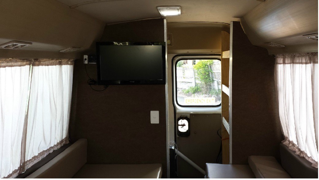

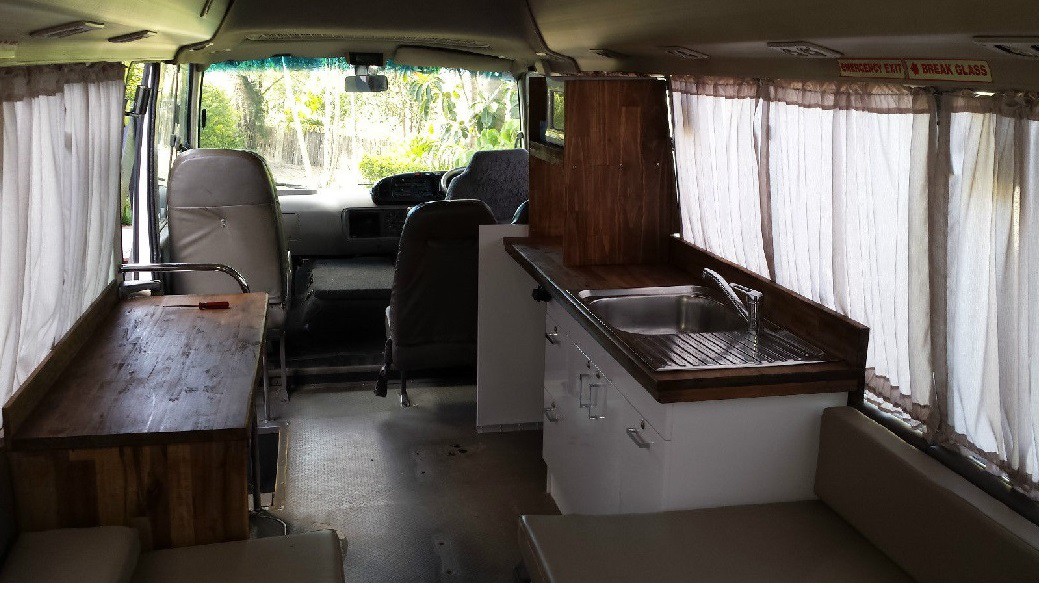

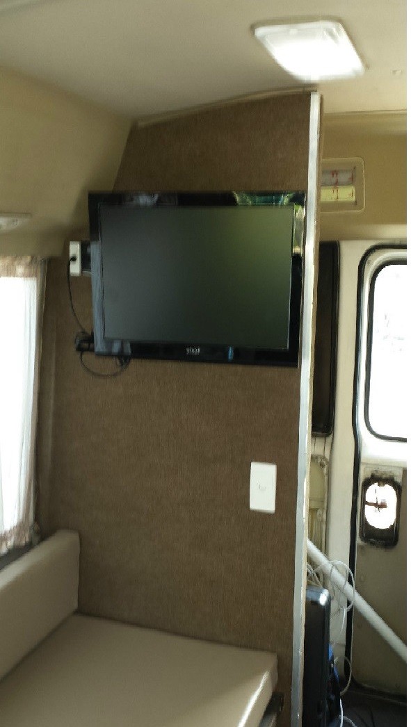

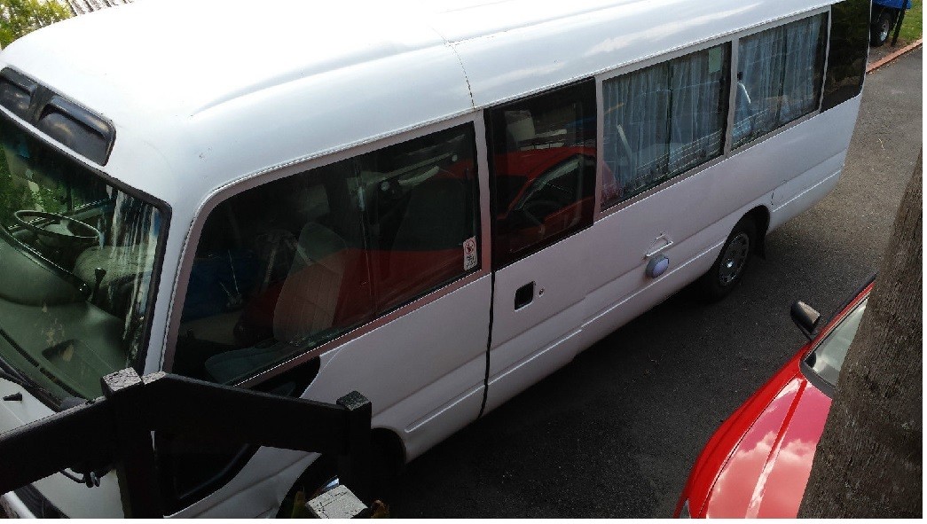

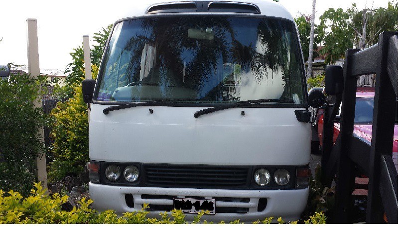

Ok Before I even get to the Build of the bus..
Here are some current Pick's of the Bus..
Here is the Front Profile of the Bus..
Top shot of the bus..
-- Going to paint this with Thermo shield Paint.. Before I install the Tropical roof of Solar Panels..
So there are the Picture of the Bus..
It's got a fair bit of stuff done already.. I'm going to tweak it..

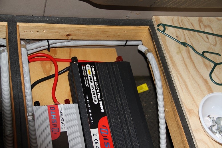

ALL of the Current Wiring has Been Removed as it was not up to My standards.. - There was actually a Few Thing's that could of caused a serious problem.. --> Have to Laugh.. they installed a 12v 2500w cont 5000w surge inverter to run off a SINGLE 100Ah Battery. >> Issue with the inverter is the fact that the cable to run the inverter where not up to even covering the 2500w Load.. 208A's

In this Pic. the Red and Black Cable Going to the Charger on the Left should of been used in the inverter circuit.. but due to the nature of the person doing the wiring. they thought they would use them for the charger..
- also There was no form of Protection in either set of Power Cable..
If an issue had of occurred, then the Poop would of hit the fan royally.. No way at all to stop a critical failure[Fire situation..
The system was not designed to be able to free camp without the use of running a Generator..

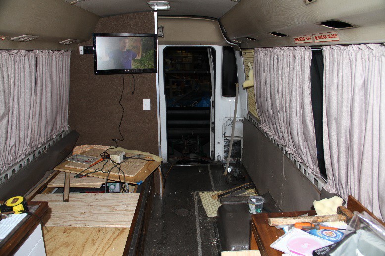

Got Back from the Gold coast Sunday Night..
Started to have a Look at the layout of the Bus and Modify it to my own specification's..
- Now understand I'm building this Bus to be able to run all the good stuff, with out hooking up to an outside source of Power.. Solar @ this stage only.. Possible wind Later on..
What I have done so far..
- Removed the Double set to allow me to move the main Kitchen Bench towards the Front of the Bus.. The Location that the previous person was going to use for the fridge is Gone.. I'm using a Standard Caravan fridge... Small Domestic for me..
- so the Kitchen unit is Relocated..
- I have to get a new sink as the one supplied was a small unit sink.. about 400x800mm way to big for what I want to do..
- The Narrow Bed is Gone... Which Adults are comfortable on a narrow 2" Bed.. [Not Me]
- The Other bed has been Moved so it's Closer to the Front of the Bus.. [Still Straddling the Rear Wheel arch but hard up now..

Narrow Bed Removed, Rear shelving Removed..
- the Aircon duct on the Left of the Picture has Been removed to allow for installation of thing's Like a Shower.. Some Overhead Storage for Light stuff..

they are actually sitting in the garage right now..
I'm in the Process of customizing my internal design..
- I have laid out the area where I'm going to place the 5 water tank's..[Yes 5 tank's]
- the tanks shall be under the main Bed..
I'm really think'n of painting the Roof with a Thermal shield paint[ doing the job myself with a brush and a roller..]
I'll post some more Pictures Tonight.. going to start to make the main bed frame..
Psst went down to the range over the weekend with the bus..
- I think the bus is going to work out.. With only the basic's in it..
A Place to sleep..
A place to setup the Laptop..
Access to 240v.. to run all the stuff..
I spent a comfortable time..
- Definitely got to put a sign on the back.. Slow Moving Vehicle..
The coaster is not the fastest thing, but then I like to enjoy the sight's when I travel around..
Juergen
