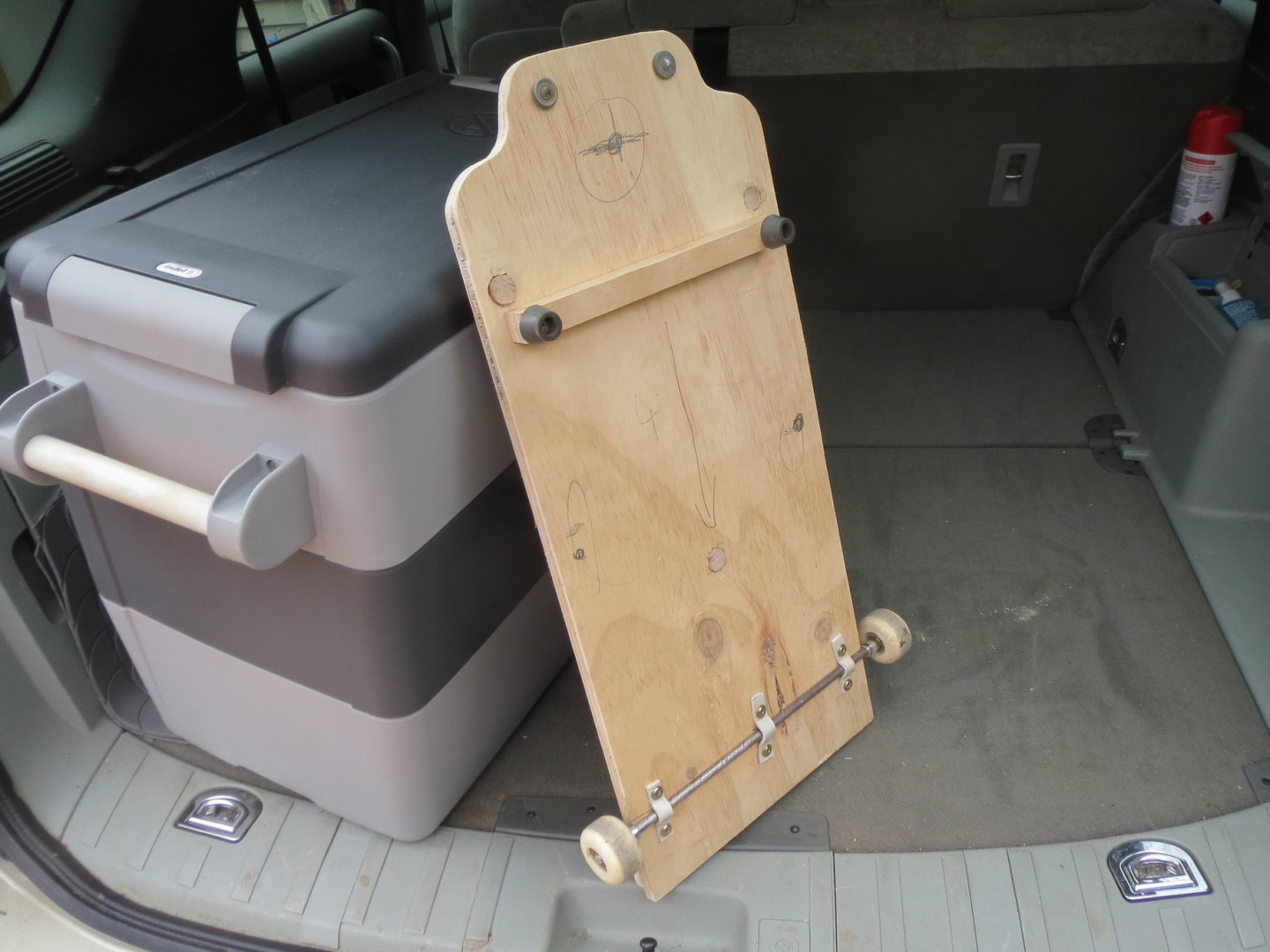

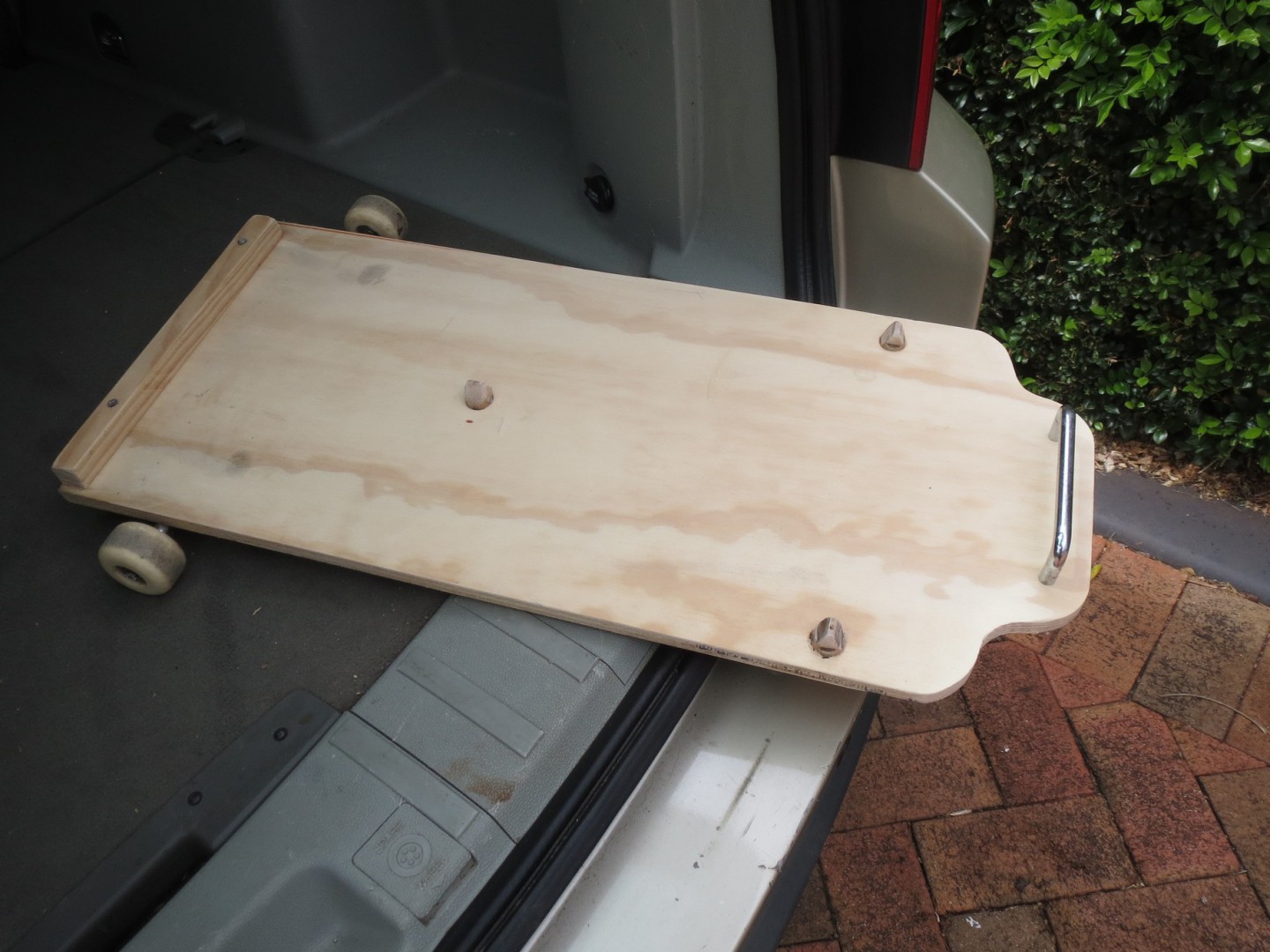

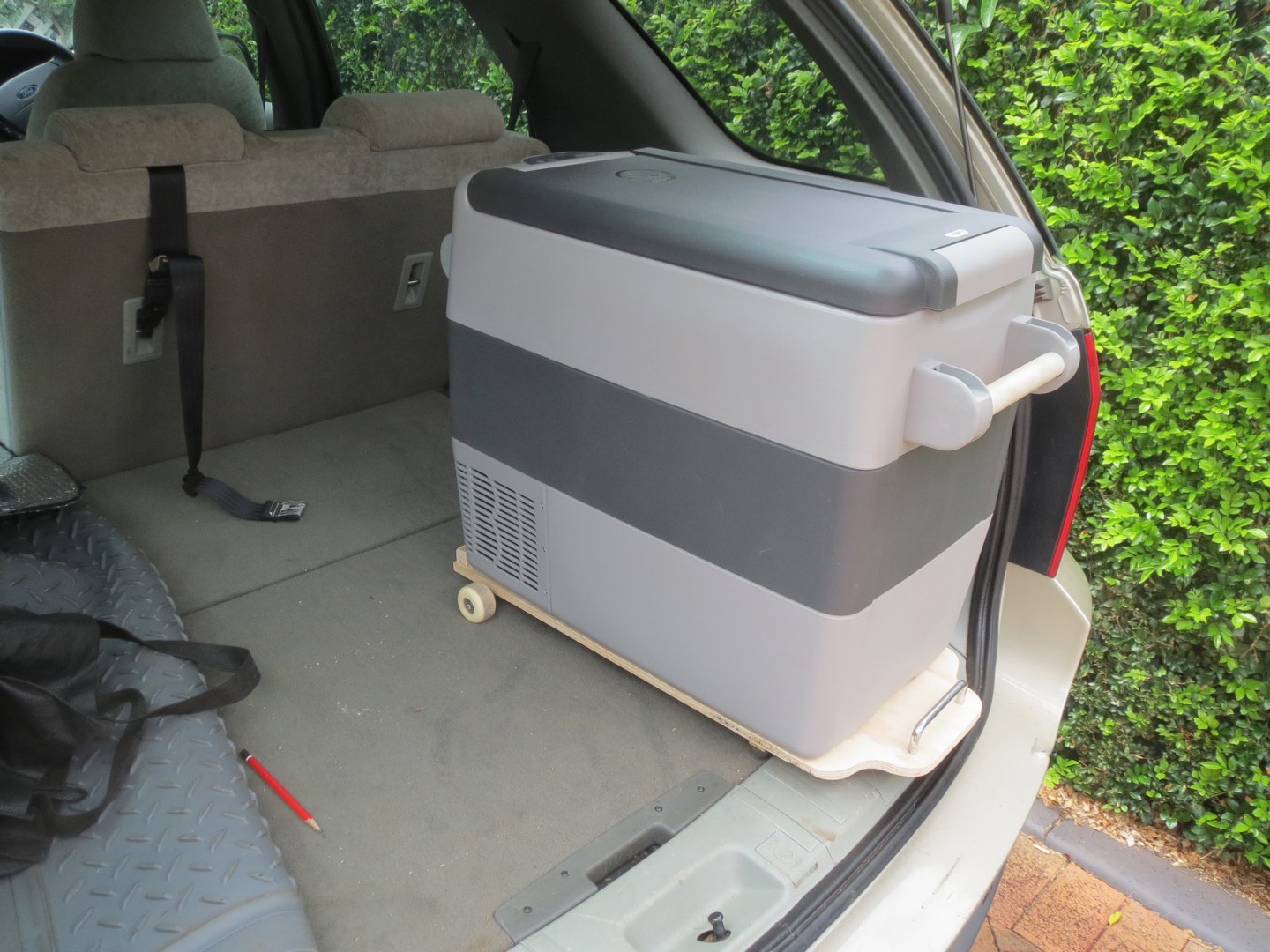

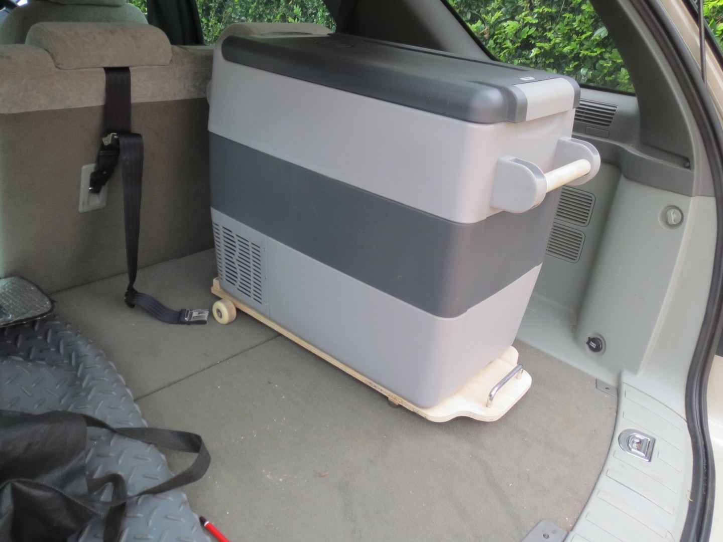

My new fridge will be living in the back of the Territory and due to the lid design, it is not possible to raise the lid high enough to remove the basket for loading/unloading. I had a look around for a fridge slide but they ask from $300 and up so that was not on for me. The actual slides alone cost upwards of $100.
Anyway, figured I could make one for nothing with a piece of old ply, some old skateboard wheels, handle, 2 rubber feet, a short length of 5/16 rod and a few screws. Design is simple and it does what I need which is allow me to pull the loaded fridge towards me about 500mm with ease.
Basically it's just a plywood sled with an axle and wheels located under the heaviest part of the fridge and at the other end I fitted 2 rubber feet to stop movement on the carpet. I'll also run a strap back to the seat to prevent it moving too far. I've fitted some pieces of dowel to locate in holes under the fridge....this positively locates the fridge on the slide.
Pics are attached and should explain everything.
