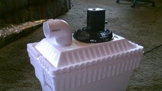

I came across this idea on youtube and though it may be worth a try in the van as we don't have a generator to run our air con on hot days while free camping.
how easy is this, and in regards to space during the winter just toss the box and pick up another cheap one when it starts to warm up again.

Item that is powered by a 12/24 volt system called a RAPID COOL. Cost about $300 about 12" cubed. Works like an evaporative Air Con. I used it in a truck over a couple of Melb/Sydney Summers. Brilliant. Put real cold water in it does work much better but even with tap warm water was excellent.

I could not buy an esky ( Foam) anywhere in my area so opted for a foam box from Fruit Shop. I then purchases a 12 v fan from super cheap but I am not getting a good air flow from this fan. Plenty of frozen stuff in the box.
So what am I doing wrong?
The PVC outlet pipe is around 2 to 3 inches in width.
Problem is not sufficient forced air flow from fan.
Help would be great.
Jay&Dee

Jaydee: - According to Native Pepper who has three of these working, the cooling principle works.
If the outlet pipe was too small it would cause back pressure causing the lid to lift off.
In theory what air goes in equals the same amount that comes out.
The first thing I would check would be the actual fan blades. - Are they delivering air and not extracting it. If extracting it you will have to turn the fan blades over the other way to the blow position.
The second thing I would check would be the fan is fitting flush into the lid so no air is escaping past the sided of the fan.
The last thing if its a variable speed fan - crank up the speed to high
If that doesn't work is the fan too small for the job?
I'm sorry I don't have a miracle answer, its all process of elimination.
Good luck and I hope you get it working.

Hi John... Well I finally settled for a decent air flow fan from Auto Barn. Cost was $40. I have installed the fan on the end of the box and now I am getting a much better air flow. Placed frozen items in the box and the air flow was nice and cold. The thermo. was 32 degrees and the cold air flow bought the thermo down to below 20. Now I will admit the the thermo. was inside 30 cm from the outlet. If it only works on a hot night it will be a blessing. Our van has a sliding door to ensuite and a folding door to bedroom, so we can isolate the 2 main areas and hopefully gain some nice cool conditions. Also so we have a 175 dual door fridge with a rather larger freezer compartment. So all should be good.

I have made up a unit using a Broccoli Poly box from fruit shop.
I reduced the size by a third by cutting and gluing two new parts. Had to make a small adjustment to the lid.
Then purchased a 12 v fan from Auto Mart for $40 and installed in one end of box with hole in other end similar to above mentioned instructions.
It works great. Placed frozen bricks and frozen bottles of water or anything frozen for that matter on racks to allow air flow over all items.
In our van we can close off the ensuite and bedroom to A/C the kitchen dining area or conversely we close off the bedroom and then A/C the bed room. both small cubic areas.
Also could hang a wet towel in front of the air flow from the box, which could give added cool air????? or would it????
We will road test later this month and let you know the outcome
I forgot to add that you can place cold drink cans in the cold melted water and free up some fridge space.
Also the temperature of air coming out can be regulated by the variable fan speed.
I'm definitely going to knock one up and road test it.

Ok, Further to the above.
I finally found where this post was.
