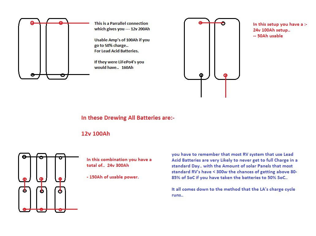

SnowT said
09:25 PM Jan 22, 2014
Ok here some pic's for you..
In nearly every RV out there, they do not have enough solar to recharge the batteries that they have.. especially if the same batteries are taken down to 50% SoC..
The best you can expect is to get your batteries to 85%.. So the best usage you can expect is a system that get's to 85% and gives you 35% of the total Ah of the system..
- So have I thrown the Cat among the Pigeons..
If you only use a small amount of power, like a few light's etc.. you should be fine.. The minute that you start to dive deep into the battery charge, don't expect to get a full charge unless you can hook up to an external power supply and charge it that way..
All of the above is respective of Lead Acid Batteries, no matter what form they come in.
Thanks SnowT, One drawing is worth 1000 words , spot on. My own set up in my caravan and every thing runs off 12 Volts ( except the micro wave and air conditioner ). We traveled over to Victor Harbour for Xmas last year for a few days of R&R ( beer ). My caravan has 2x 120 Watt solar panels, 30 Amp controler and one 200 A/H deap cycle battery, sealed. I only got the after noon sun as we were parked under a big tree at the caravan park, and for a test i turned off the built in battery charger that came with my caravan from new. Running the two 40 Ltr Engle fridges (one as a freezer ) + the rest of the caravan load, eg 12 Volt led lighting, tv and a small 300 Watt pure sighn wave inverter for the vast sattilight receiver. the battery lasted 2 days befour the low voltage cutout, cut in ( battery voltage down to 10.9 Volts ) and disconnected the load from the battery. This battery was second had when it was given to me and had, and several others, had been replaced off a house boat that was on perminant hire. I have had this battery for now on 5~6 years and i was even able to carbon pile load the battery and still came up to about 95 % capacity, ended up sinking 650 Amps from the battery for about 20 seconds ( carbon pile started to smoke ) but the voltage at this point was still 11.9 Volts.
I would love to know how the battery would have held up IF i had more sunshine or had not been in the shade as mutch.
