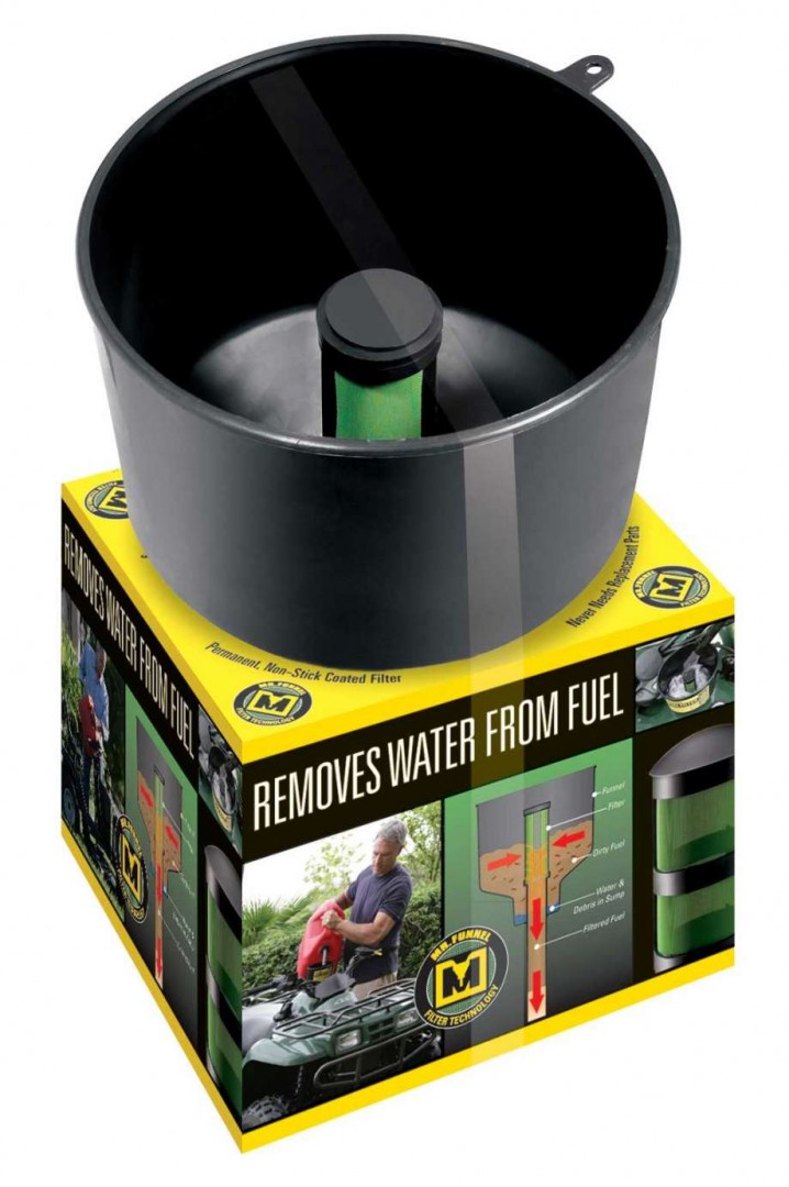

I'm going to get one of these when I finally get going. If I remember rightly, only about $20.00.
That looks like a funnel with a strainer, can't use that at the servo.
Sheba said
08:37 PM Jan 17, 2014
Why not JC ? I had planned to.

justcruisin01 said
08:54 PM Jan 17, 2014
There's a major flow difference between a funnel with strainer & a driveway pump, the pump is under pressure & funnel is gravity ,you would have to fill so slow to avoid spillage that it would not be worth the effort. I can just see the driveway rage comming on & possibibly the servo attendant would put a stop to it.

ST391GQ said
11:35 PM Jan 17, 2014
I have used one at a servo on a fair few occasions now....but all except one time were at the servos in outer locations ( Marre..William Creek etc).
Have had no problem with any station as yet...and the look of surprise at one place when they saw the crud that the filter separated was priceless !
I do however use the biggest one available (the one with 2 filters in it). these are supposed to have a flow rate of about 40 litres per minute...so some control on the handpiece is needed. I reckon that on 2 occasions now it has saved me grief...one at a servo...and one time out of my own jerries. Still not sure why my jerries had water in them....only thing I can think of is condensation as the fuel was in them right from home through the high country to the upper Flinders. We had some time of heavy rain plus cold days and then hot ones...so maybe it was condensation....will never know for sure tho.
IMO...these are highly recomended ...speshly if you travel and refuel at places like some of the more remote stations and towns etc.
Cheers Keith

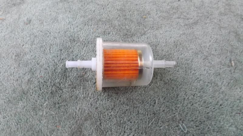

We have in line throw away and cleanable filters before the main filter and iP. The throw aways are cheap and collect any water as well as any junk, the ones you can clean are good to but of a higher micron. Only change the main filter once a year and are always pretty clean since using the in line filters. I see it as double safety, got the idea from when driving road trains, we used them all the time as the quality of the fuel by the time you got it in the past, was sometimes not that great. Much easier pull out an in line and change it quickly, than have to remove the main and change or clean it. We also had water traps, particularly when in the rainy season.

03_troopy said
07:15 PM Jan 20, 2014
Native Pepper, can you post a link or pic of the inline filters you're talking about please? Sounds like a good idea.
native pepper said
08:14 AM Jan 21, 2014
You can get them at super cheap for $2.99, or slightly different at repco for about $4

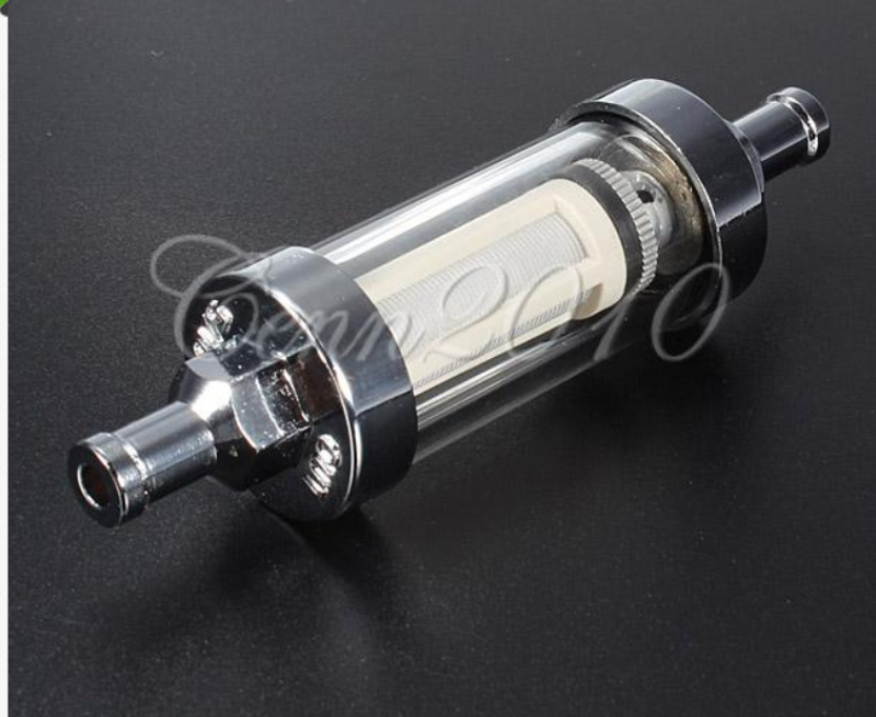

This one is cleanable and $8 from china
