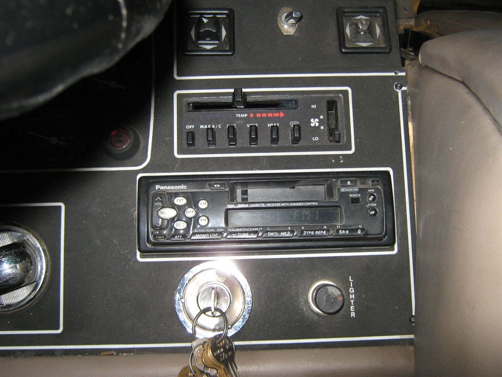

Got the 8 stack CD player installed and almost working, I stuck the CD stacker in before the power was on and its stuck in there, Radio works,

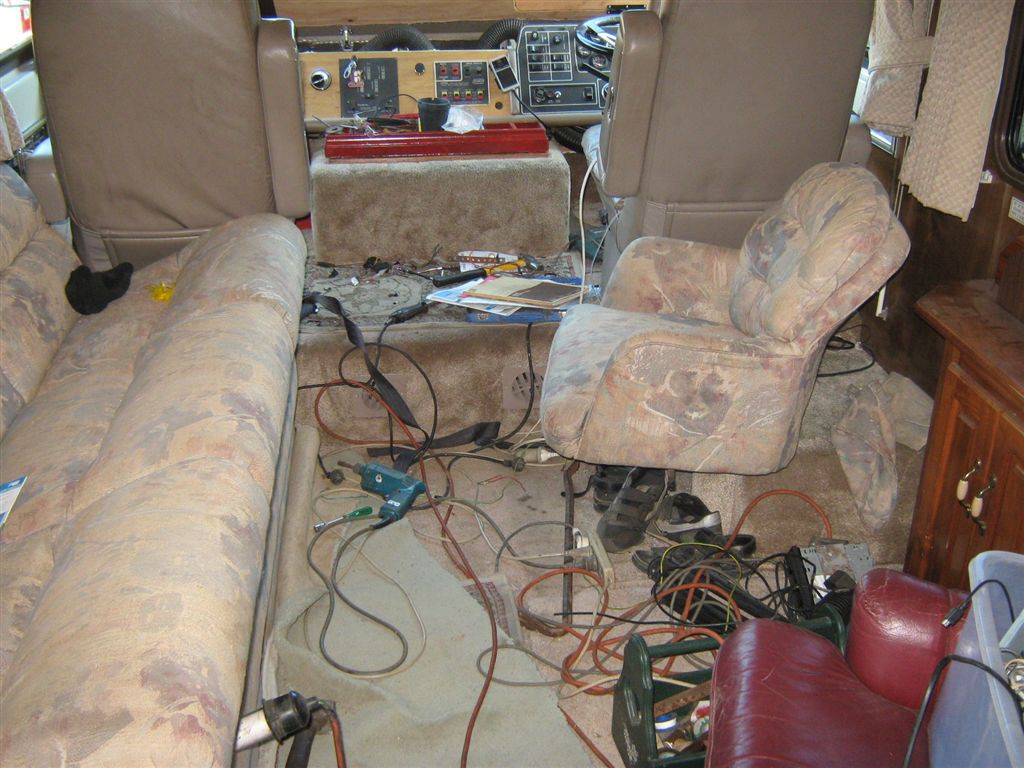

The wiring is a huge mess, But I am slowly working my way thru it,

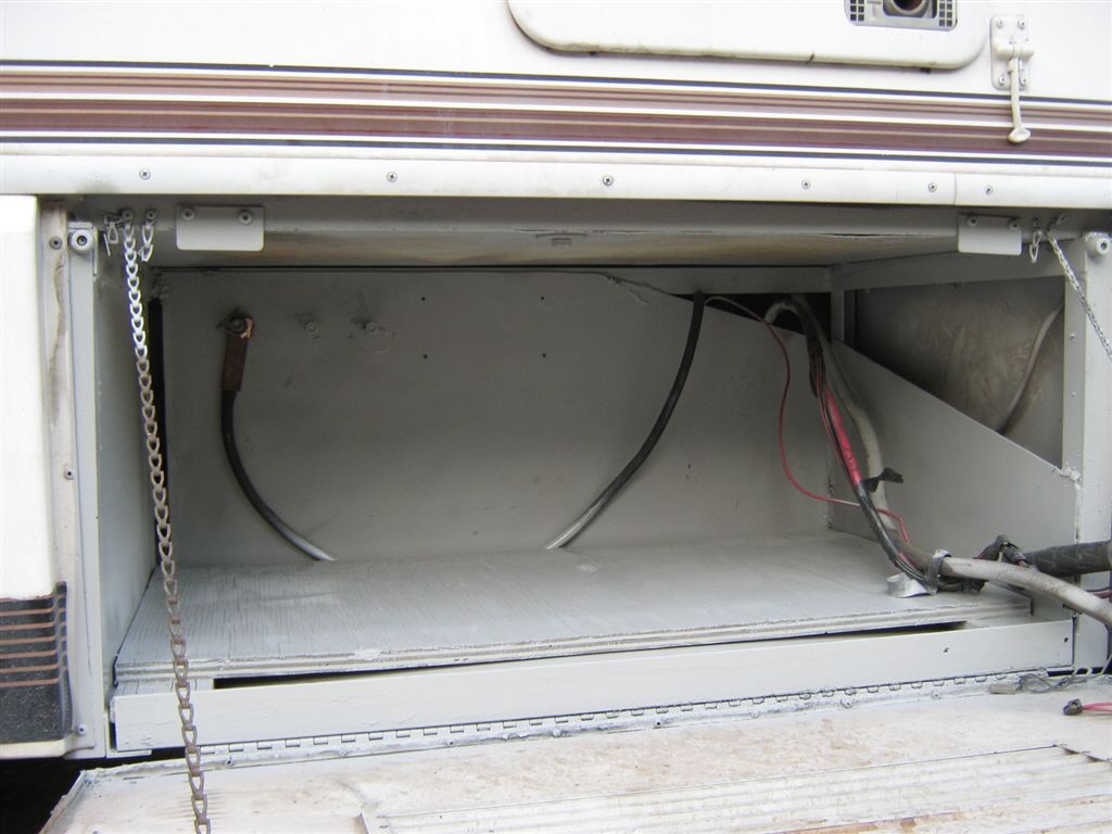

Pulled out the big gas tank and made a carrier for the new Swap and Go Bottles I put in there,

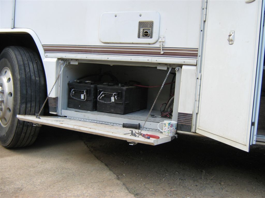

The Genny bay is now my battery Bank Container, 2 8D's and four smaller ones,

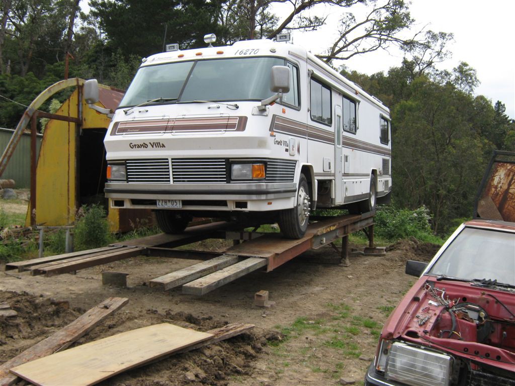

New Ramps to sit it on and work under, Makes life easy,

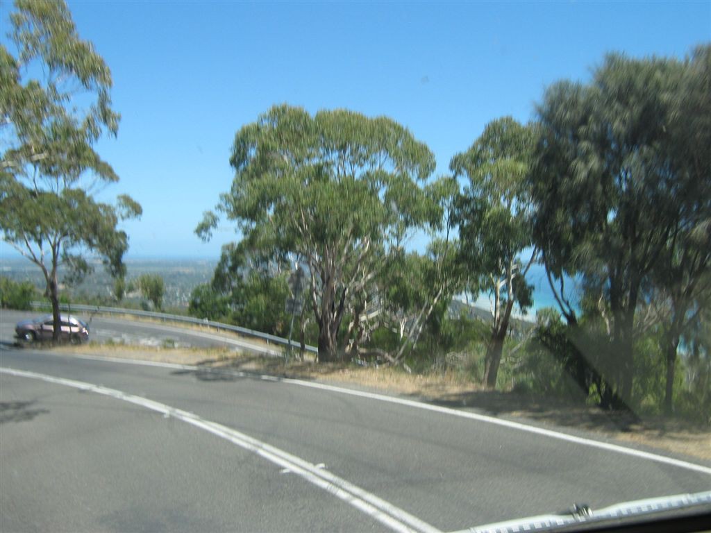

Took it down to Hastings and then down the beach, Balnarring, Point Leo, Those roads are Skinny, Cant get near the Beach, Ranger, You cant park there, So I ended up at a little Beach a bit further down the road, ARRRRRGGGGHHHHHHH Its down this steep road with a Hairpin at the bottom, I had to back up a few feet to get another swing at it, to get round the corner, Same going out,
Stayed overnight at the Beach, Nice Spot, Then drove across to Arthurs Seat, Damn it, I know the road, Its only short sections of steep road, This is the perfect time to find out how well it handles steep hills coming down,
One hair pin to the left, I had to back it up and get another swing at it, At least the cars were understanding and gave me plenty of room to manouvre around the corner,
Put it in First Gear and left it there, Magic, The lockers in the gear box work extremely well, I only touched my brakes a few times, Less than if I was in my car,

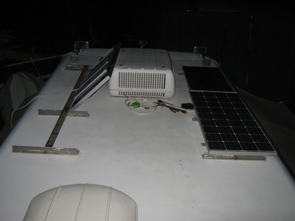

The Solar is Brilliant, I wasnt really worried about the lights being on, Etc, I wanted to see how much we used and over how long it took to get down,
Its more than capable of putting out more than I can use, Its back up to 3/4 full, so another couple of days of sun, It will be fully Charged and will stay that way, The Coach Battery is always fully Charged from the motor, and thats all the Coach battery does, Is starts the Coach and ouside lighting while driving, Head lights Etc, 120 Amp Alternator, Keeps it Charged and also whacks the excess into the House Battery when driving,,

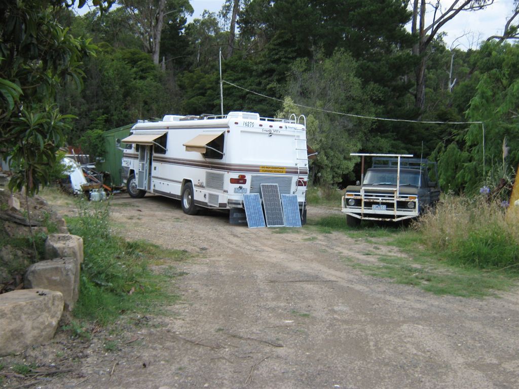

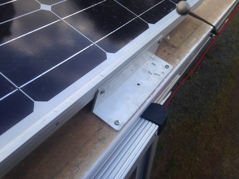

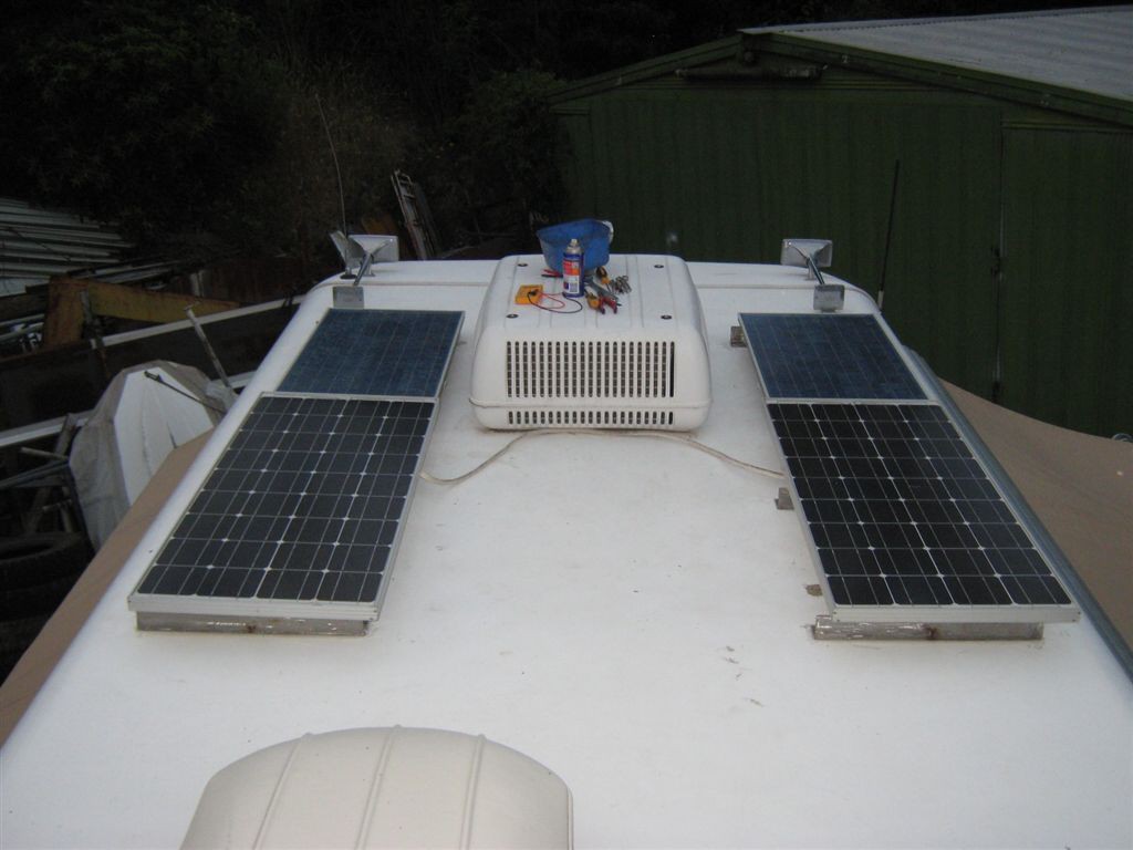

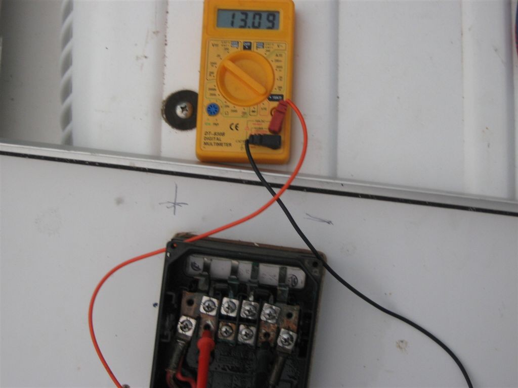

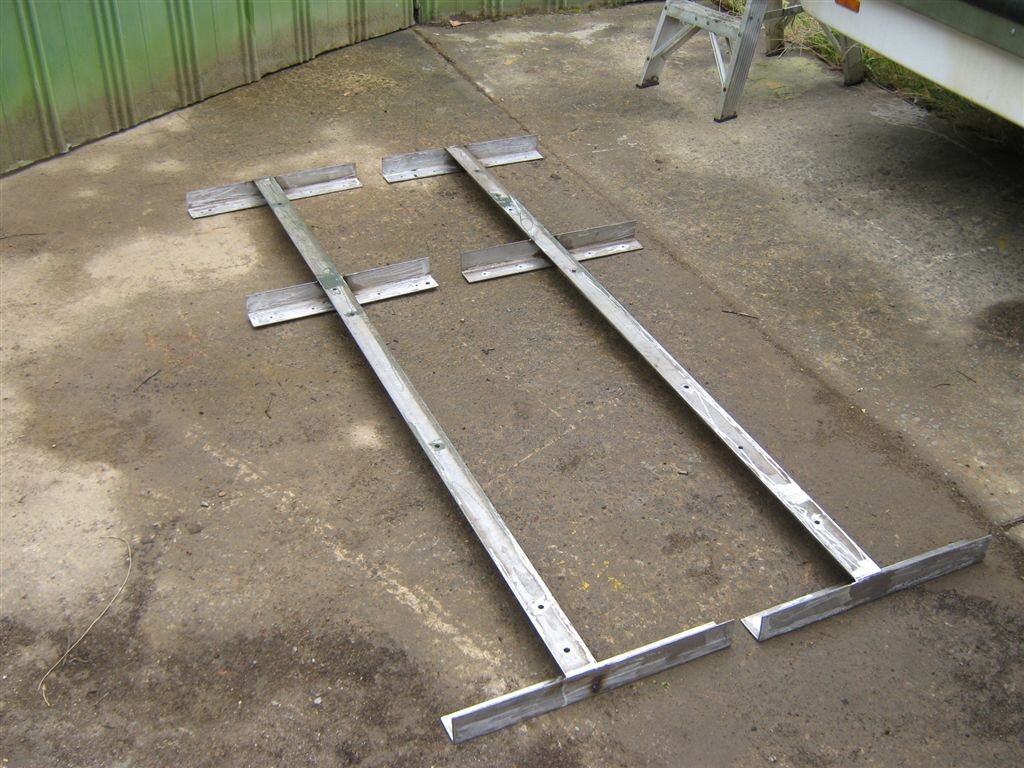

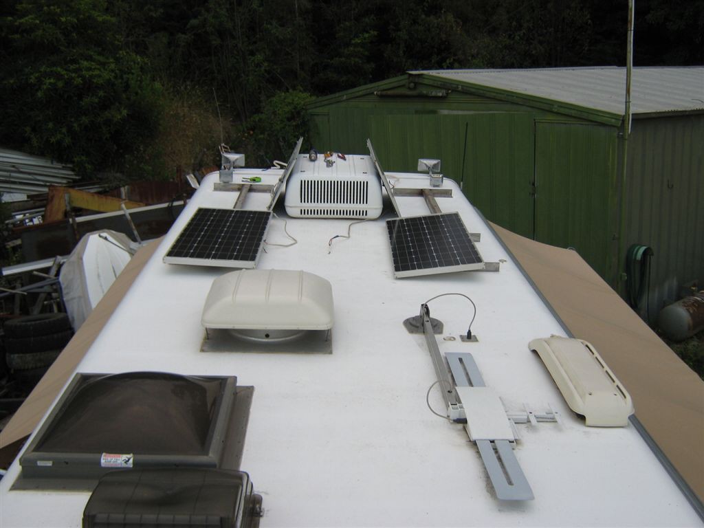

Began attaching new 200 watt panel to the van roof today. When I have it sorted I will use the Sikaflex 11FC white with screws and pop rivets.

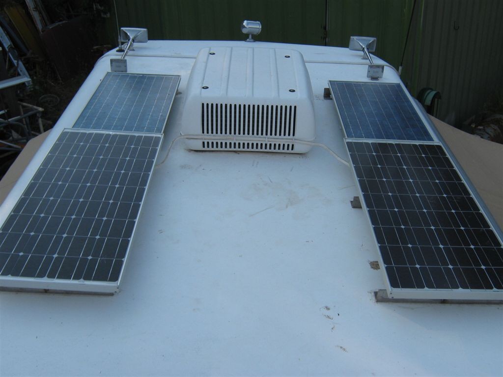

Bugger this, its too expensive, The Genny, I am going Full Solar, I have my boats Solar sitting there doing nothing,
Its now in my Coach, Hahahaha
No 240 Volts, its all 12 volt now, and its cheaper than 240,

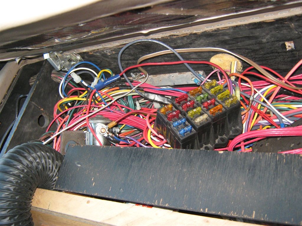

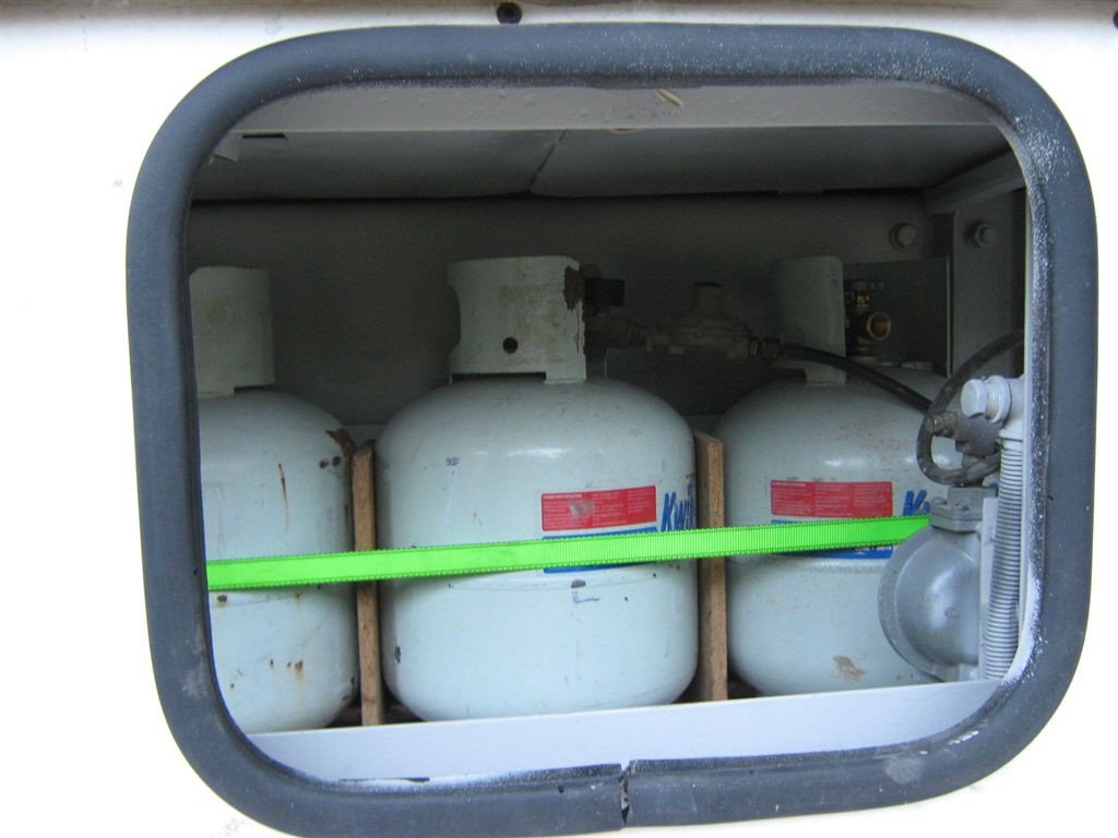

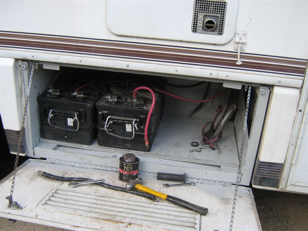

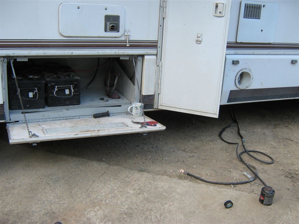

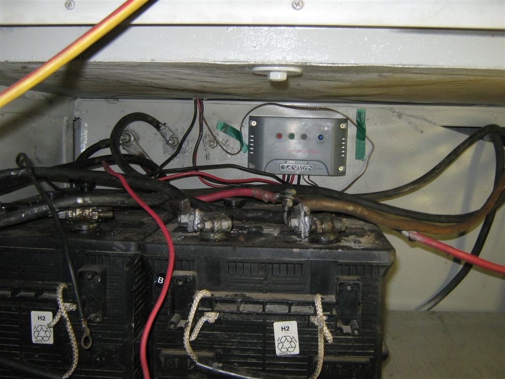

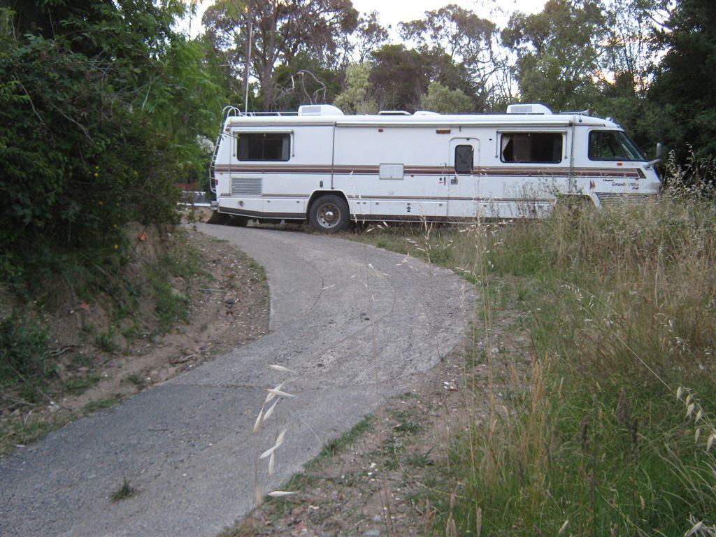

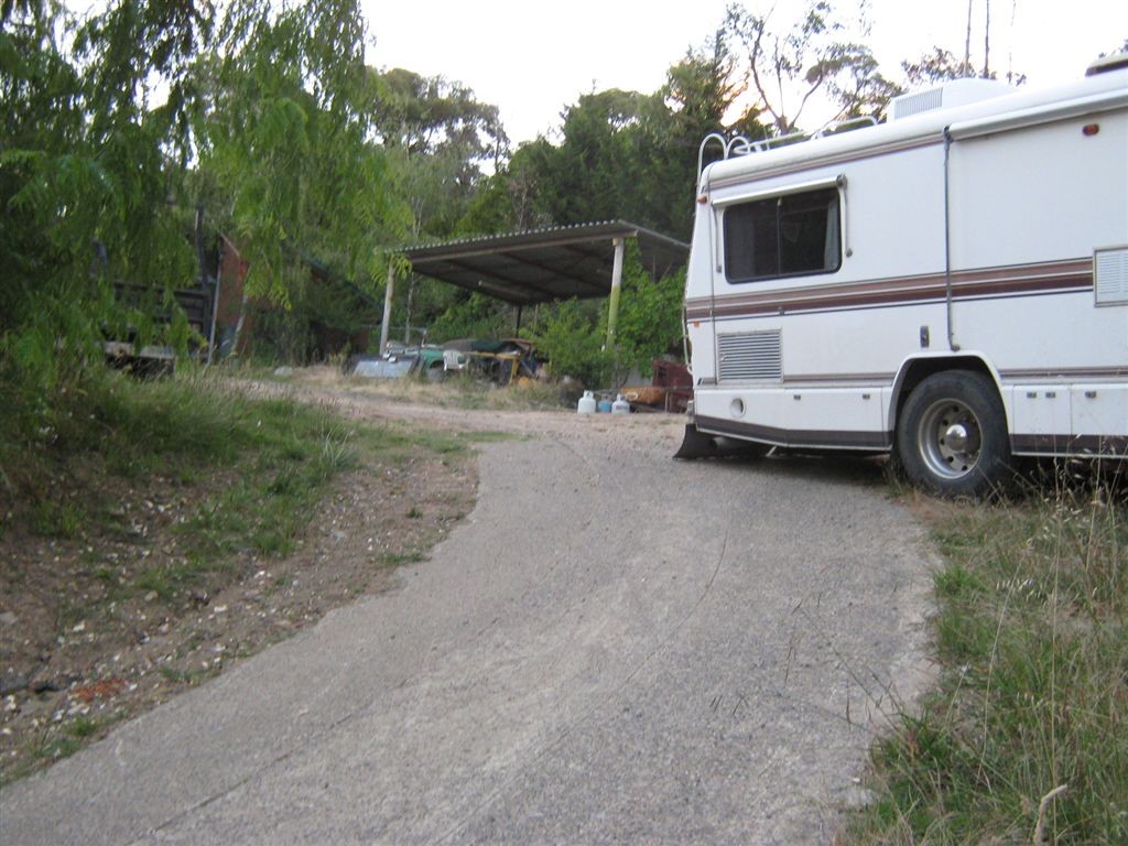

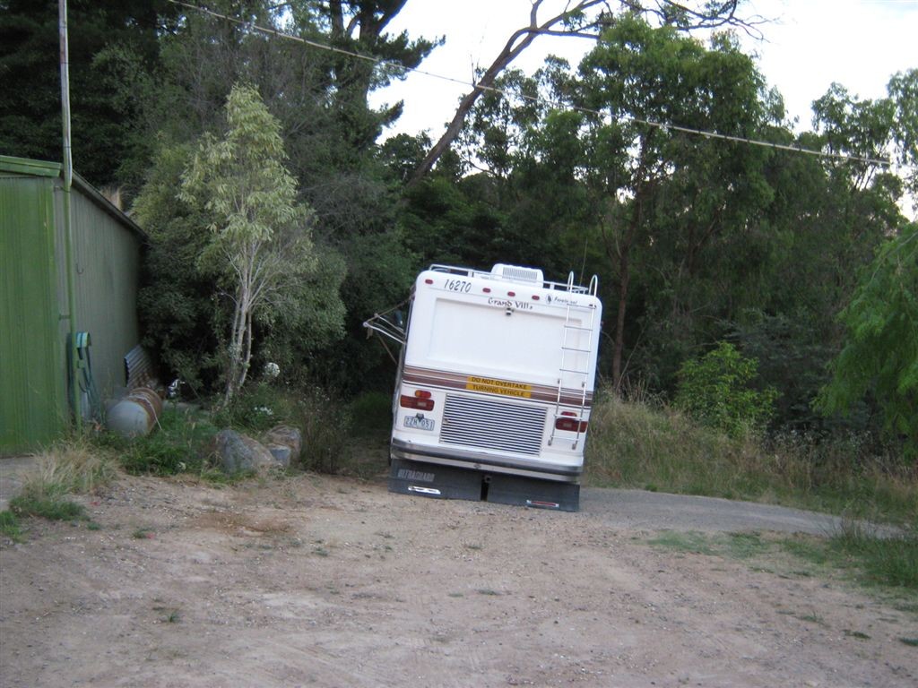

Trying a new parking spot, Nah, It dont fit there. Hahahaha

All installed and working,
Every thing looks Crap when its being built,
A bit of paint splashed on when its finished, Makes it look like a brand new one, Hahahahahaha,
It all takes time,

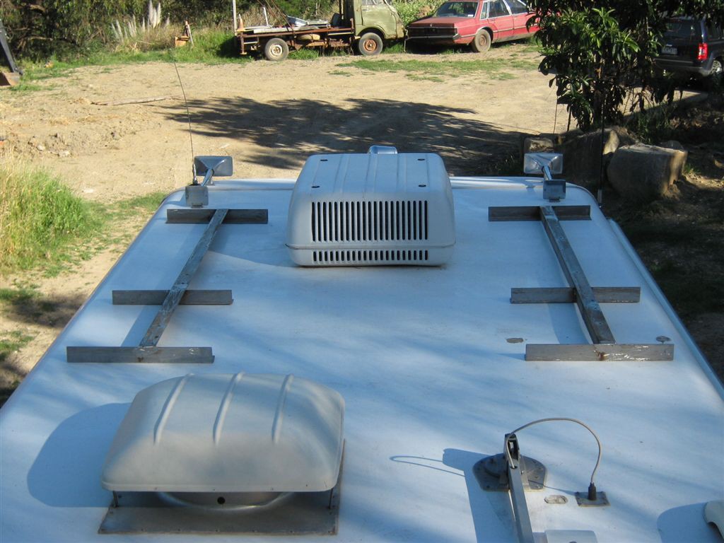

Between the Heat and the Rain, Its almost done, I wont go on the roof in either Hot or Wet weather,

Its almost there,

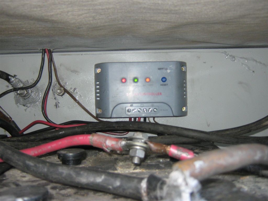

Moved the Battery bank, wired up the Solar Panels, Connect in the morning, Daylight only on the roof, Especially playing with Zappo,
And to finish it off, Its now all up and running, and everything works,
I cant take it and live in it any where now, In comfort, Hahahaha

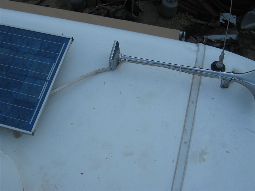

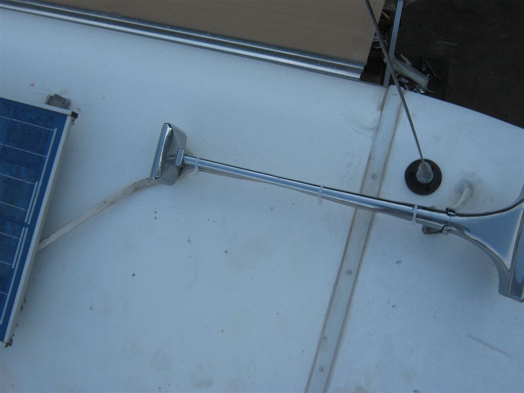

And the roof penetration, Thats all Folks,
