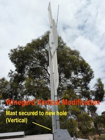

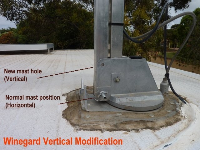

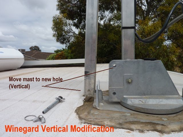

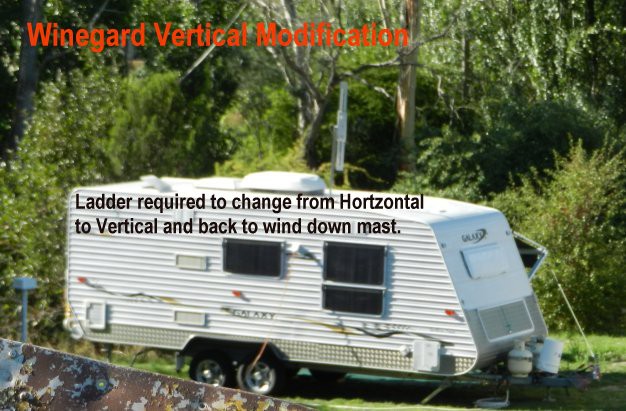

Winegard modification to allow the antenna to be set in the Vertical position. Note: Ladder needed to get access to the caravan roof.
