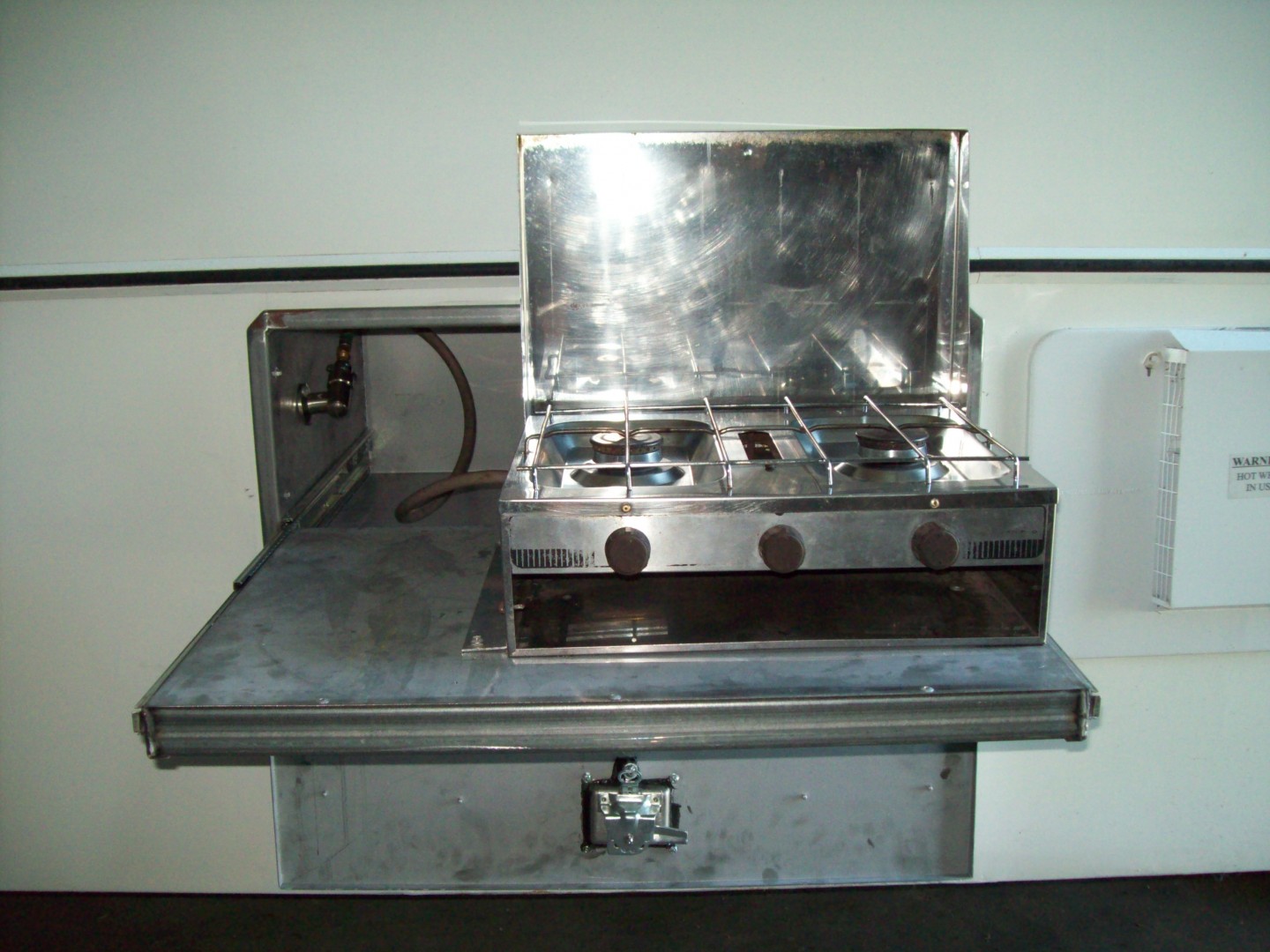

Not a Baby Q but still a BBQ as well as a stove..lol..
Look closely on the left of the box and you will see where I have put the bayonet..
I can't give you any idea of cost as I am a retired LP Gas fitter and had all the stuff to do the job on hand.. it took about 30 mins when I had the box out as there is a gas line under it going to the HWS
