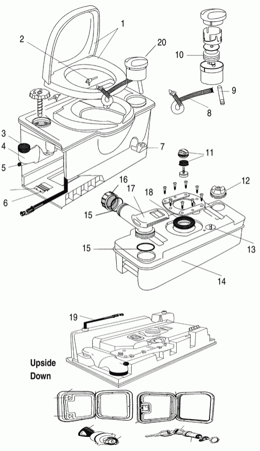

hi al need a bit of advice please how to remove the vent seal and replace ,it is the one on top of the tank , has a visible spring and have found replacement seal but not sure how it locks in to place , it turns maybe 1/4 turn but not too adventerous to pull or prise till i ask

Grae & De, just below you on the same forum page that you used is a thread titled "How to Use A Thetford Toilet". Scroll down to about reply 6 or 7 and there is a link to a chap who describes how to car for and maintain Thetford Toilets. Really useful info to the point the seal may not need replacing, just servicing. Hope this helps.

I have had our C200 vent out numerous times when cleaning and they can be tight but require approx 1/4 turn anti-clockwise and also a firm pulling up or slight levering as the "O" Ring seal can be fairly tight if not removed for a while. I also lubricate the "O"Ring seal with Olive Oil on reassembly. The Swivel Outlet is also removed the same way(albeit more like a 1/2 turn anti-clockwise) as it has similar locking tabs like the vent with a larger "O"Ring seal.
