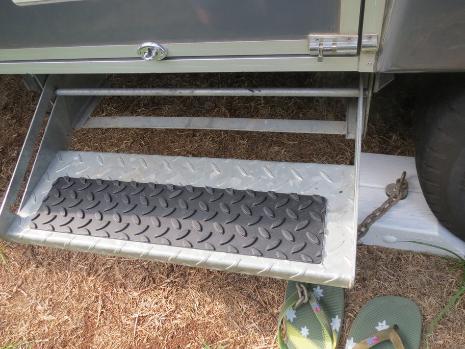

Was just down at SuperCheap and bought a adhesive backed non-slip ribbed rubber pad for the step on our Avan - never seen these before and for under $5 it should help avoid a slip or two on the steel surface.
They seem to be fairly decent quality and I'll clean the step first with petrol.

After you clean the step up with petrol give it a really good scrub with diluted dish washing liquid and then rinse it off and dry it before applying the step protector, petrol will leave a residue that will affect the adhesive.. Then if you spray the step with window cleaner before applying the protector you will be able to reposition it if it isn't where you want it..and as the spray dries the adhesive will stick..

Thanks Bob, I just used petrol....didn't think of a residue but I guess you're right. It stuck "instantly".
Re the window cleaner - never heard of that one but it sounds pretty good too. What type of window cleaner would you use - Windex etc which is water based or one of the dearer ones that are solvent based?

Just a soap based on mate, even a bit of dishwashing liquid and water in a spray bottle is good enough it stops the item from sticking untill you have it properly positioned we use it to put the tinting onto windows so we can roll out the wrinkles before it sticks..lol

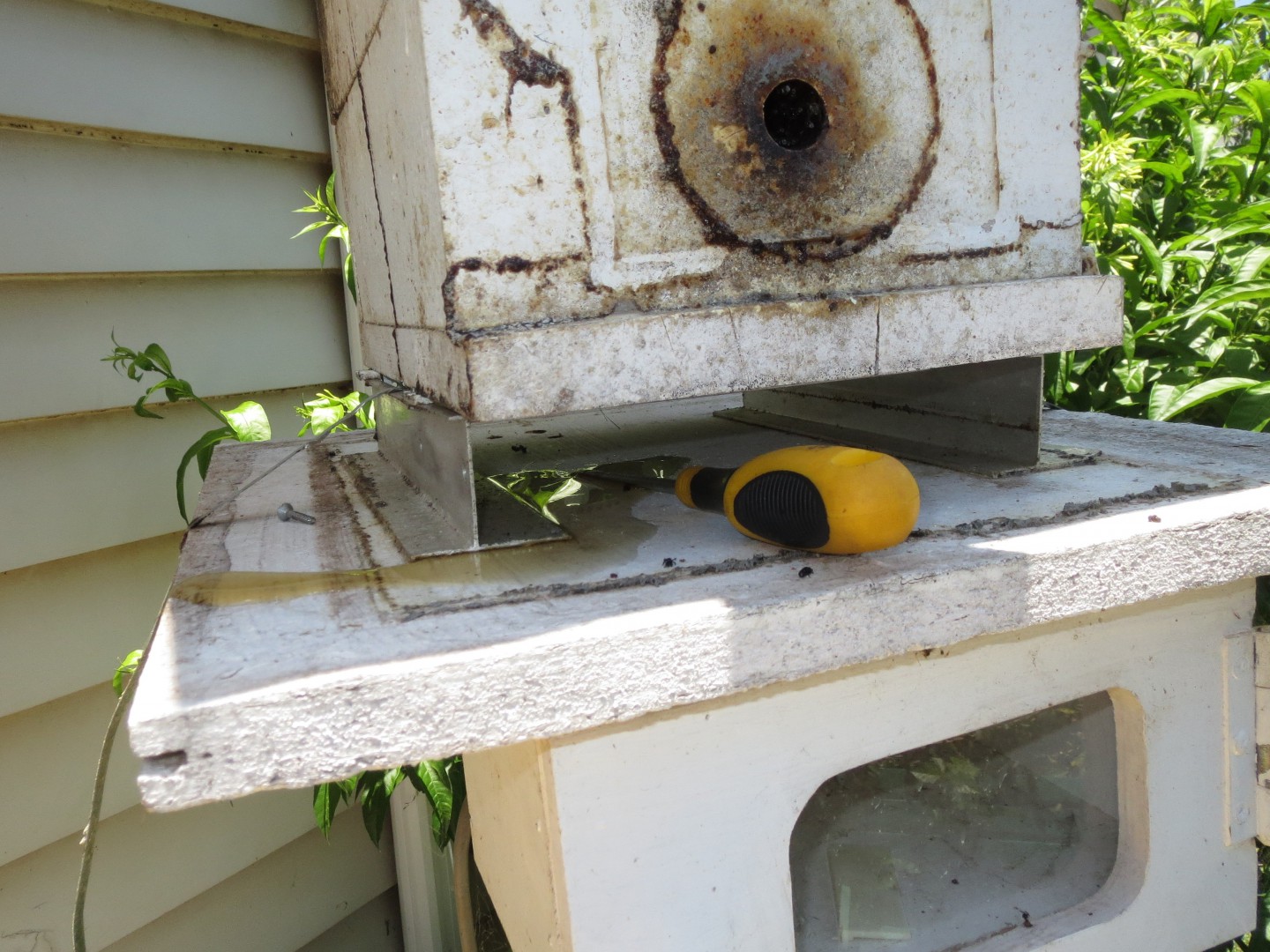

Mines been in the full sun with outside temp 39C and rubber tread temp very very hot.....I find I can peel edges up with little effort which indicates to me that maybe oldbobus may have been correct in saying petrol will leave residue OR it's so damn hot nothing will stick. It's not going to slide off or anything dramatic, but I think I'll peel it off at a later date and re-stick with contact cement just to make sure, after all it's a pretty major investment @ $4.58. In cooler climes probably be OK. It's so hot here that one of my native bee hives has slumped - collapsed internally when the wax melts and the honey pots run away....lost about a cup of honey and the bees are very worried. I've since draped it in wet towels which should bring the temps down. Never happened before so it must be hot!
