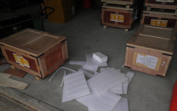

SnowT said
05:44 PM Dec 28, 2013
This is what $4200 Look's Like..
A 24v 300Ah Battery Pack Pre-packing to be sent off..
Yes I'm going the Lithium Route from the get go, as it seems to be the best way to get everything I want/need in My Build..
Juergen
