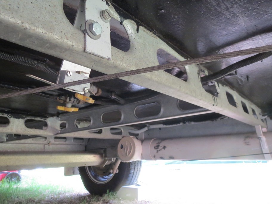

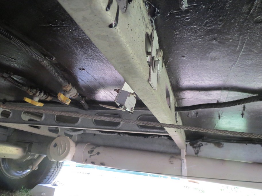

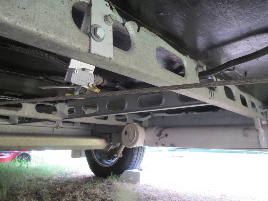

A quite simple caravan theft deterrent is to fit an alarm operated by the handbrake.
First you have a hidden switch...could be anywhere outside the van. This switch is connected to the house battery, and a wire connects to a micro switch bolted to a chassis member that lies directly above the handbrake cable. This micro switch is turned on when handbrake is off, and on when handbrake is applied and cable is tight. The power then goes to a siren/horn hidden up under the watertank or somewhere hard to get to.
How it works:
Arrive at spot, select spot and park, handbrake is applied and hidden switch turned ON. Unhitch, level van etc. Anyone who wants to steal your van MUST release the handbrake which will release handbrake cable tension and activate the siren/horn.
When you are ready to leave you simply flick the switch OFF. If you forget it will only take a second to remember...maybe a bit more to change your underpants. That's all....quite simple and no keys/codes to remember and made from basically junk. Hide the wiring as best you can.
Attached pics are from when I started this instal - will give an idea of the micro switch etc.
Good Luck.
