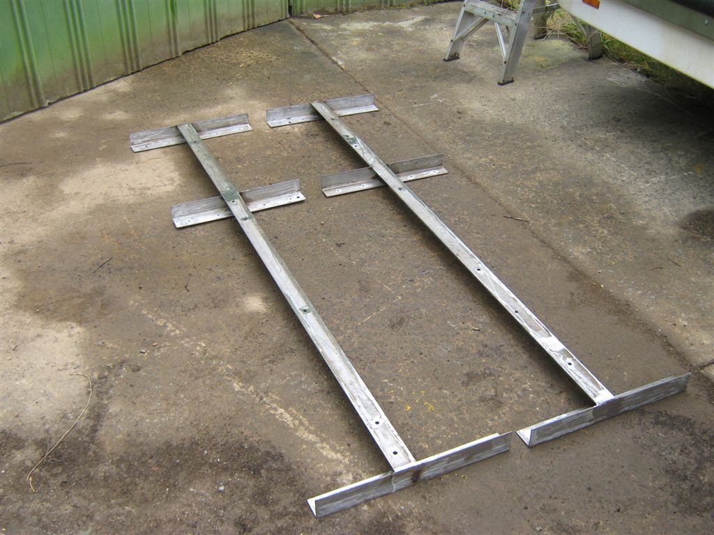

Very strange angle it is too, Its two bits of flat, seam welded by machine on the inside only, Never seen any thing like it before, I dont even know where it came from,
Doesnt matter, It didnt cost me any thing, Its 55 X 60 mm, Odd size as well,
I can put bigger panels on at a later stage, Once I figure out my land usage of power,
These panels were self sufficient on my boat, Auto pilot running 24/7 Electronics, Etc Etc,
But the Coach might be a lot different, Its a totally different Ball Game,
As I eventually want to go full Solar in my M/H, I thought I would start by using the Solar panels off my boat While they are not being used,
Its 2 X 85 Watt Panels, 1200 X 530 mm
And 2 X 50 Watt Panels, 930 X 500
270 Watts X 12 volt,
That should keep the batterys charged,

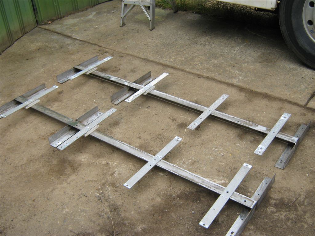

I made the frame so it takes one big and one small panel, Thats also where the Frame members in the roof are,
I even bought a brand new stud finder for the roof Frames, But I cant find the other roof member even by tapping, So it stays out,
Not sure where or how I will run the wires down yet, I will get it up there and installed first,
I hope the extra holes in it dont whistle, If they do, I will plug them with silicone,
Raining here, so its slowing things down a bit,
That sort of Look's like some SS there..
If so I like it....
Juergen
3 mm Stainless Steel angle,
