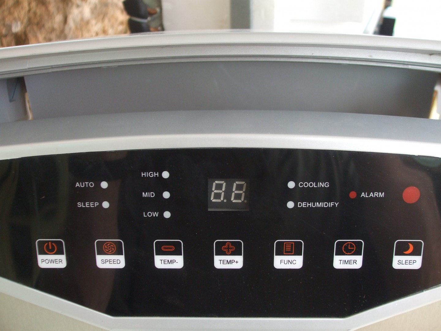

Hi guys , yep I have a Digilex portable aircon , both heat and cool and works great , not sure of the Db rating but its reasonably quiet .
I used it quite a bit in winter when I was renoing the camper and worked a treat . Size is about 320mm wide x 350mm deep x 800 high , bought it almost brand new off Ebay for $130.
All I did on the waste air was to make a small insert to fit in the sliding window with the outlet in it.

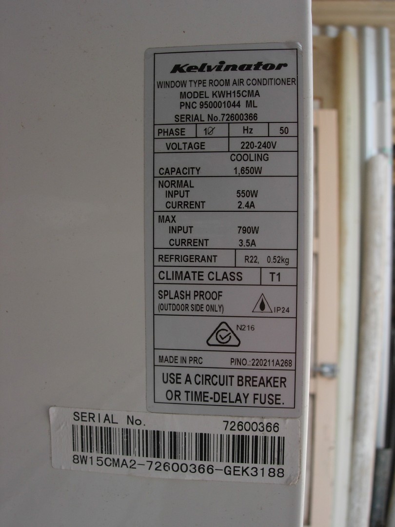

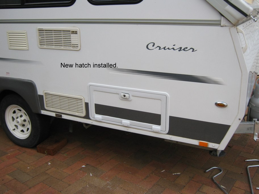

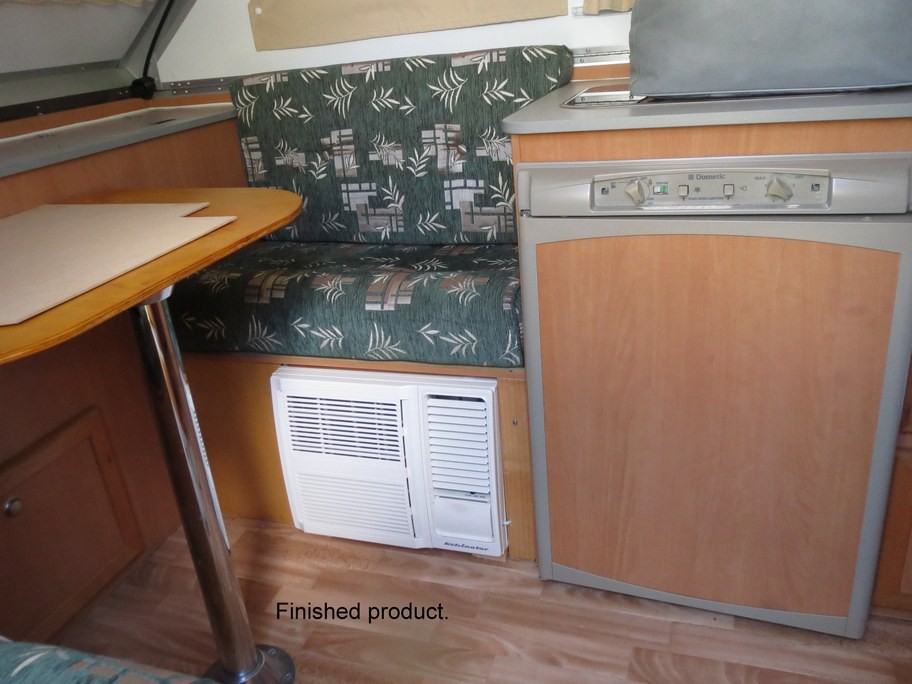

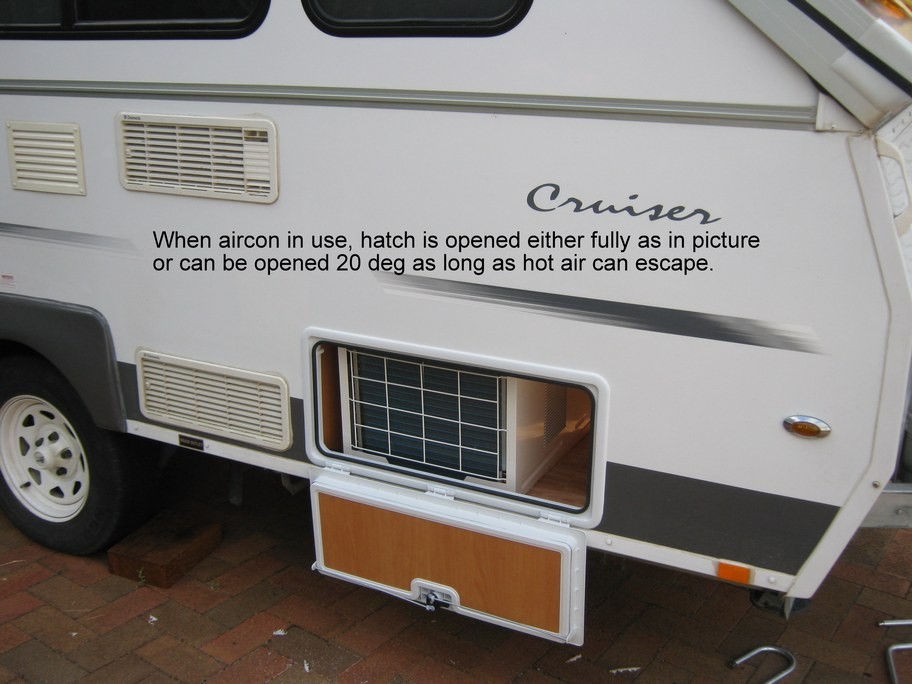

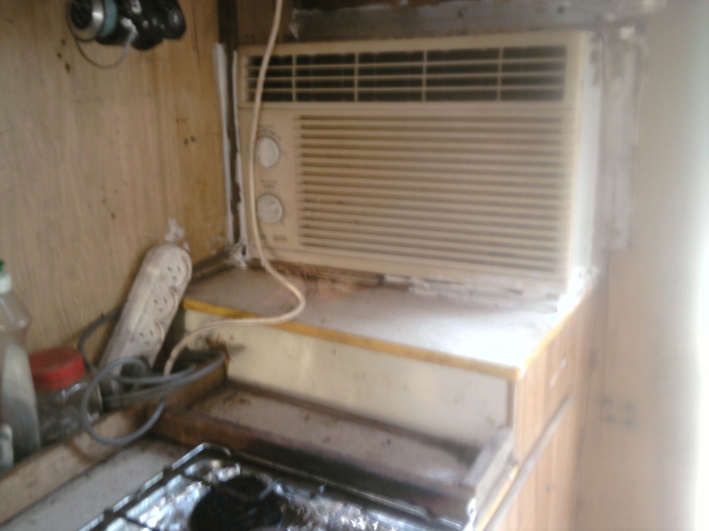

You could always instal a household wall A/C under the seats - I've done this is our Avan Cruiser which is 12ft inside. Brand new with 2 year warranty they are about $350 - fit it yourself. I added a hatch to allow the hot air out which costs another $150. The aircon can easily be removed in winter to save weight. I have the fitting instructions in a PDF file which I can forward - PM me your email address if interested.
Problem I see with the portable aircons is that they must be stored somewhere when travelling and then setup each time they are used. Not sure how much noise they make.

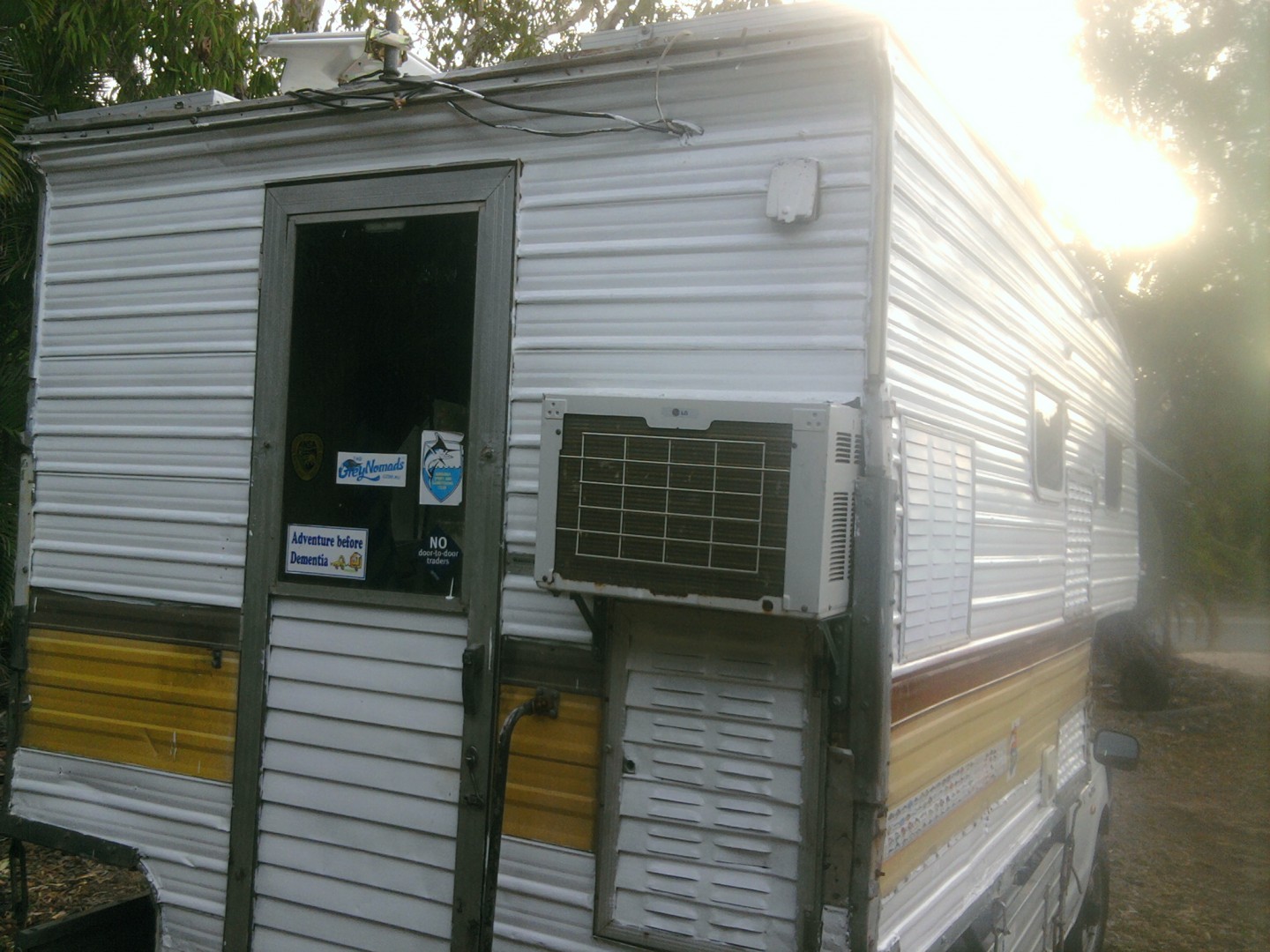

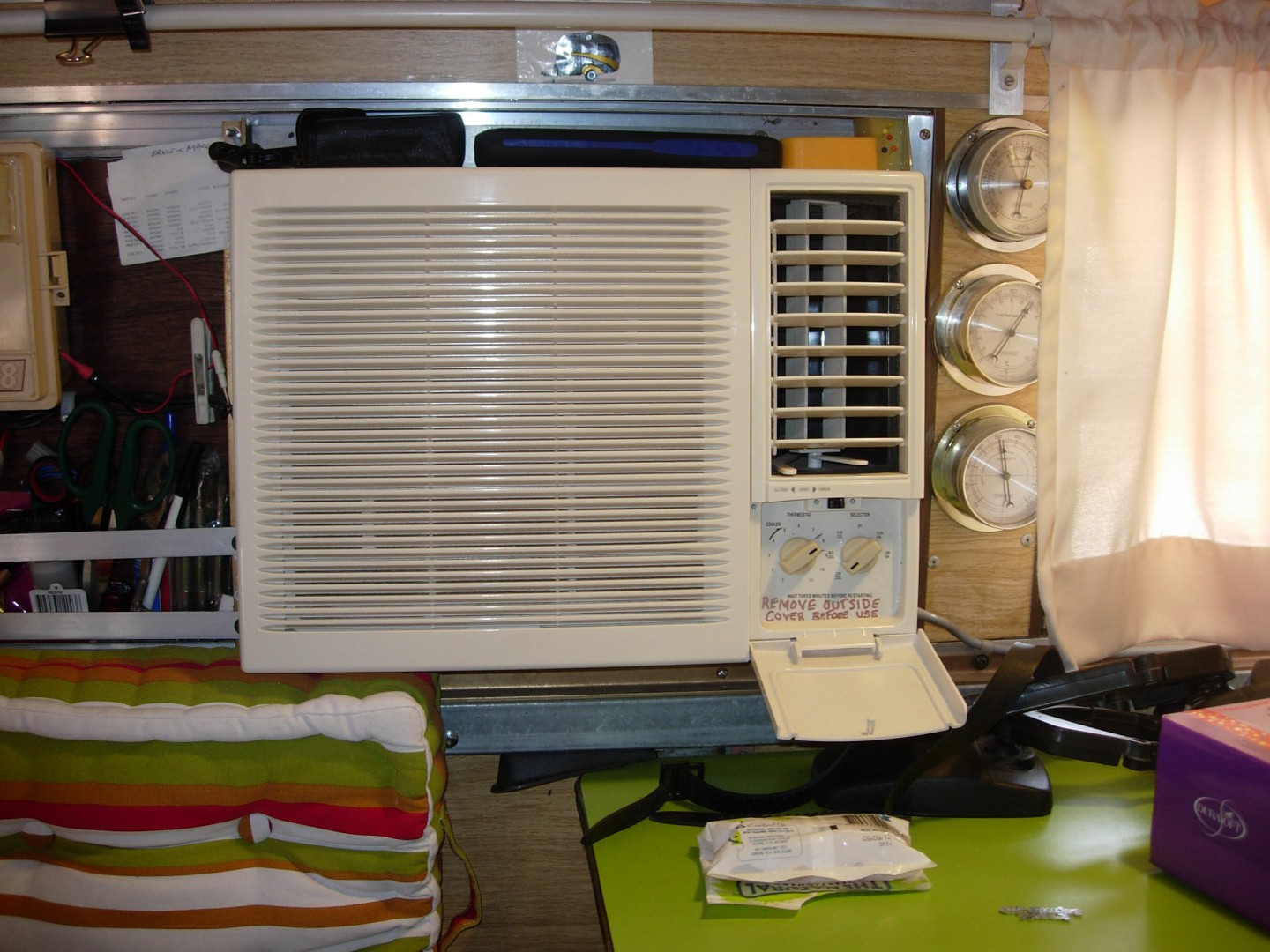

I went another way. I had a spare small box aircon , and fitted it to the back of myslide on. Its about 7000btu, and if anything, gets too cold!I ran it off the genny and it went down to 18.5c,which is cold for up here in NQ.I think I paid $50 for the little aircon.You certainly need it at times up here .Bill

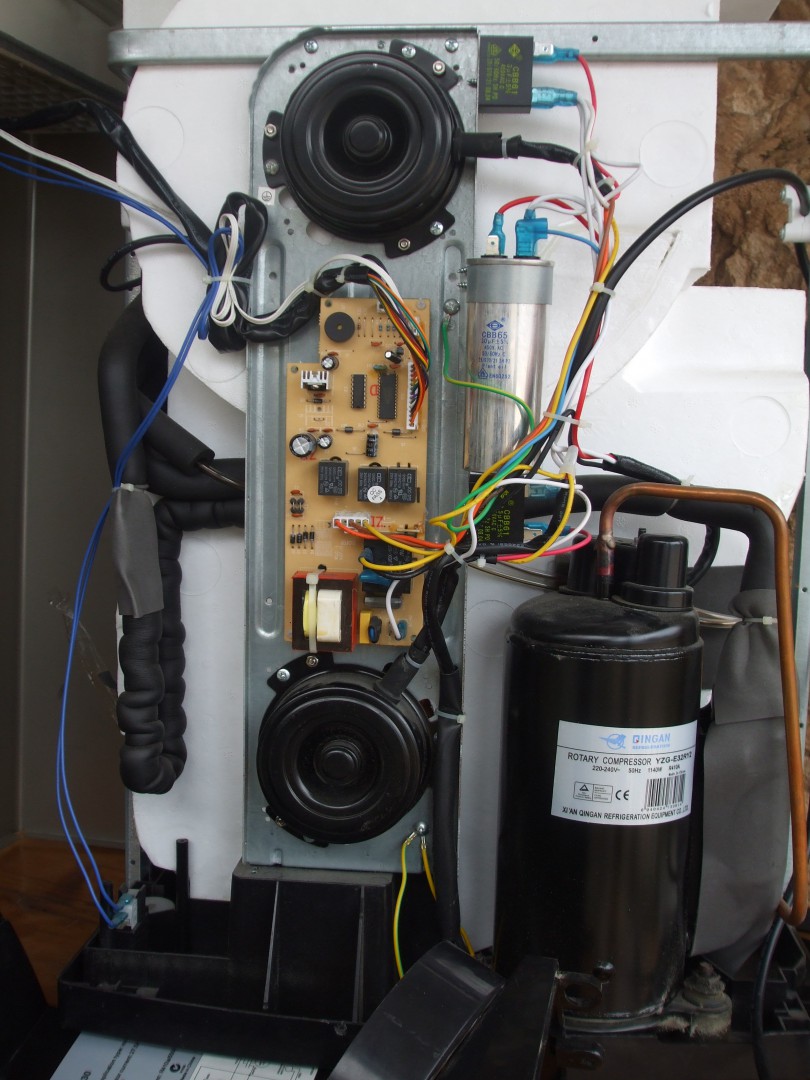

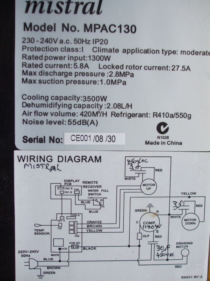

This is a Mistral port A/C I repaired recently. They are not that efficient as they are pinching your cold air with the bottom fan & pushing it through the condencer & out the vent pipe to the outside. This also means it is dragging in hot air from out side for the unit to re cool. I certainly wouldn't use one.

The little second hand Sanyo on the back of my slide on is 310mmx 470mm.Bill

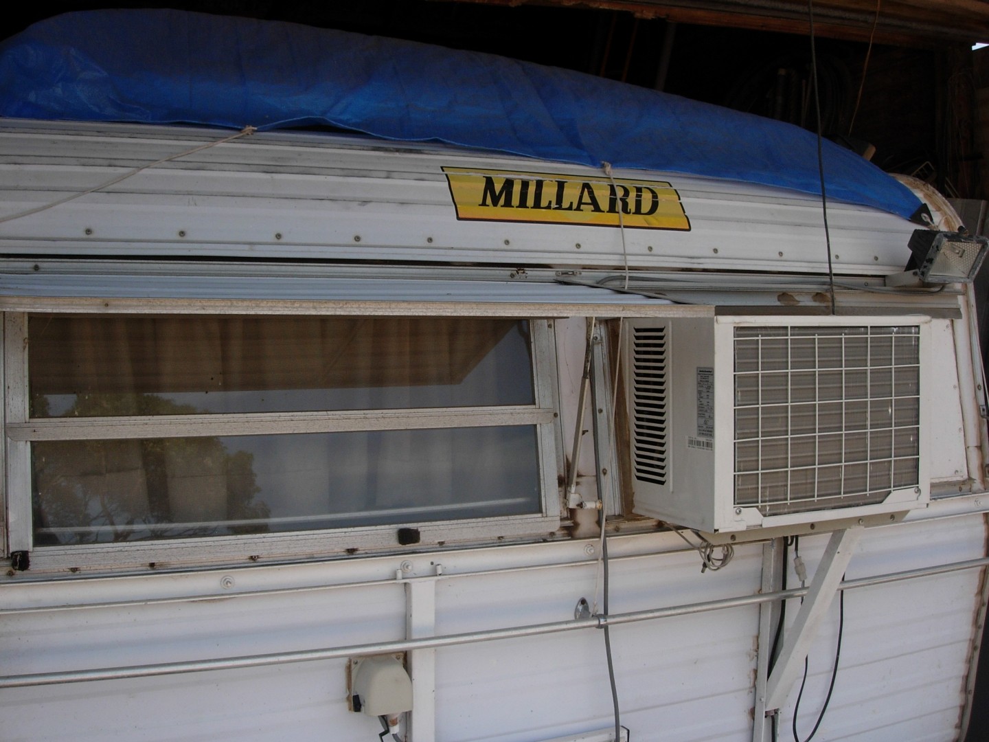

This is what I use in a Millard pop top van & if the outside is over 40C it will keep the inside at 22C easy as it cycles at those temps.
